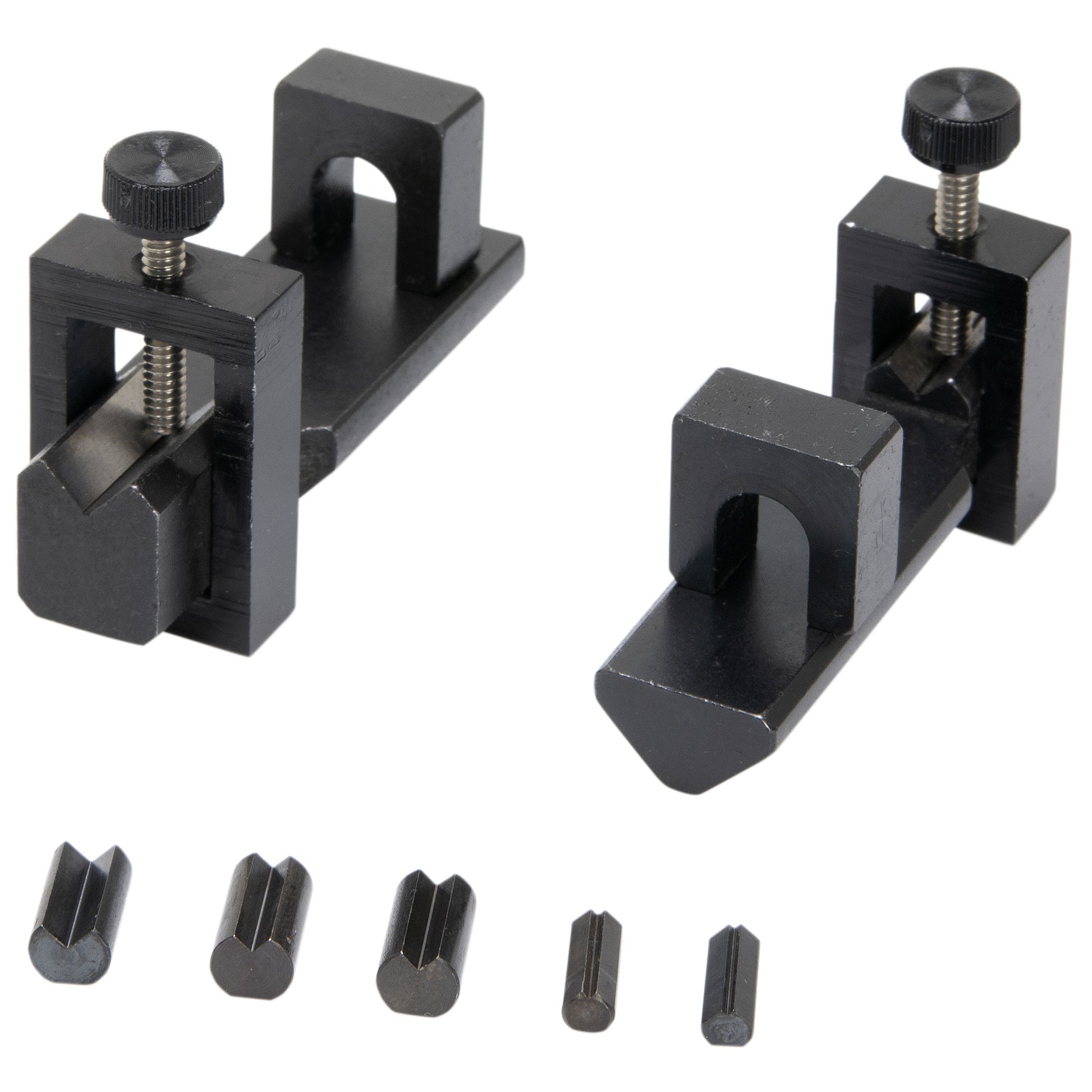

- Hold miniature round parts in these small V-blocks
- Bridges straddle long workpieces allowing use of hold-down screw of containing V-block
- Hardened and precision ground
- Square and parallel to 0.0002"
- Includes fitted case

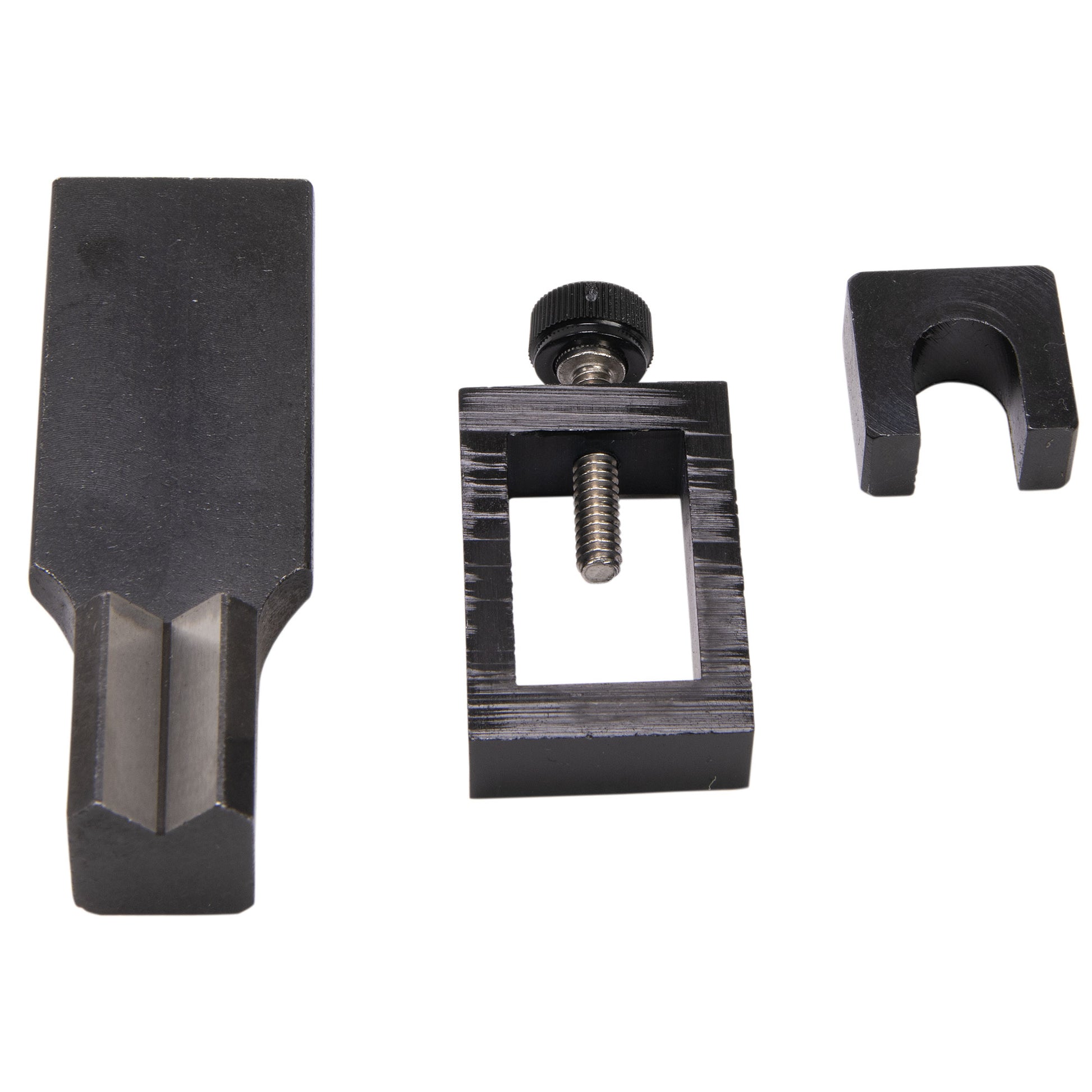

These mini V-blocks, designed to be held in larger V-blocks, provide a unique and universal way to hold small and intricate parts. Ideal holding fixture for grinding/indexing punches and pins, drilling, milling EDM, inspection on optical comparators. Furnished with bridges to straddle long workpieces, allowing top hold-down screw of V-block clamp to be utilized.
Case includes:
- 2 Super Wee Blocks Size A: 0.030" to 0.15" Size B: 0.05" to 0.28" capacity
- Bridge A and B which allows longer pieces to pass through back

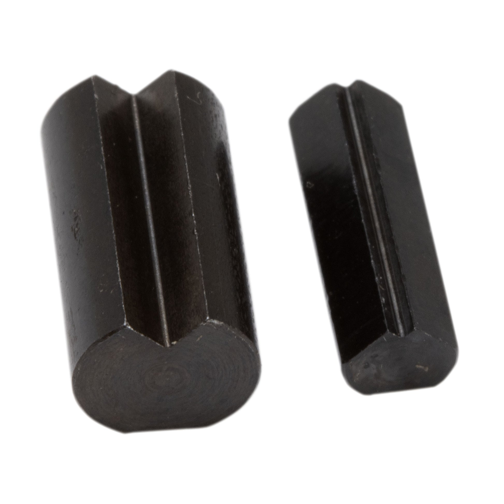

- 5 upper prisms: 1/8", 5/32" and 3/16" capacity.
Hardened and high precision ground Wee Blocks, squareness and parallelism within .0002". MADE in U.S.A.
