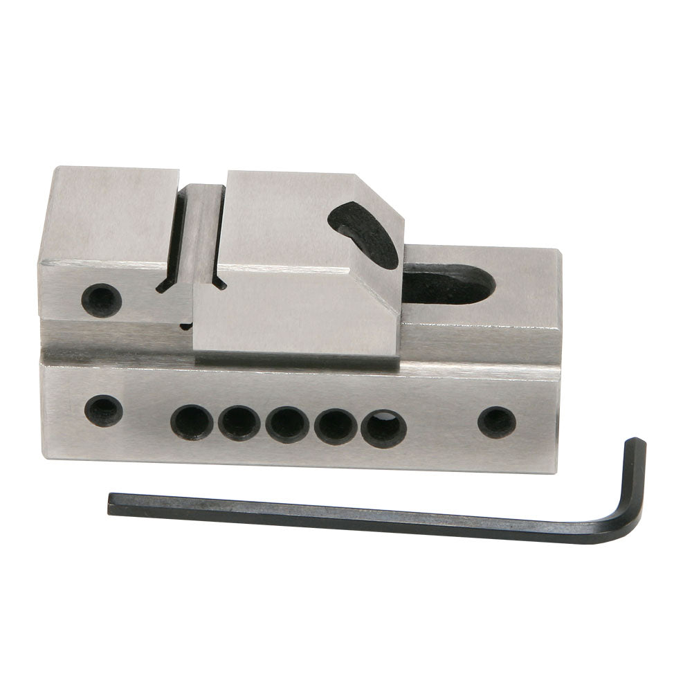

  • Notches in jaws provide built-in parallels
  • Jaw opening capacity is 1"
  • Hardened to RC 58-62
This high precision toolmakers screwless vise has a one-piece body. The body and jaws are hardened to Rc 58-62. All sides are flat, square, and parallel to 0.0002".

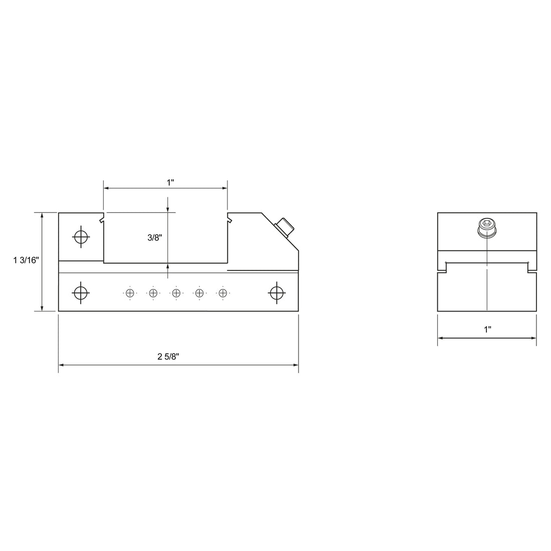

The jaws are 3/8" deep and open to 1".
The vise is 2-5/8" long, 1" wide, and 1 3/16" high.
Built in parallels are 2.75mm (0.11in) below top of jaws.
You can use your clamping kit to secure this vise using the slots in the ends, but we recommend that you make a couple of clamping blocks to secure the vise across the table. You can also purchase pre-made clamps here: Screwless Vise Clamps.

Jaw Depth: 0.375" (9.525 mm)
Maximum Jaw Opening: 1" (25.400 mm)
Weight: 0.51 lbs (0 kg)
Length: 2.625" (66.675 mm)
