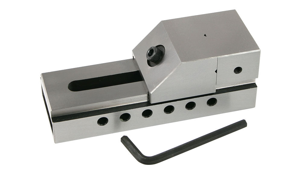

  • Precision ground and hardened
  • Rapid positioning notches
  • Ground v-way in sliding jaw
  • Overall length is 5.32"
This high precision toolmakers screwless vise has a one-piece body. The body and jaws are hardened to Rc 58-62. All sides are flat, square, and parallel to 0.0005". There are horizontal and vertical vees on the inside face of the movable jaw to hold round objects.
The jaws are 25 mm (0.98") deep and open to 61 mm (2.39").
The vise is 135 mm (5.32") long x 50 mm (1.97") wide x 50 mm (1.97") high.
You can use your clamping kit to secure this vise using the slots in the ends, but we recommend that you make a couple of clamping blocks to secure the vise across the table.

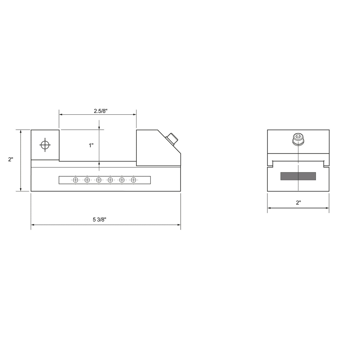

Jaw Depth: 0.984" (25 mm)
Maximum Jaw Opening: 2.402" (61 mm)
Weight: 3.6 lbs (2 kg)
Height with Out Base: 1.969" (50 mm)
Length: 5.315" (135 mm)
Width with Out Base: 1.969" (50 mm)
