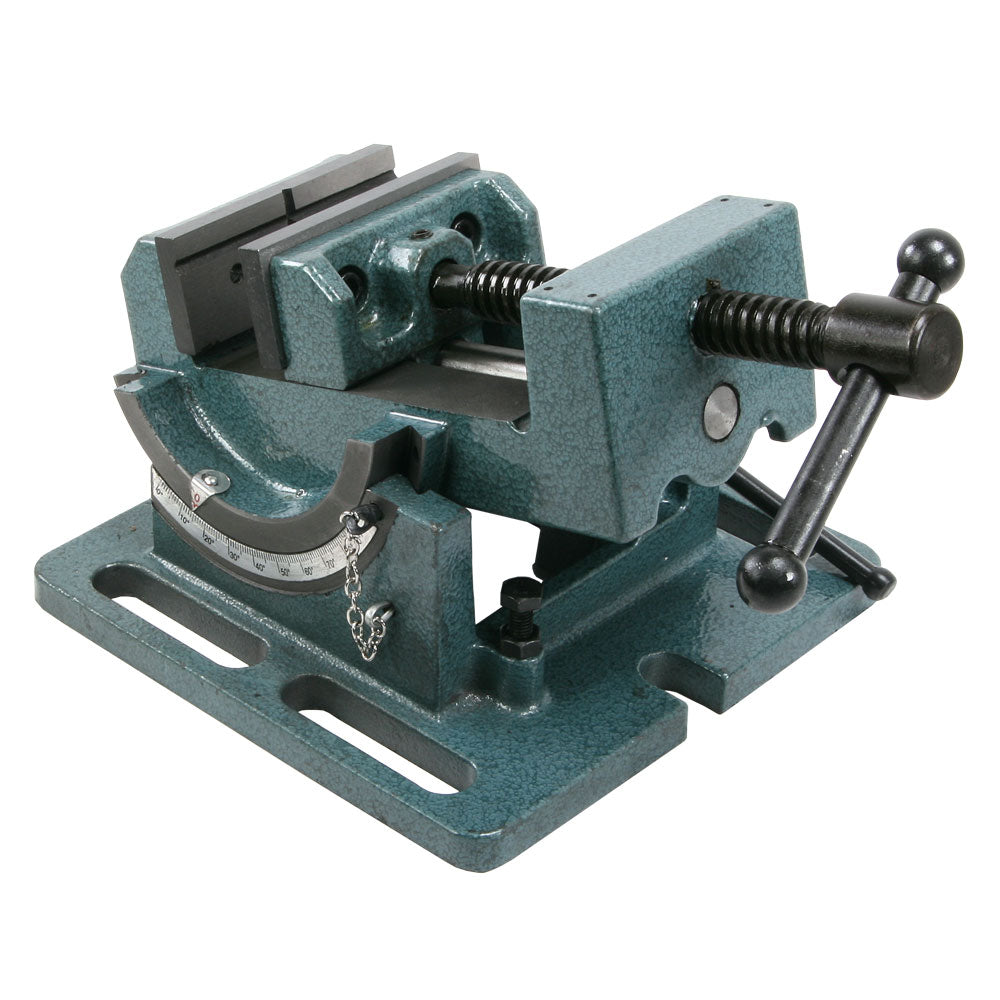

  • Full 90° horizontal to vertical adjustment
  • Multiple bolt slots in base for easy mounting
  • Angle dial on one side and locking knob on opposite side
  • Made from strong cast iron
  • Has a rail for secure angle adjustments
The jaws are 3.5" wide, 1.25" deep, and open to 3.25" capacity.
The front and rear slots are 0.5" wide. The corner slots are 0.4" wide.
This vise is designed for use on a drill press. It can be used for light milling, but does not accommodate standard parallels.
Jaw Width: 3.5" (88.900 mm)
Jaw Depth: 1.25" (31.750 mm)
Maximum Jaw Opening: 3.25" (82.550 mm)
Weight: 12.6 lbs (6 kg)
