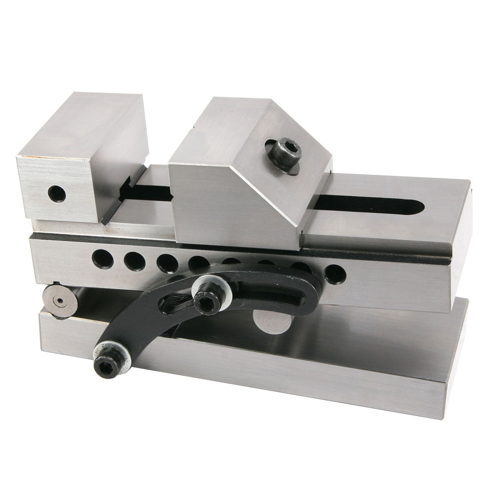

  • Sine range: 0-60°
  • Tolerance of .0004" center to center
  • Jaw can be opened or closed without unbolting from work surface
3" Precision screwless sine vise.

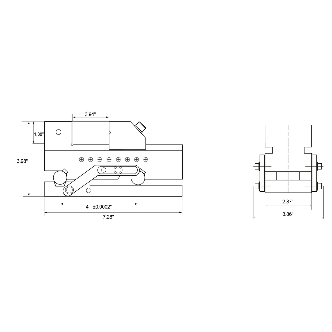

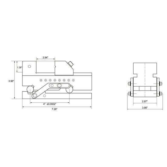

Jaw width is 2.9" (73 mm), jaw depth is 1.4" (35 mm), jaw opening is 4" (100 mm).
The base size is 7" x 2.9" (190 mm x 73 mm) The center distance of the cylinders is 100.00 mm.
Hardened and precision ground to a tolerance of .0004” for both parallelism and squareness.
Sine range: 0 - 60°.
Jaw can be opened or closed without unbolting vise from work surface.
You can set the Sine Vise to a precise angle using our Space Blocks.
The Sine Vise Height Table shows how to set the sine vise.

Jaw Width: 2.874" (73 mm)
Jaw Depth: 1.378" (35 mm)
Maximum Jaw Opening: 3.937" (100 mm)
Center Distance: 3.937" (100 mm)
Angle Range: 0° to 60°
Swivel Base: NO
Weight: 10 lbs (5 kg)
Length: 7.480" (190 mm)
Width: 3.05" (77.470 mm)
Mounting Bolt Centers: n/a
Hold-Down Mechanism: YES
