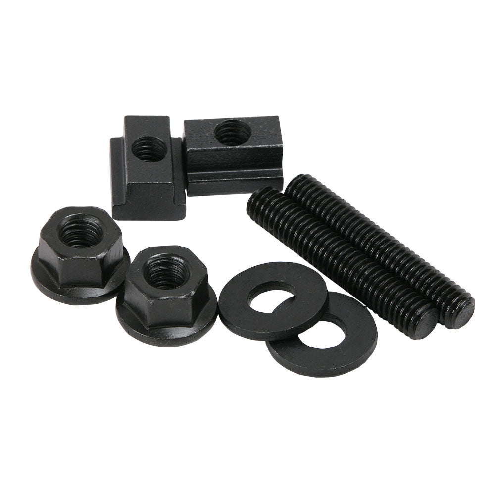

  • Contains the items needed to mount a milling vise on a mini mill

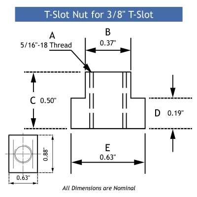

  • Fits 3/8" T-slots
  • All parts are hardened for long life
  • Includes 2 each studs, T-slot nuts, flange nuts, and hardened washers
The studs in this kit are 5/16"-18 x 2".
Note that you have to take the swivel base off the vise to use this kit.
The stated dimension of the clamping kit is the width at the top of the T-slot.
Most vises have some sort of "mounting kit" but these are often simply intended to slot them into the t-slots of a mill and not really attach them to the table. Our vise mounting kit has true t-slot nuts and hardened bolts and nuts to ensure your vise is properly secured to the table. This prevents slight movement throwing off measurements or cutting operations and is all around safer.
