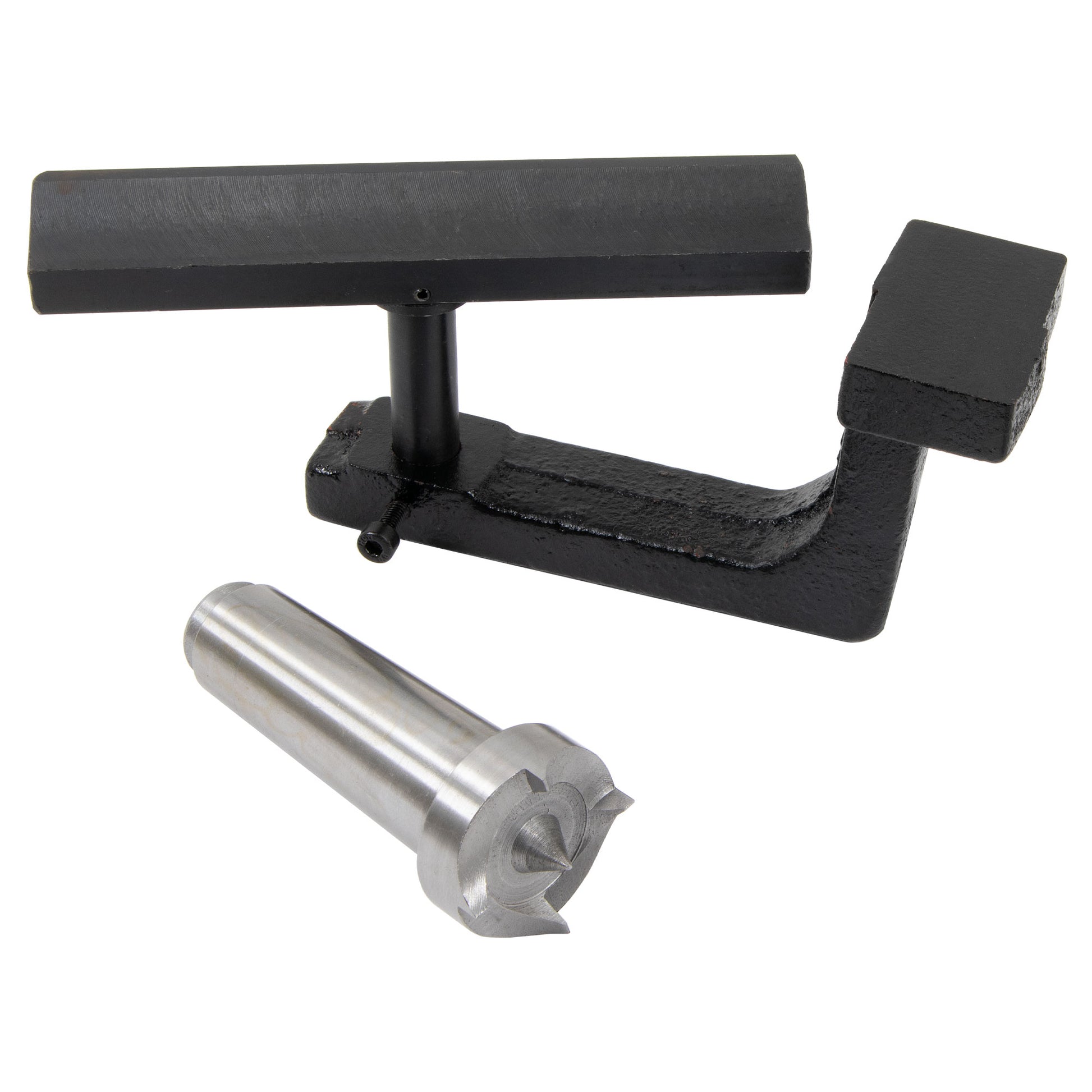

  • Turn wood on a metal lathe
  • Includes woodturning tool rest and spur center
  • Fits several SIEG mini lathes classes from C2 to SC4
  • Fit LittleMachineShop.com HiTorque mini lathes and bench lathes
  • Fits #3 Morse Taper Spindle

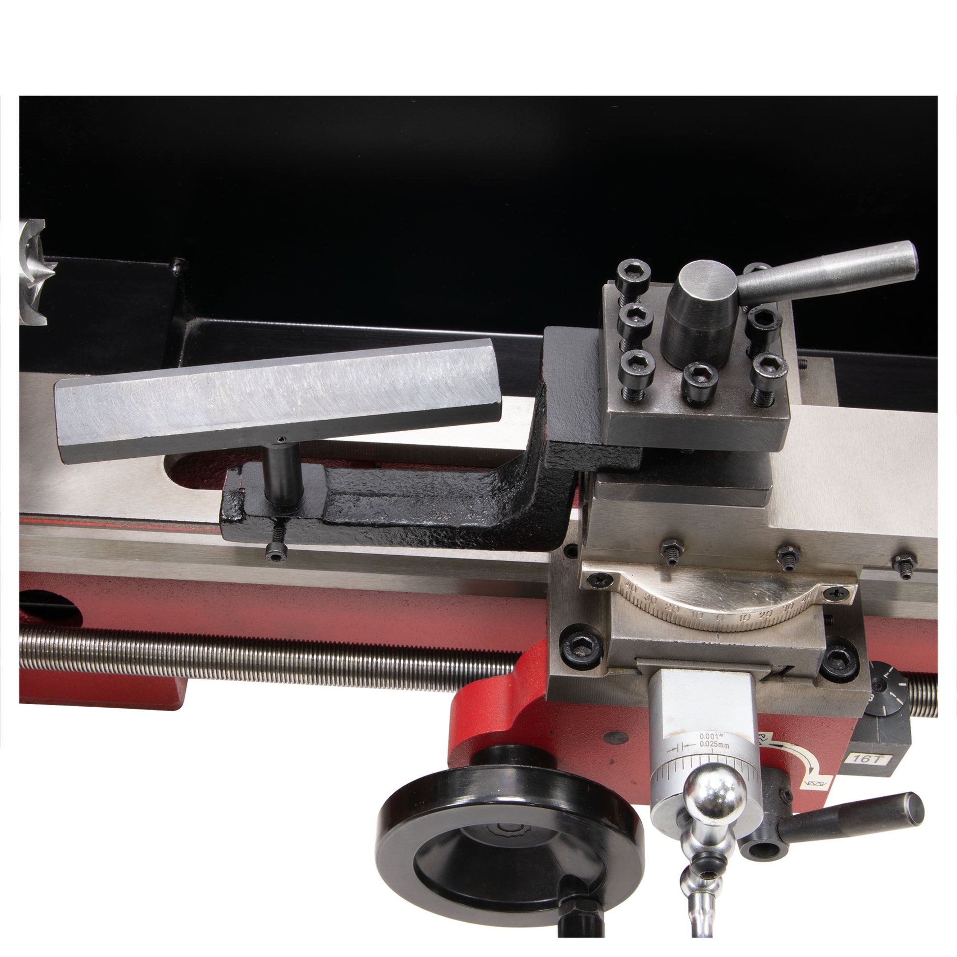

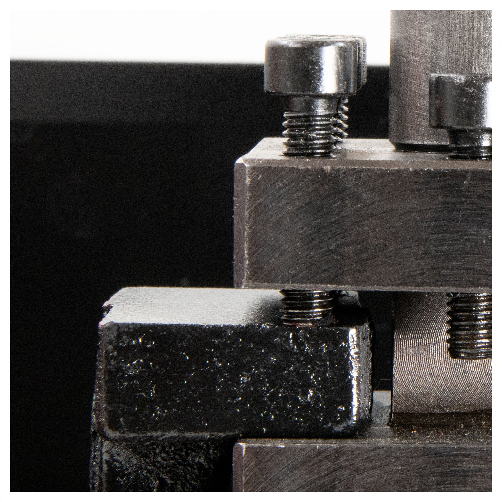

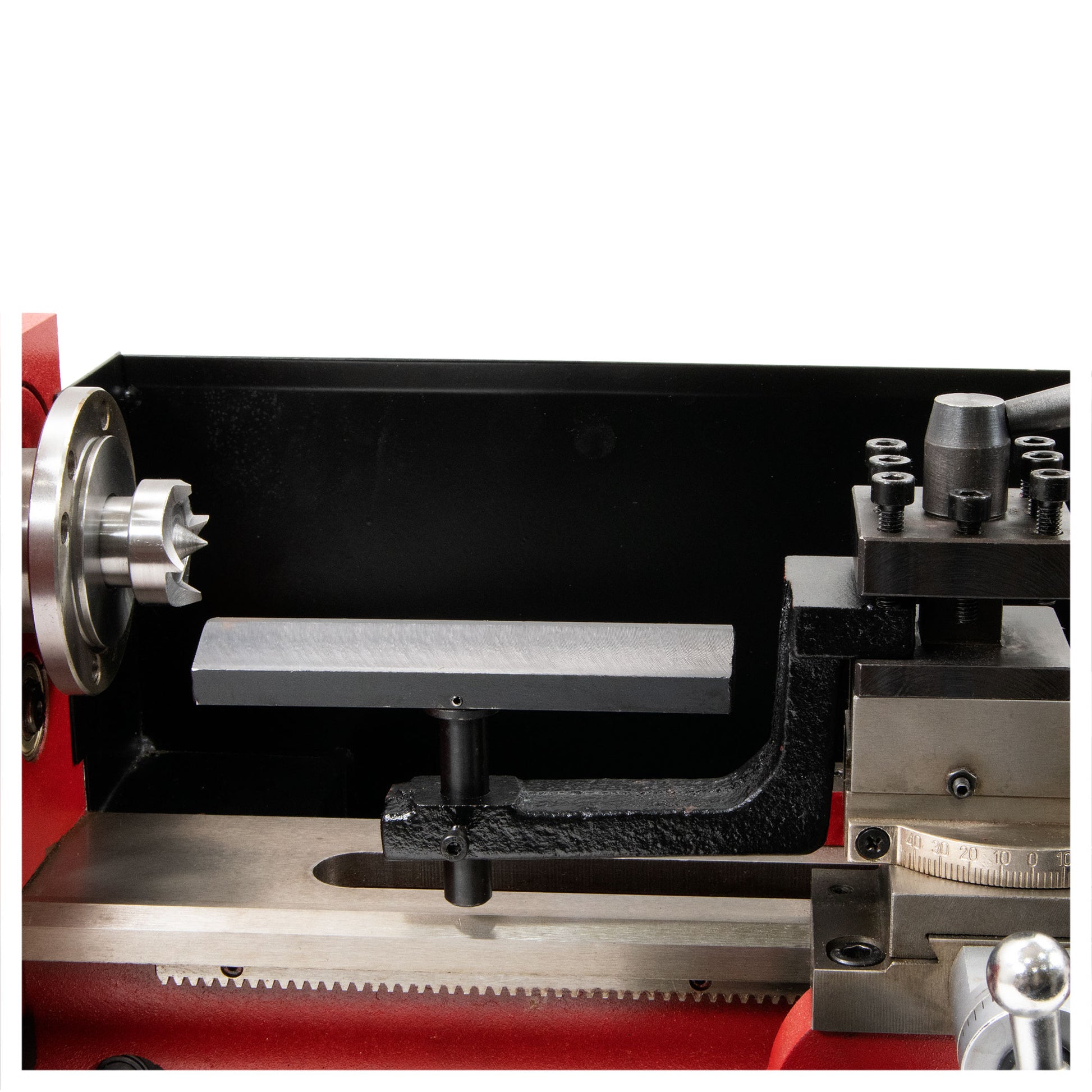

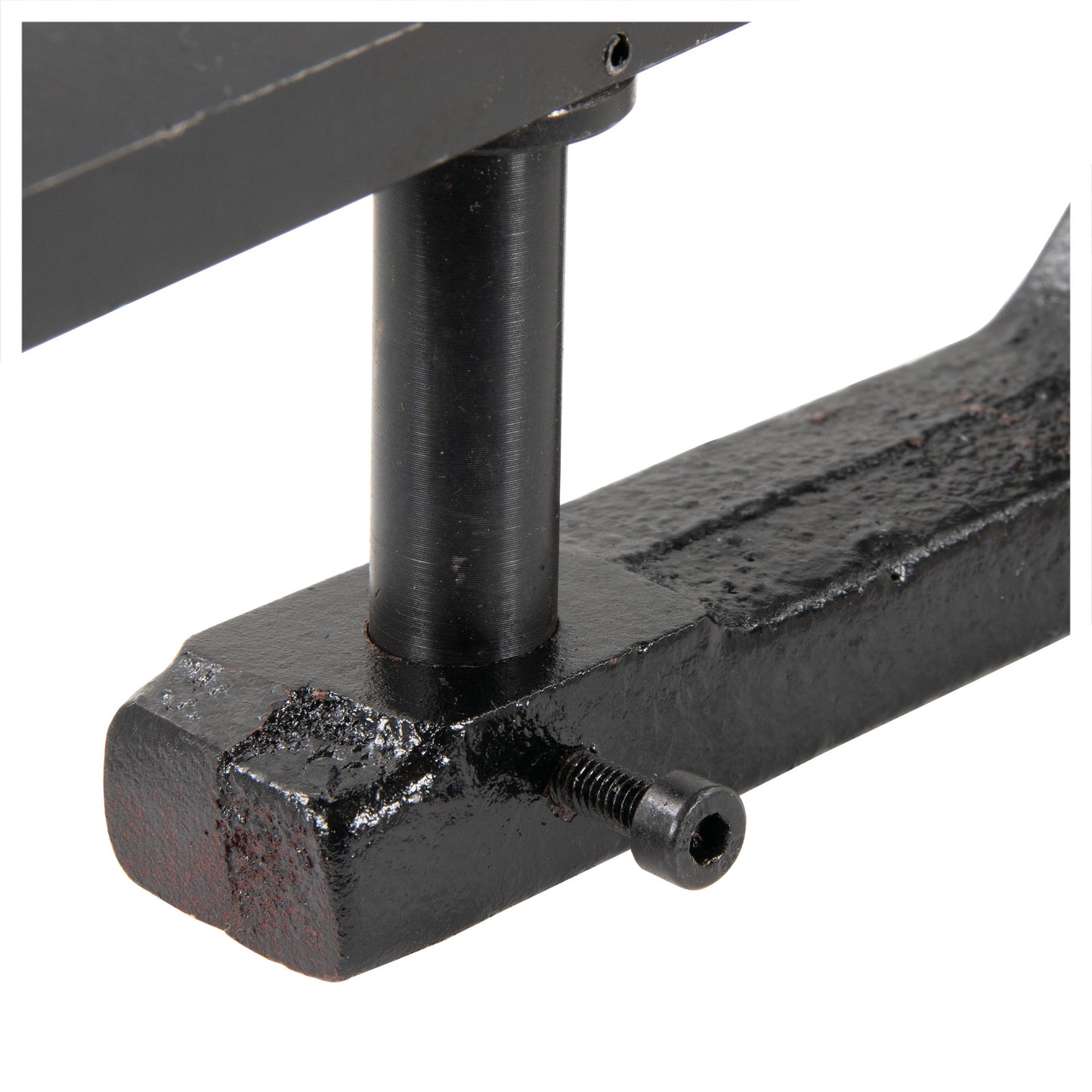

The wood turning tool rest clamps into a standard tool post so you can turn wood on your mini lathe or bench lathe. The tool rest height can be adjusted and it can rotate 360 degrees. The spur center fits in the lathe spindle with a #3 Morse taper. Mount the tool in a standard tool post by securing the shelf with the three set screws on the tool post. The spur center secures directly in the spindle with the chuck removed.
Chris's Tips
The wood turning tool rest clamps into a standard tool post. Install tool rest in tool post as shown. Tighten cap screws securely.
The spur center fits in the lathe spindle. The spindle must be a #3 Morse taper for proper fit.
Wood Turning Tool
Overall Length (Including Tool Rest): 6.75" (171.450 mm)
Length (Tool Post to Center of Rest): 3.6250" (92.075 mm)
Tool Rest Length: 5.25" (133.350 mm)
Tool Rest Height (Thickest Side): 0.6250" (15.875 mm)
Tool Rest Depth: 0.75" (19.050 mm)
Spur Center Overall Length: 3.5" (88.900 mm)
Spur Center Taper: #3 Morse Taper
