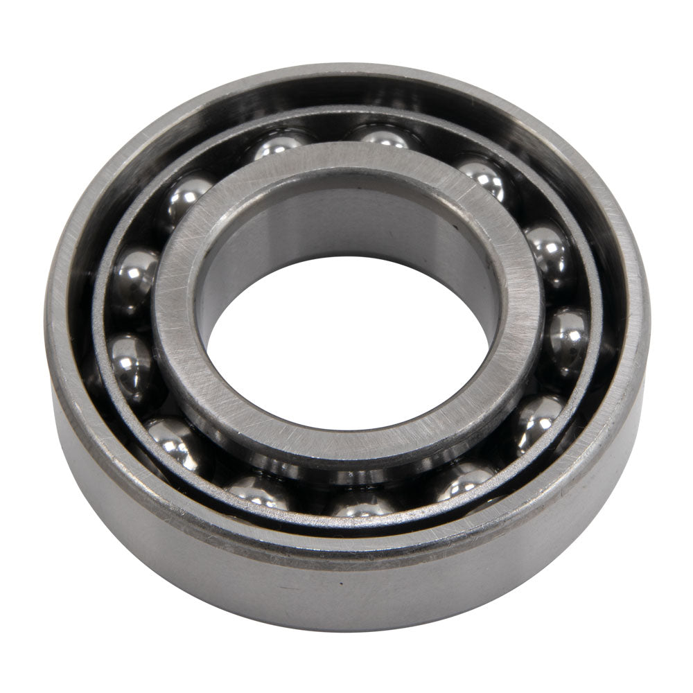

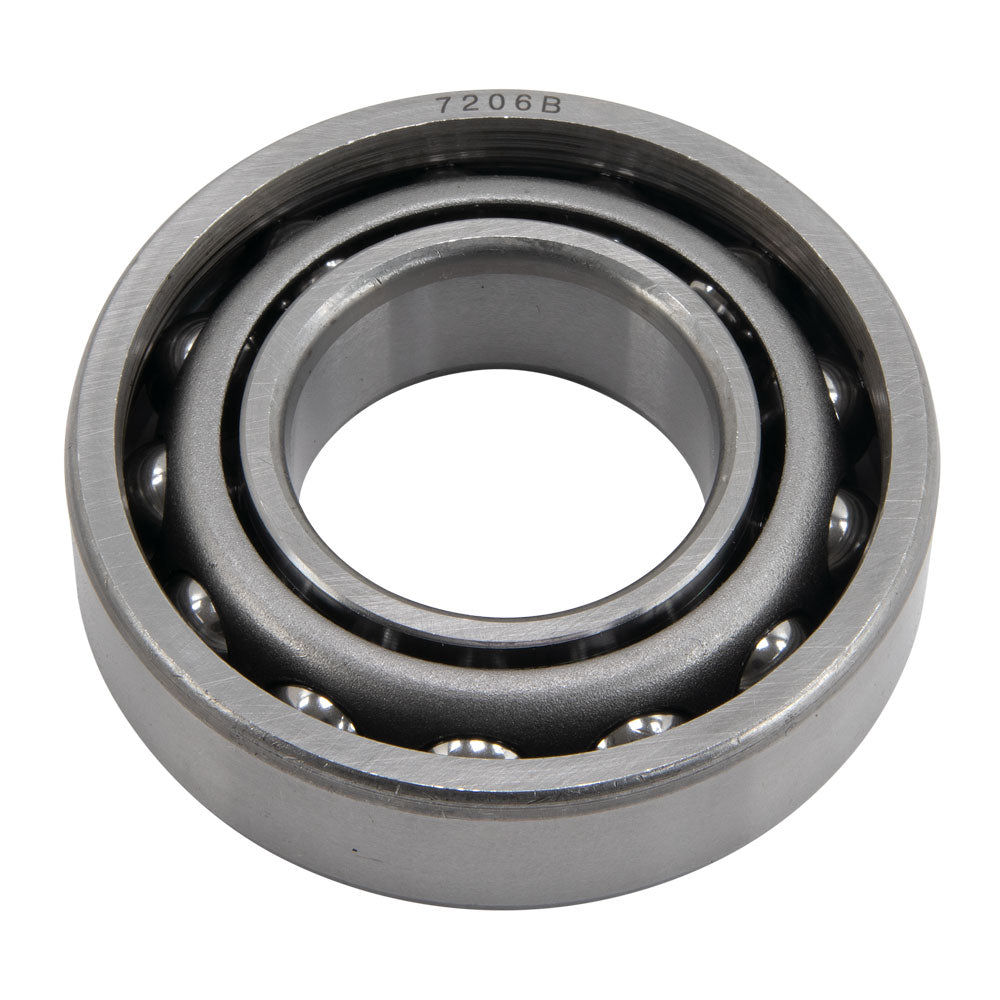

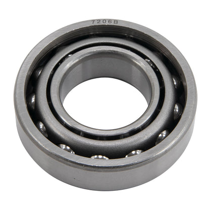

  • 7206-B-TVP angular contact bearing
  • 40 Degree angular contact
  • ID (Bore) 30 mm
  • OD 62 mm
  • Width 16 mm
7206B-TVP angular contact ball bearing.
This bearing is 30mm ID, 62mm OD, 16mm wide, and 40° Contact Angle
This is an angular ball bearing that can be used to replace the spindle bearings on the mini lathe. It requires two of these bearings to update a mini lathe spindle. These 7206-B bearings are the same size as the stock bearings so you don't have to trim any spacers.
