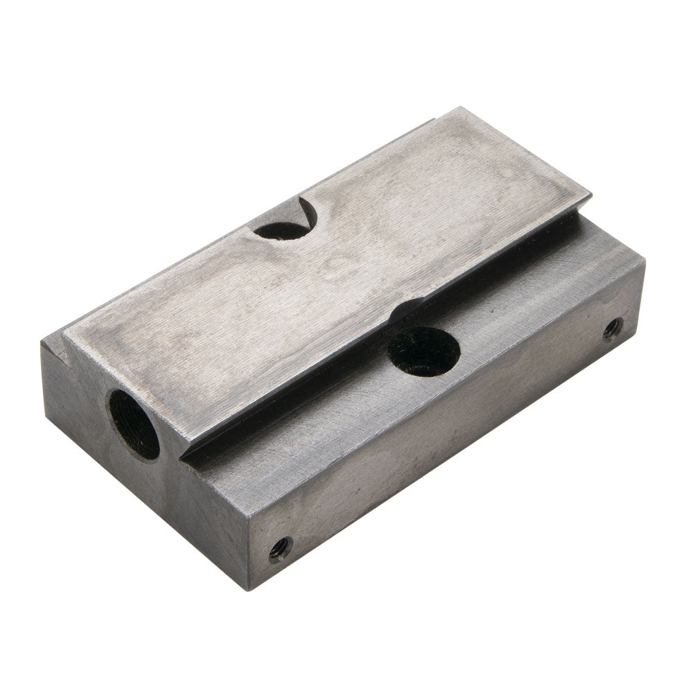

- Pre-drilled compound rest bottom, mini lathe, 20 TPI
- For 20 TPI lathes that advance 0.050" per revolution per revolution
- Use with dial having 50 divisions
- Fits Micro-Mark mini lathes
- Fits HiTorque 4200 mini lathe
This is the bottom half of the compound rest on the 20 TPI mini lathe. Fits Micro-Mark mini lathes and HiTorque 4200 mini lathe
The thread is 20 TPI so the compound advances 0.050" per revolution. Use with a dial that has 50 divisions.
J. W. Early suggests that you machine 0.25" off the bottom of this part. He also suggests that you move the tool post pivot point. This allows you to use several different adjustable tool posts more effectively.
For a compound with the pivot point already moved, see our modified compound rest bottom.
