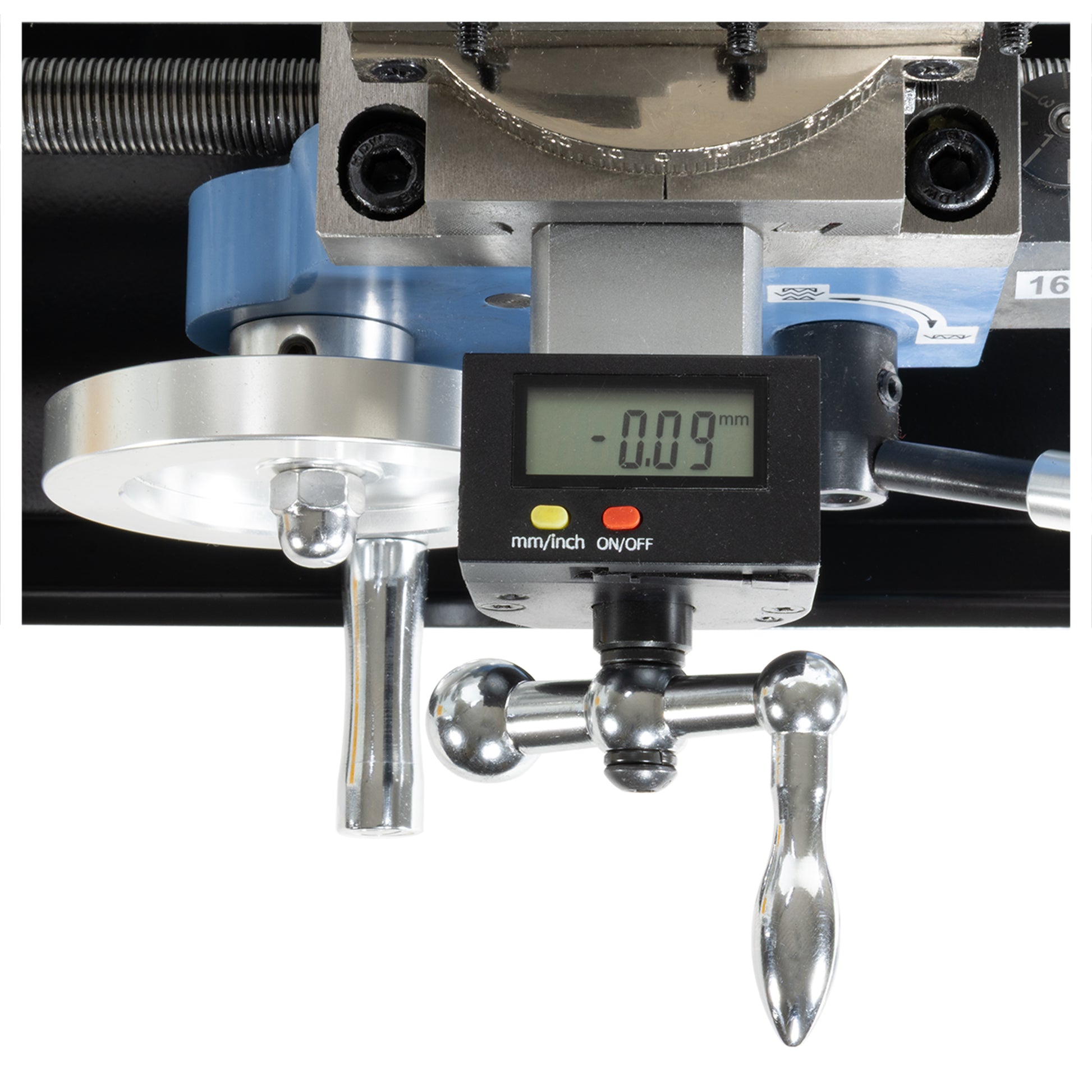

  • Includes DRO readouts on compound rest, cross slide, and tailstock

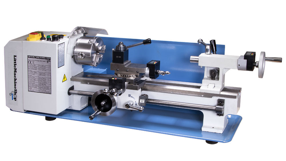

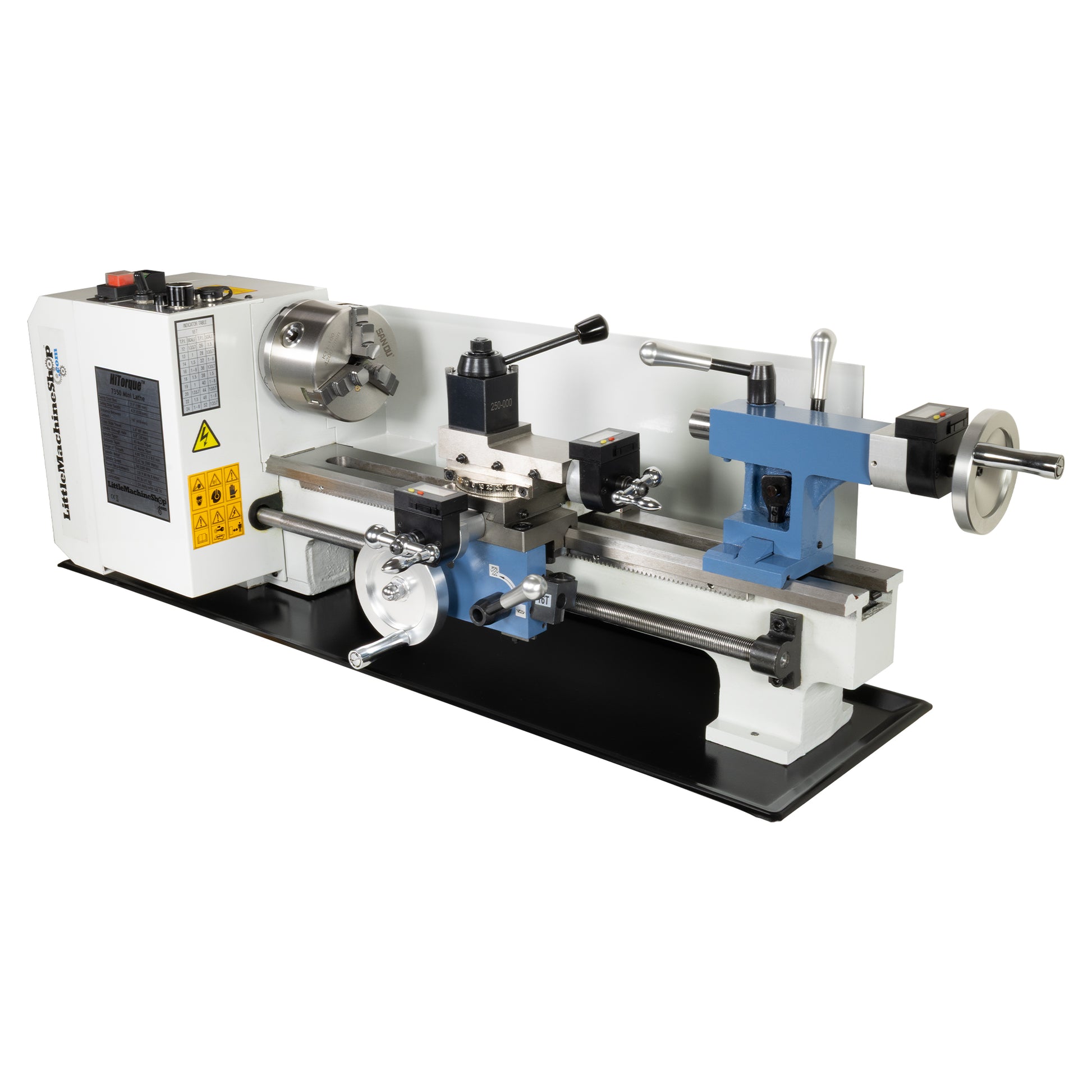

The LittleMachineShop.com HiTorque 7x16 Mini Lathe is the best in its class. It has the most power, most torque, and a longer center distance than other lathes in its class.
This DELUXE Lathe has the following upgraded features:

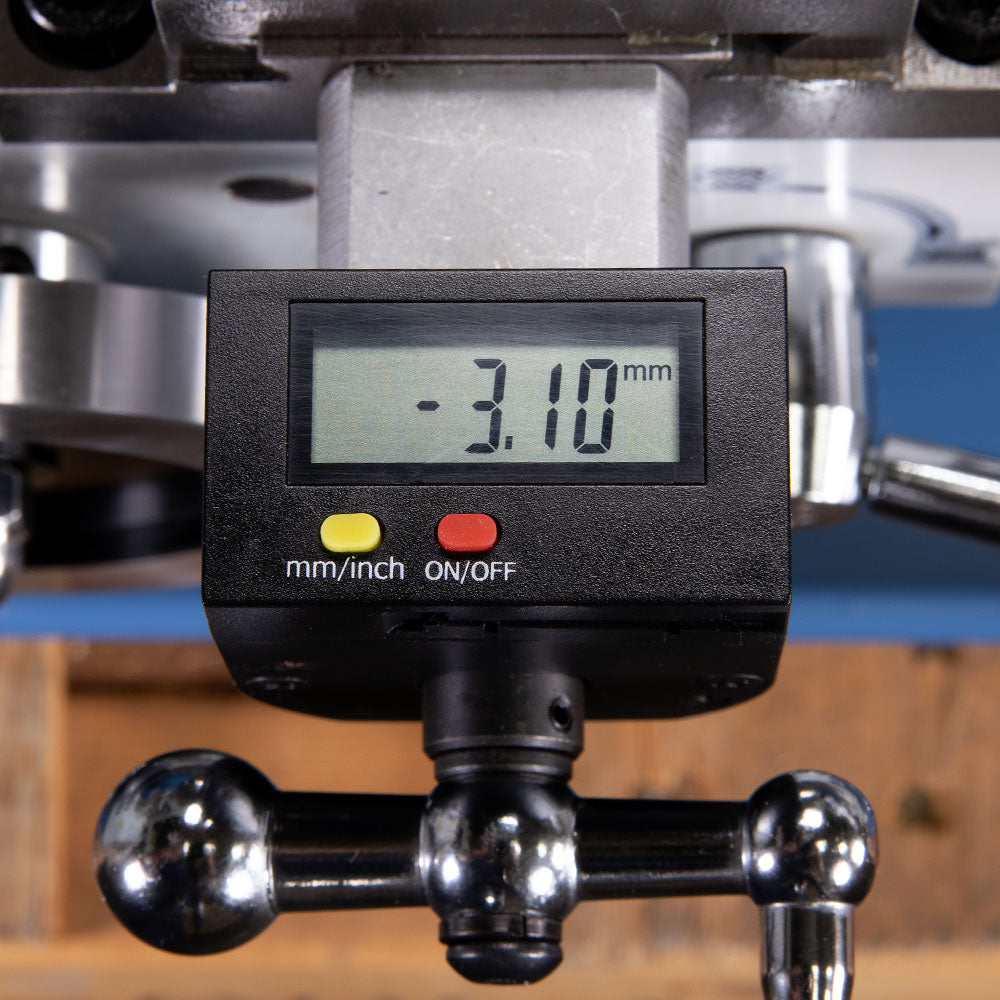

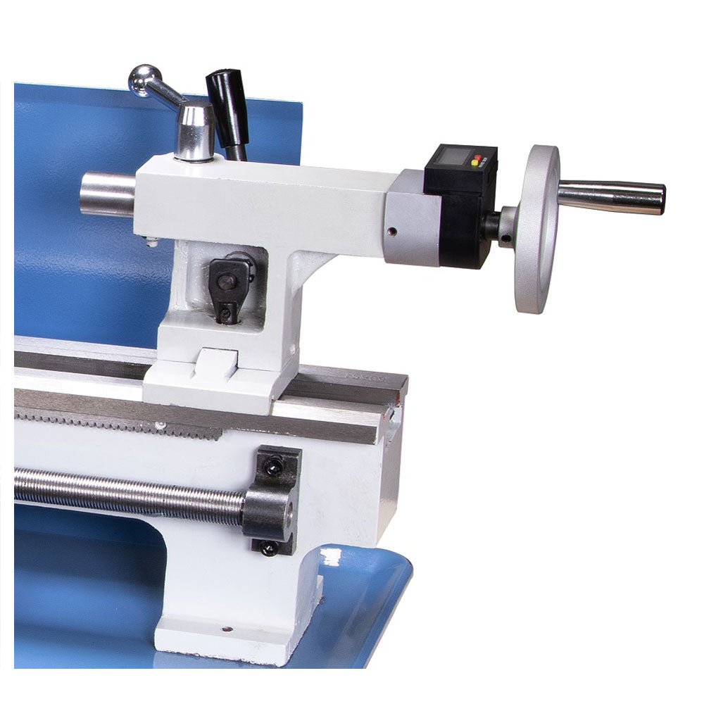

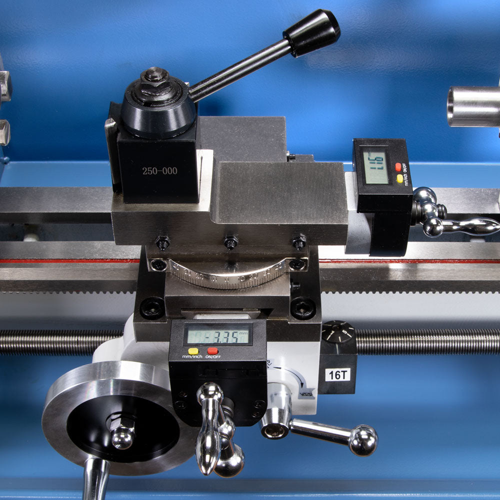

  • This lathe comes equipped with digital readouts on the cross slide, compound rest, and tailstock quill.
  • Attractive hand wheels are all metal, and the levers are chrome.
  • The all steel, 0XA wedge-type quick change tool posts accepts turning tools up to 1/2" shank. It comes with five toolholders

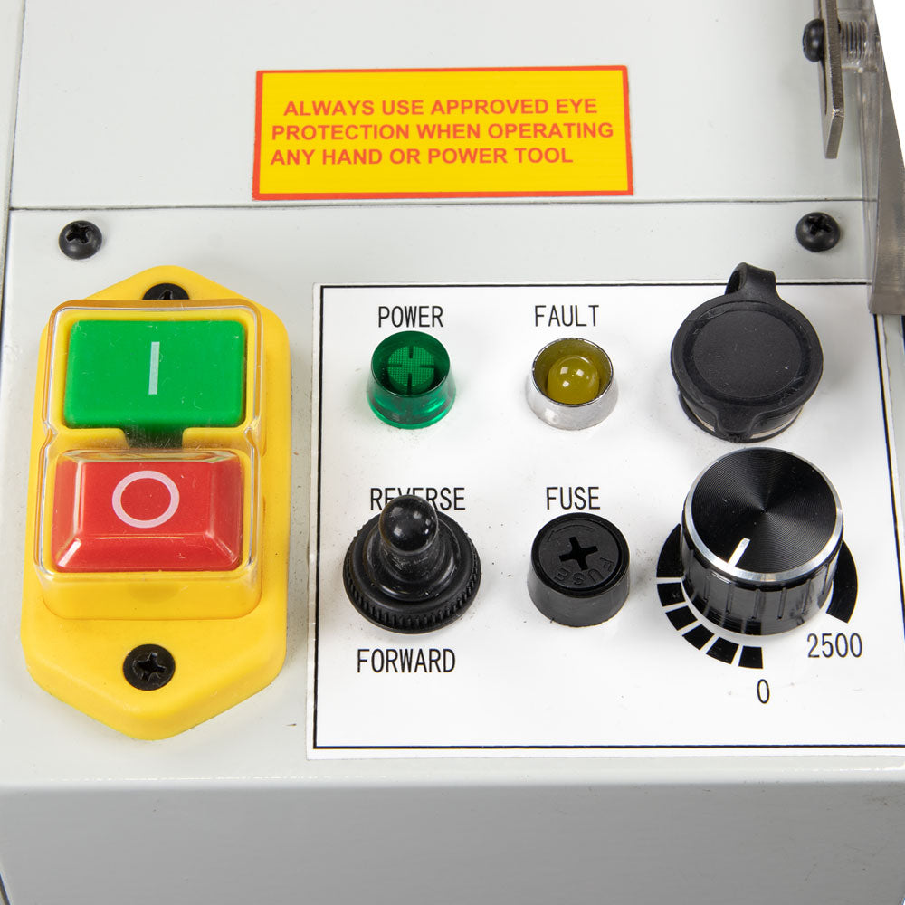

The 500-Watt brushless DC spindle drive motor provides tremendous low-end torque. You can vary the speed from 50 rpm to 2500 rpm continuously in both directions. There are no gears to shift. NSK Bearings ensure years of accurate and reliable life.
The cross feed and compound rest dials are graduated in 0.001" and 0.025 mm. A 4" 3-jaw lathe chuck is included, and the lathe is equipped with a 4-way indexing tool post set for 5/16" (8 mm) tools.
Real top and bottom half-nuts and a reversible 16 TPI lead screw provide extended threading capability. You can create every American Standard Unified class 2A inch screw thread from 4 to 80 threads per inch, and you can create every American Standard Metric class 6h thread from 0.35 to 8 mm pitch with the extra 21 tooth change gear that is included. Cutting inch threads is made even easier with the factory-installed threading dial.

Swing Over Bed: 7.087" (180 mm)
Distance Between Centers: 16.142" (410 mm)
Cross Slide Travel: 2.559" (65 mm)
Swing Over Cross Slide: 2.165" (55 mm)
Spindle Through Hole: 0.787" (20 mm)
Spindle Taper: #3 Morse taper
Tailstock Taper: #2 Morse taper
Range of Threads: 4-80 TPI; 0.35-8.0 mm
Spindle Motor Output: 0.67 hp (500 Watts)
Spindle Speed: 60 to 2500 RPM
Power Requirements: 120 V 60 HZ 8 Amps
Machine Weight: 90 lbs (41 kg)
Crated Weight: 114 lbs (52 kg)
Overall Dimensions (W x D x H): 31.102" x 10.236" x 11.811" (790 mm x 260 mm x 300 mm)
Crate Dimensions (W x D x H): 35.433" x 16.142" x 14.961" (900 mm x 410 mm x 380 mm)
