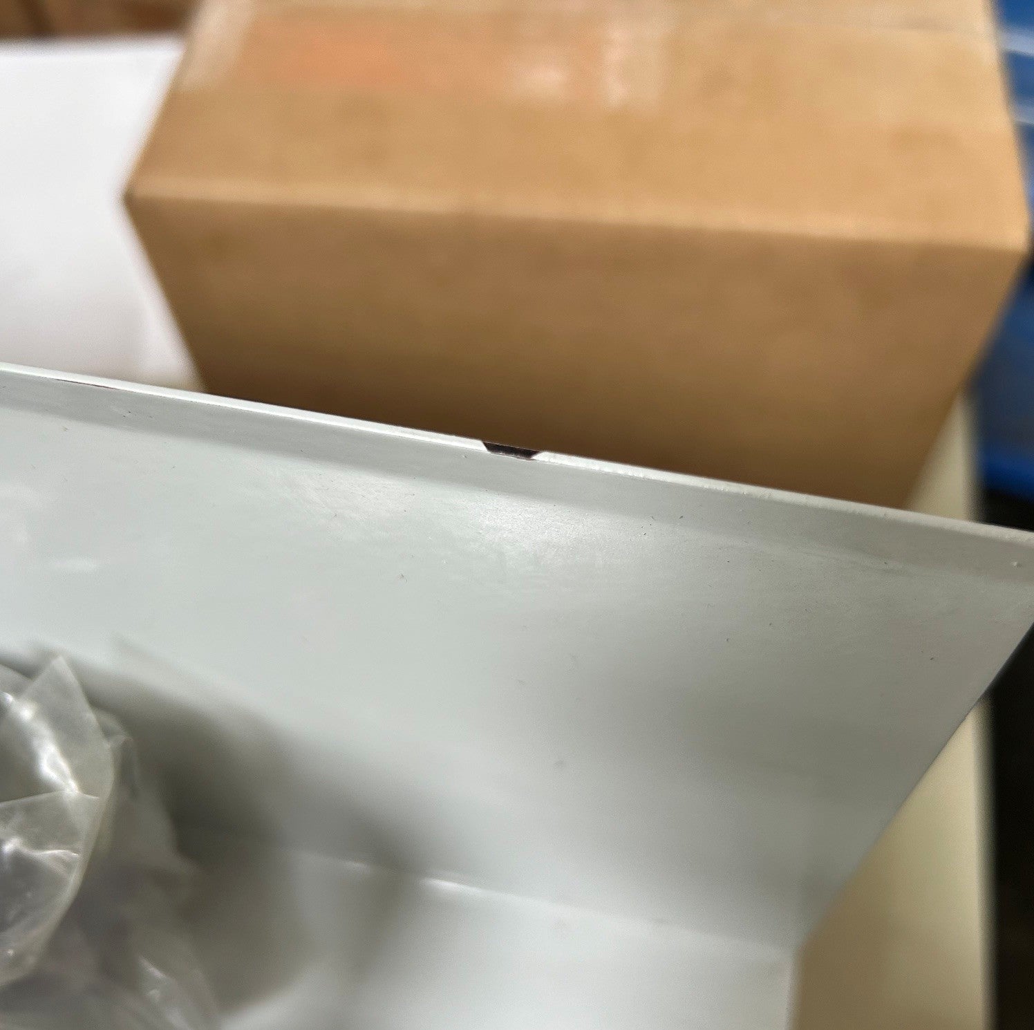

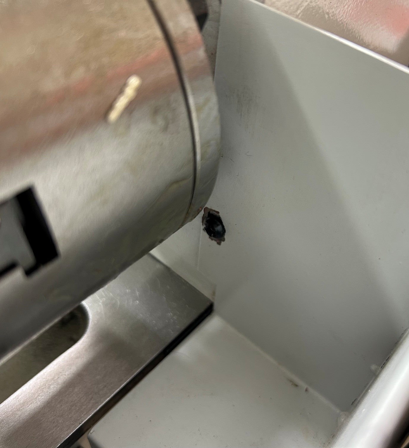

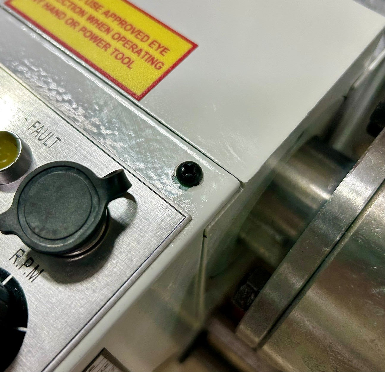

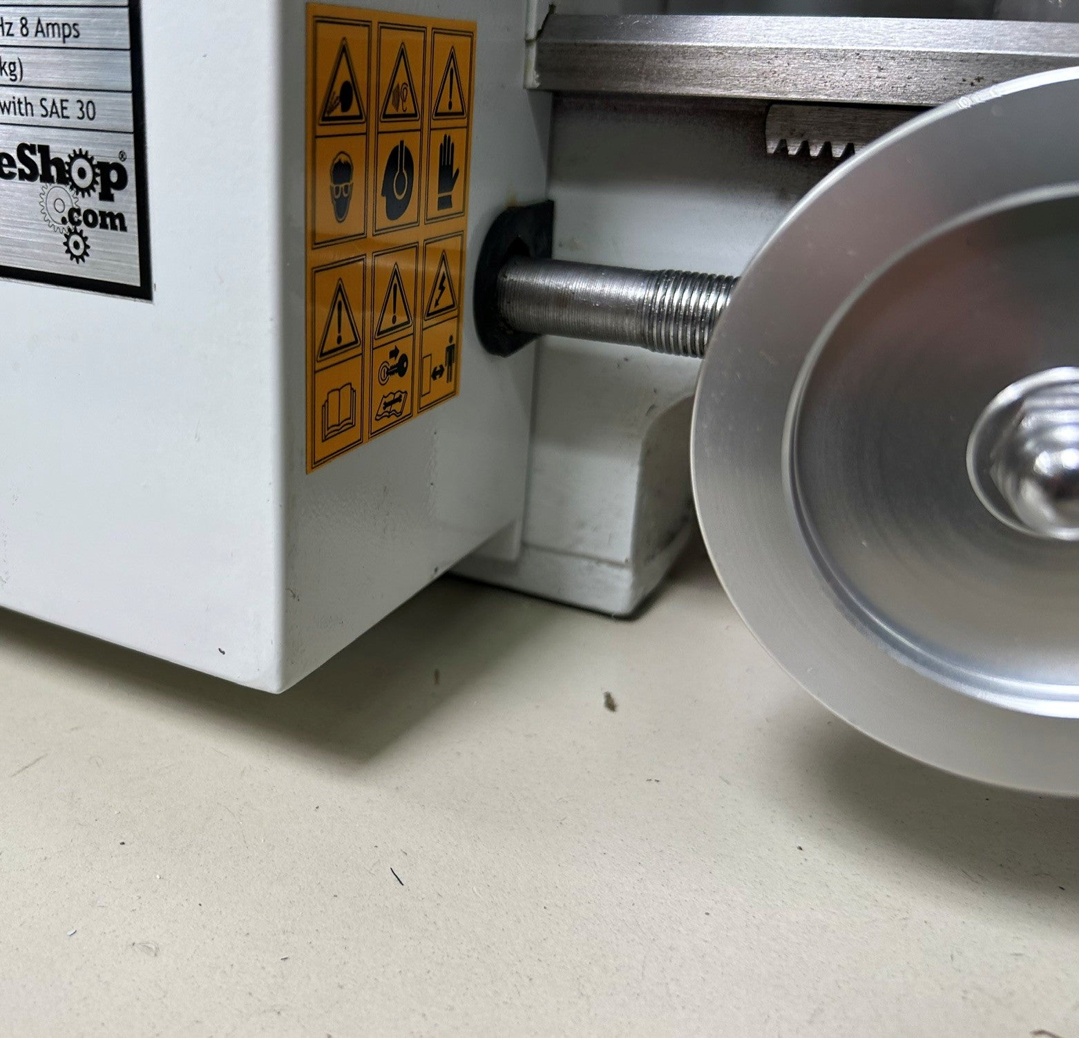

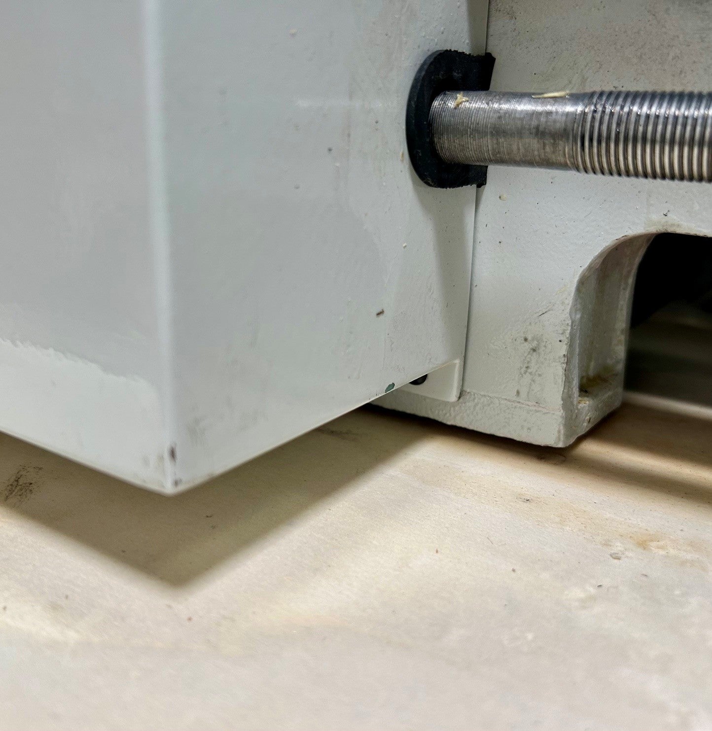

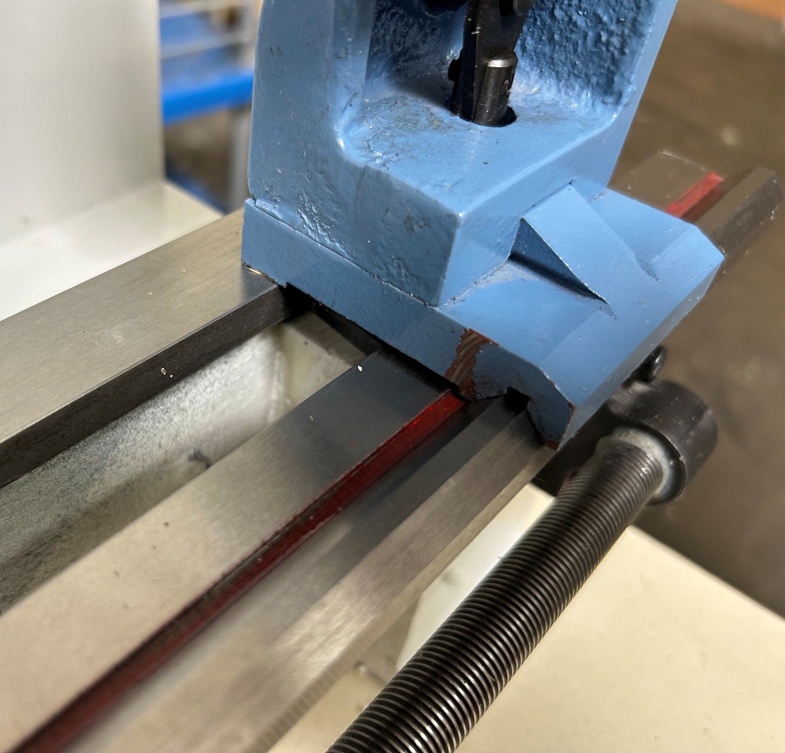

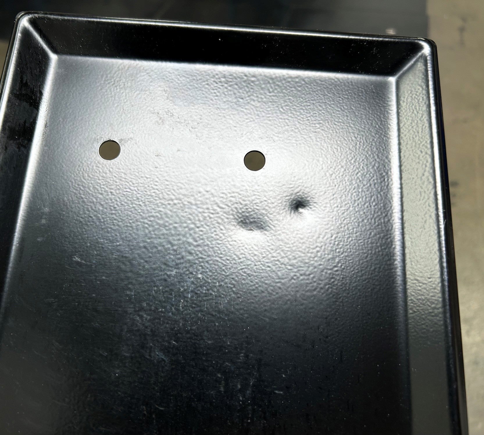

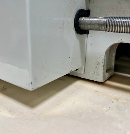

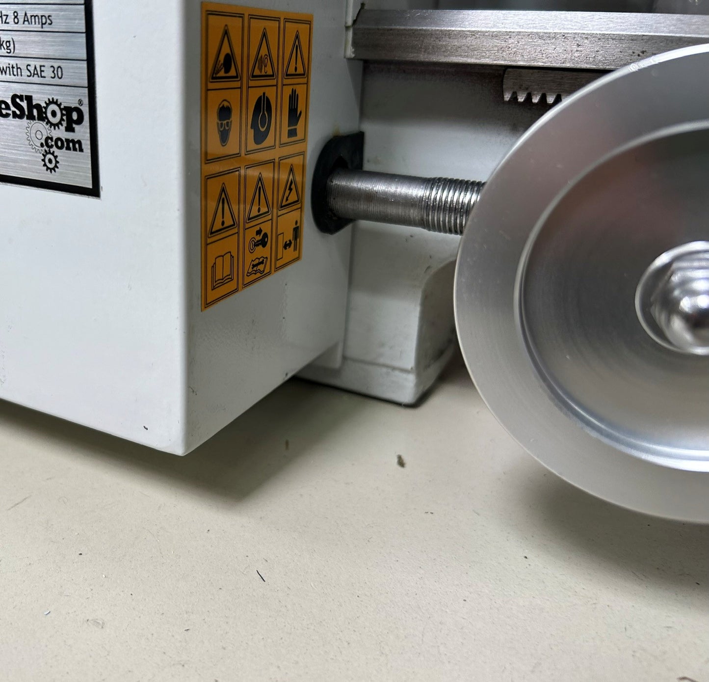

This lathe was damaged in transit, but fixed and ready to be put to work. May be some extremely minor cosmetic damage, but nothing functional. See Pictures.

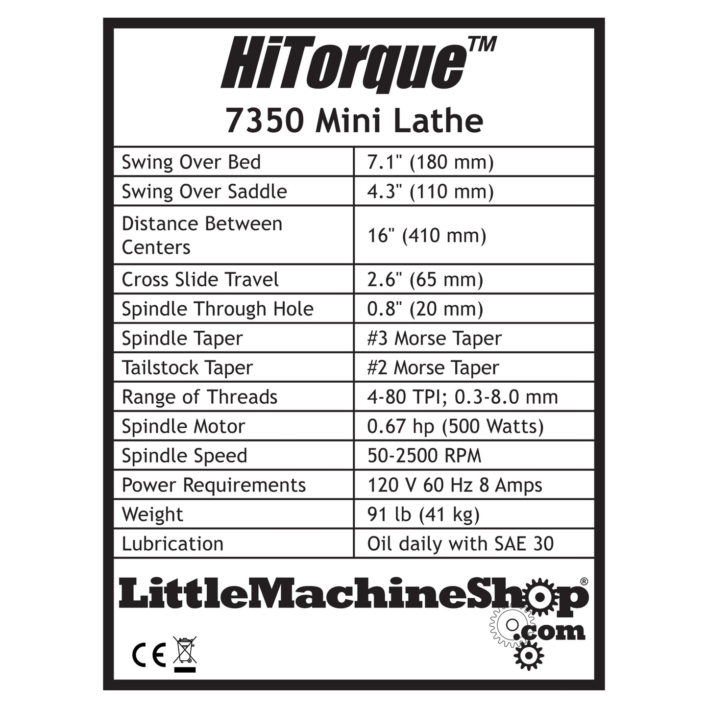

Swing Over Bed: 7.087" (180 mm)
Distance Between Centers: 16.142" (410 mm)
Cross Slide Travel: 2.559" (65 mm)
Swing Over Cross Slide: 2.165" (55 mm)
Spindle Through Hole: 0.787" (20 mm)
Spindle Taper: #3 Morse taper
Tailstock Taper: #2 Morse taper
Range of Threads: 4-80 TPI; 0.35-8.0 mm
Spindle Motor Output: 0.67 hp (500 Watts)
Spindle Speed: 60 to 2500 RPM
Power Requirements: 120 V 60 HZ 8 Amps
Machine Weight: 90 lbs (41 kg)
Crated Weight: 114 lbs (52 kg)
Overall Dimensions (W x D x H): 31.102" x 10.236" x 11.811" (790 mm x 260 mm x 300 mm)
Crate Dimensions (W x D x H): 35.433" x 16.142" x 14.961" (900 mm x 410 mm x 380 mm)
