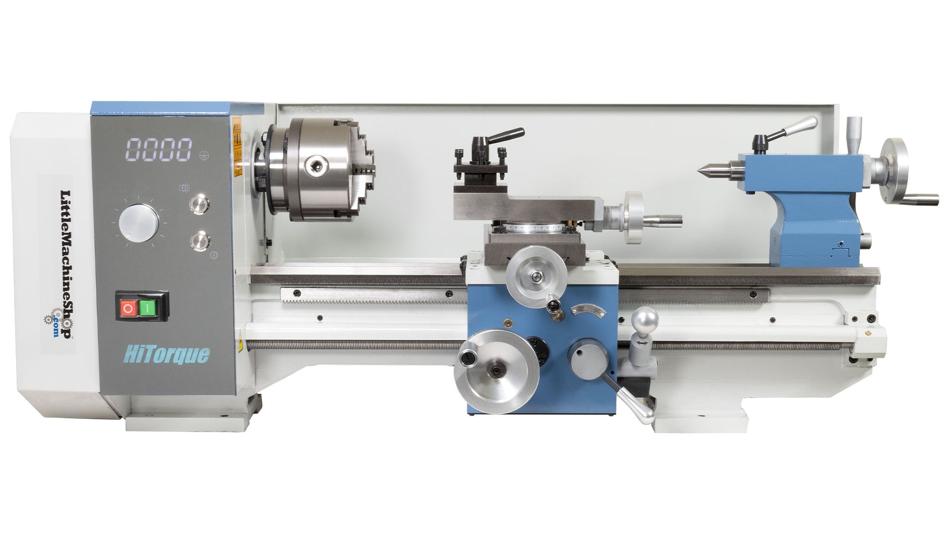

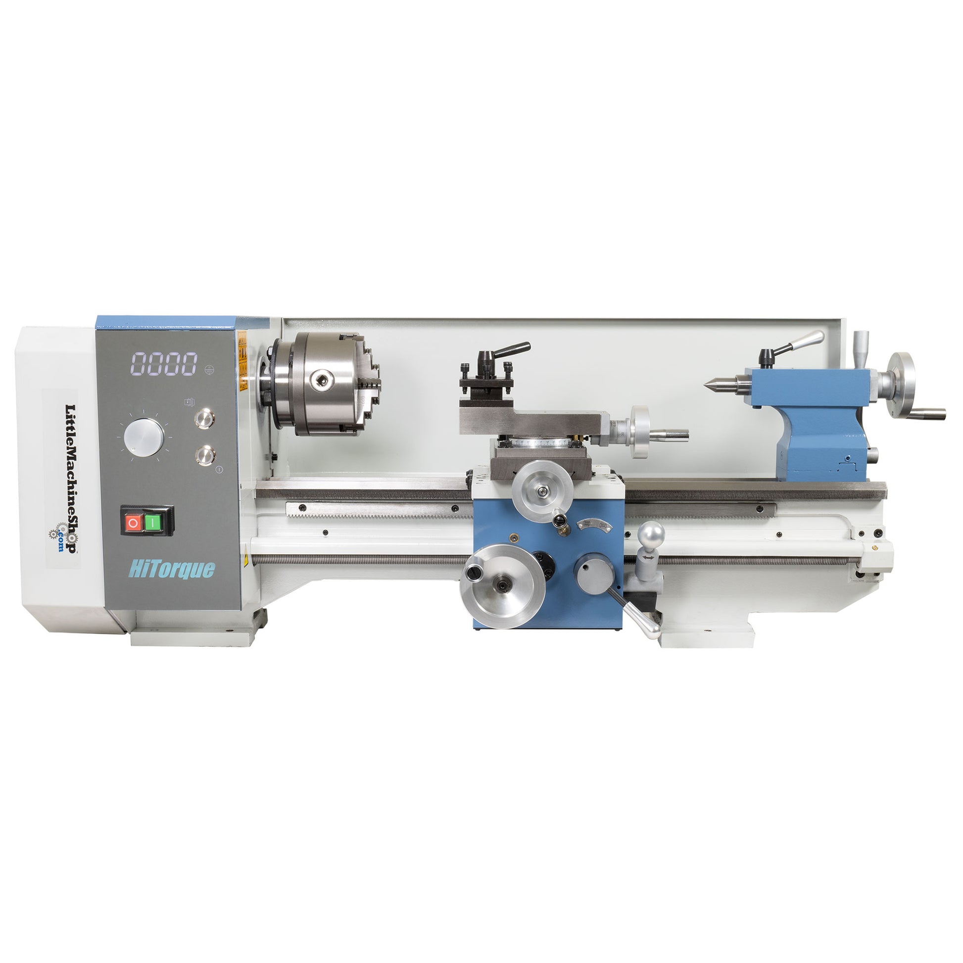

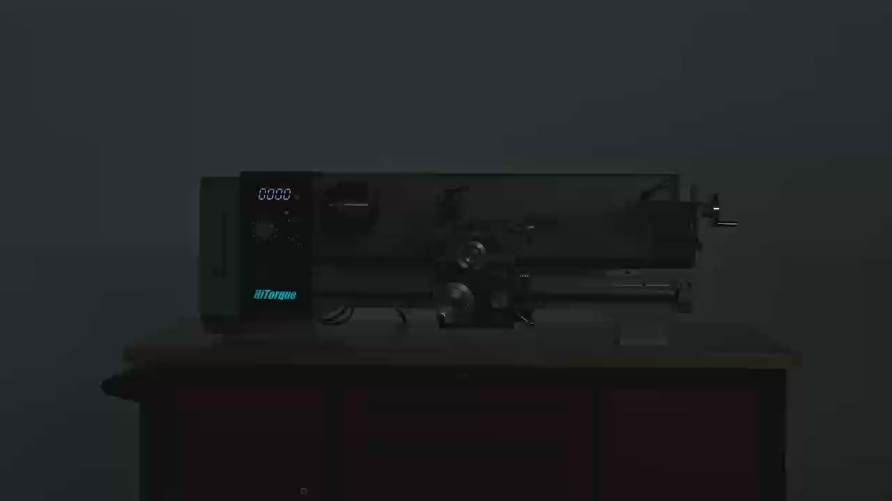

The LittleMachineShop.com model 7600 HiTorque9x20 Bench Lathe is the best in its class. It is a significant step up in size, rigidity, and power compared to a mini lathe. This bench top lathe provides a larger bed, more swing over bed, more horsepower, and more rigidity. Compare our standard features and specs to others in this size and price range.
NEW larger spindle through hole - 1.1" (28 mm) accepts 1" stock.
NEW greater swing from 8.5" to 9"
The 1000-Watt brushless spindle drive motor provides tremendous low-end torque. And you can vary the speed from 100 rpm to 2000 rpm continuously in both directions. There are no gears to shift. NSK brand Japanese-quality spindle bearings ensure years of quiet operation.

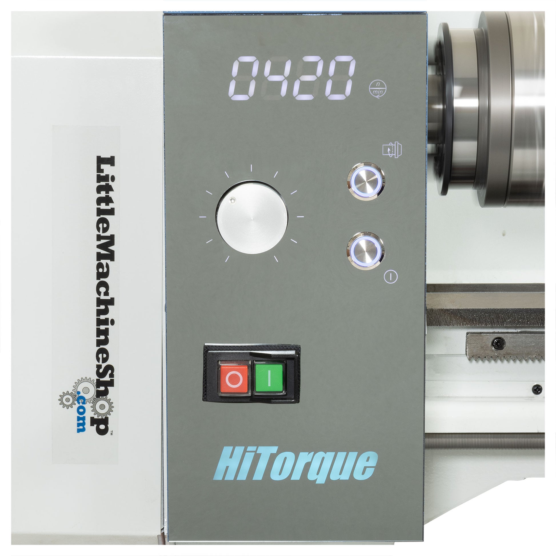

NEW easy-to-read LED display with built in speed readout allows you to stop and then restart the lathe at a pre-selected speed.

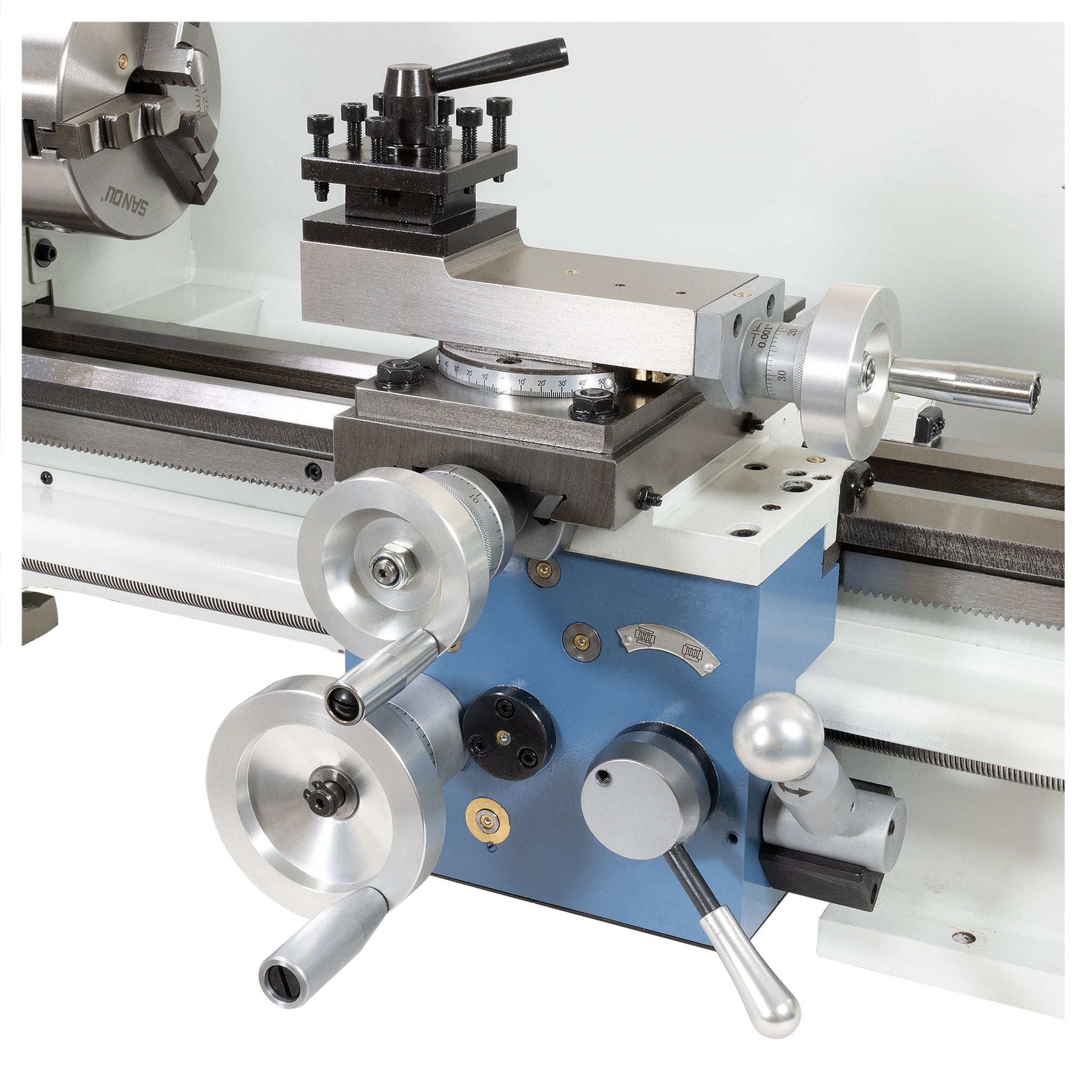

A power cross feed is a feature not found in other lathes of this size. The cross feed and compound rest dials are graduated in 0.001" and advance 0.050" per turn. The metal lathe is equipped with a 4-way indexing tool post set for 10 mm tools.
A reversible 2 mm pitch lead screw provide extended threading capability. You can create every American Standard Unified class 2A inch screw thread from 6 to 80 threads per inch, and you can create every American Standard Metric class 6h thread from 0.25 to 4 mm pitch with the change gears that are included. All the gears on this lathe are metal.

  • NEW easy-to-read LED display with built in speed readout
  • 1000 Watt output spindle motor with spindle speed display

  • Power longitudinal feed
  • Power cross feed

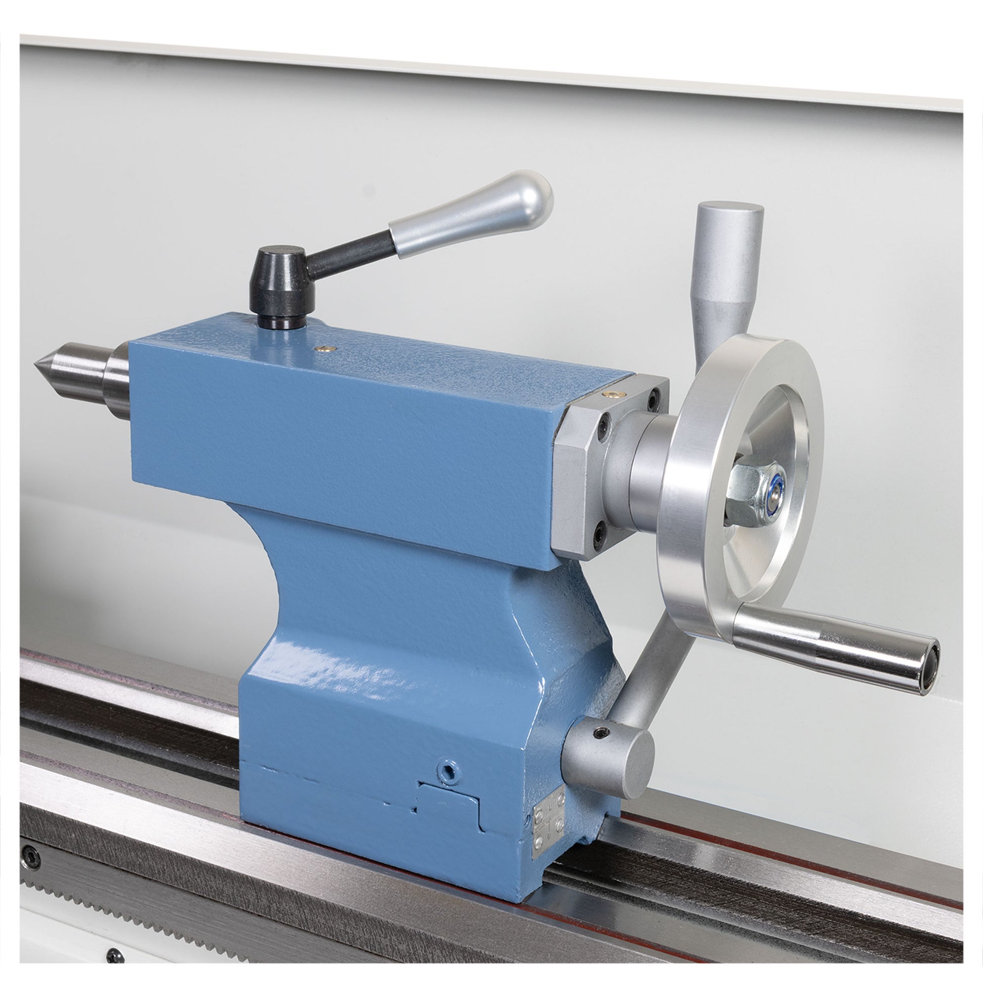

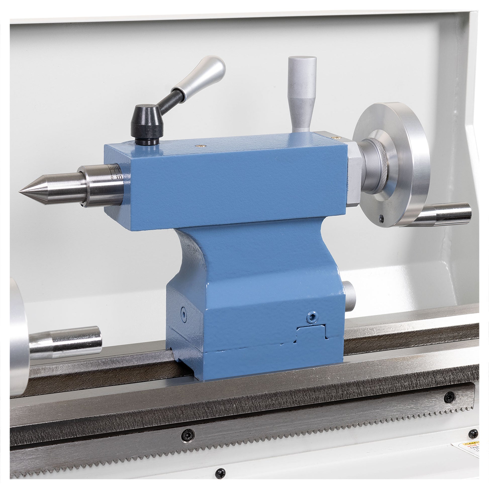

  • Cam-lock tailstock

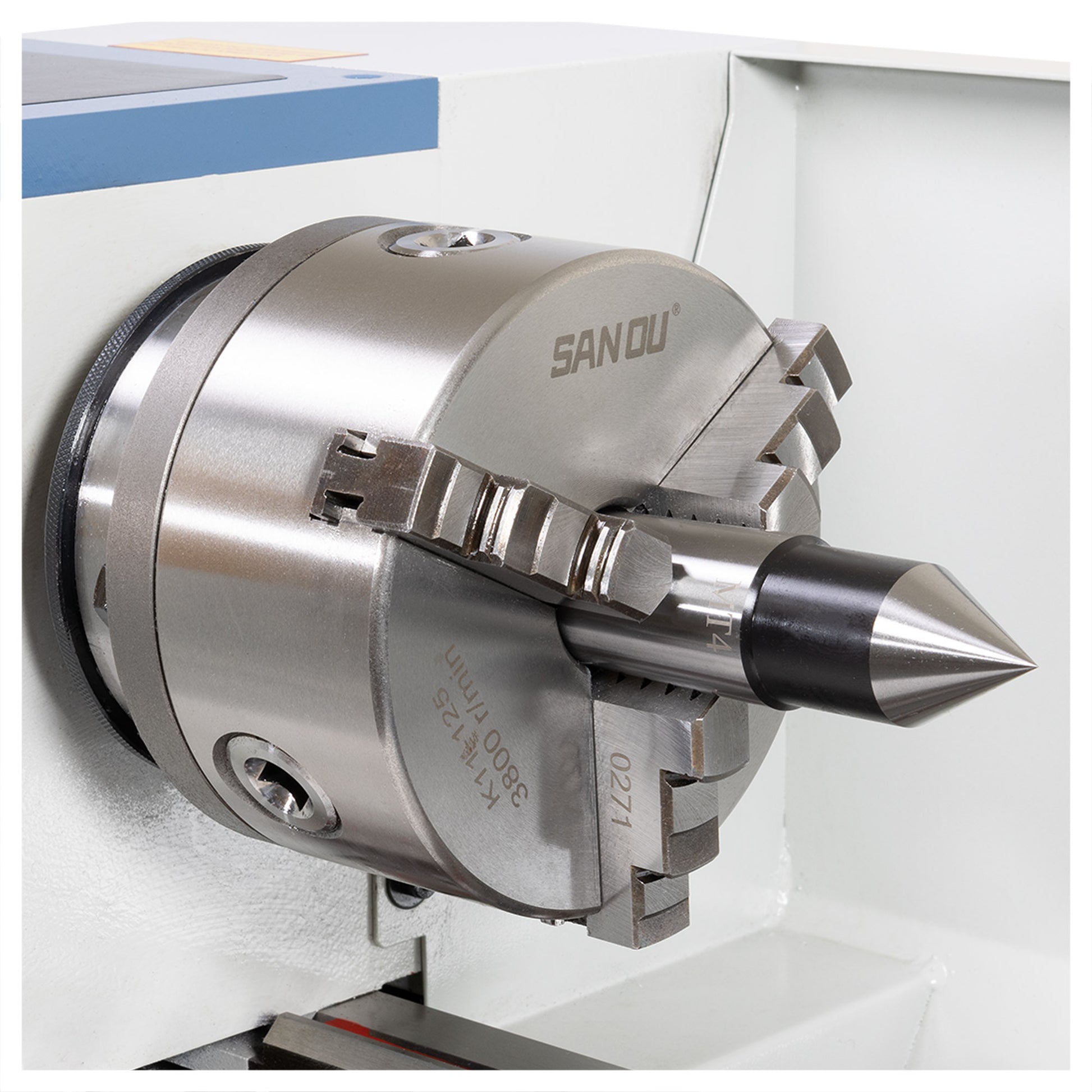

  • 5" (125 mm) 3-jaw self centering lathe chuck

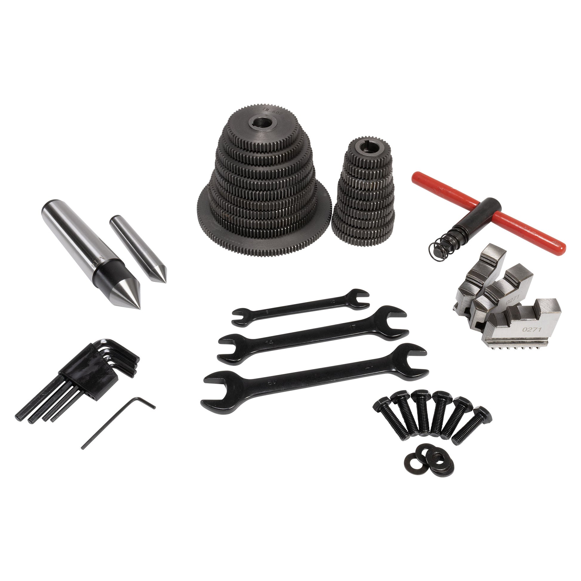

The Bench Lathe comes with the following:
  • 5" (125 mm) 3-jaw self centering lathe chuck with two sets of jaws and a chuck wrench
  • 4-Way rotating tool post
  • A #4 Morse taper dead center for the headstock
  • A #2 Morse taper dead center for the tailstock

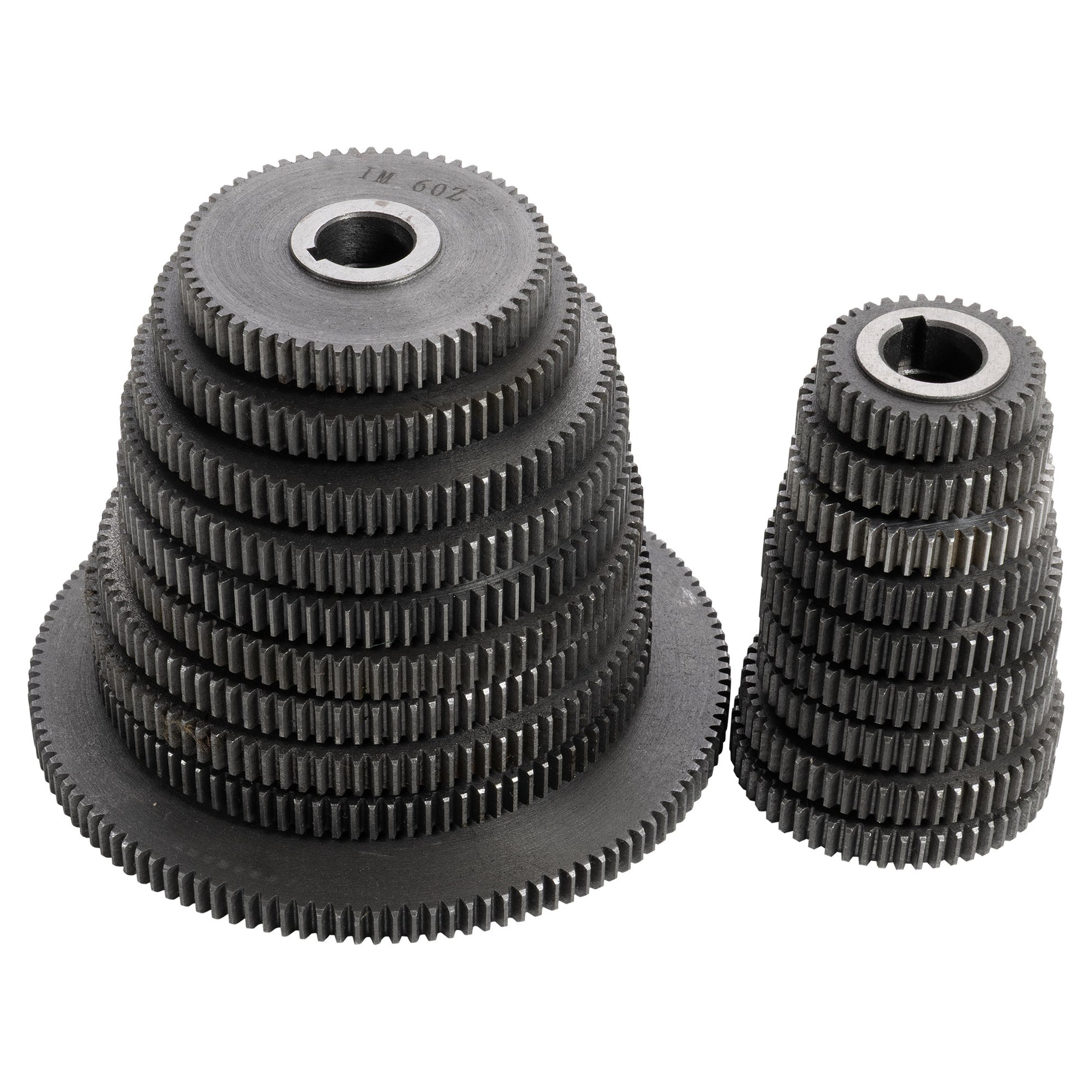

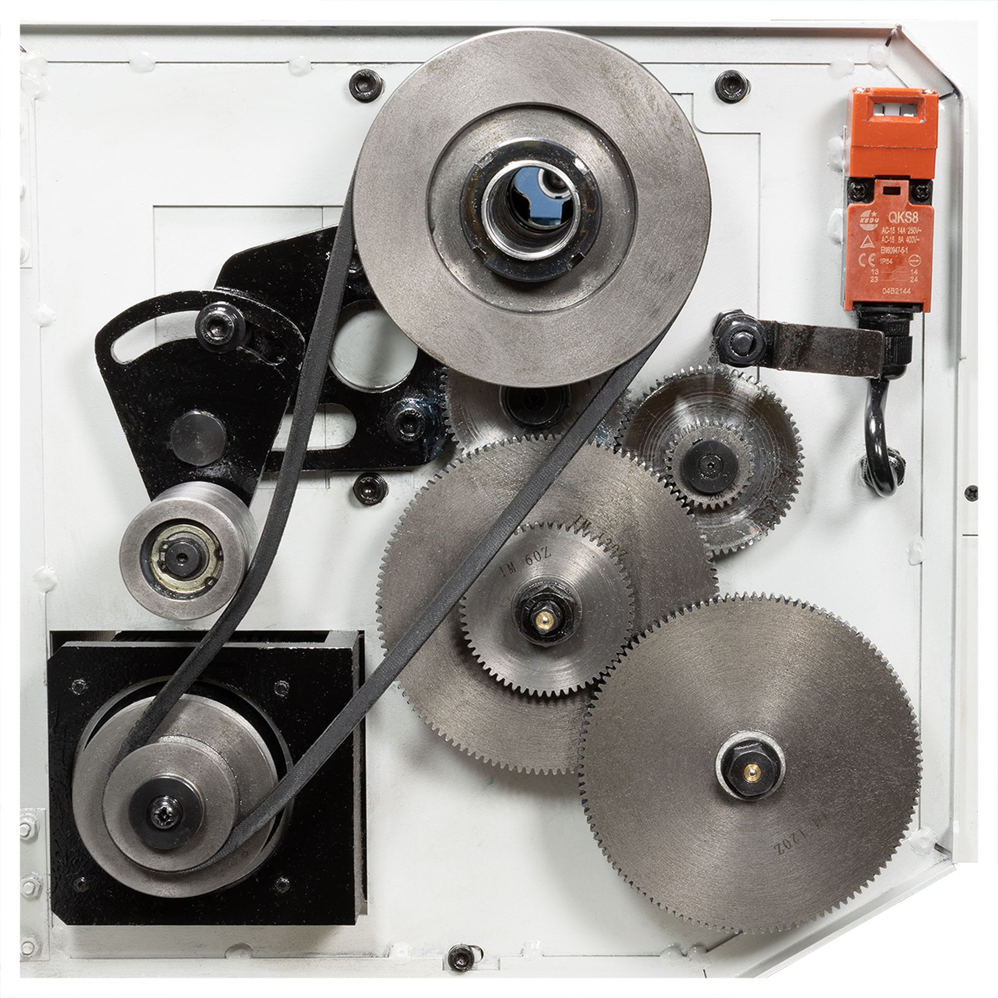

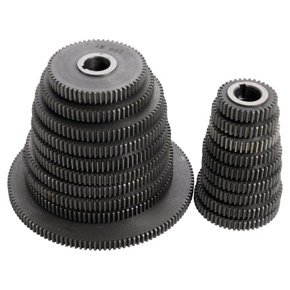

  • Change gear set - 18 Gears - 35, 40, 45, 49, 50(x2), 55, 56, 60, 70, 80, 85, 87, 90, 94, 100(x2), 127 teeth
  • Gears installed on the lathe include 30, 60, 66(x2), 120(x2) teeth
  • Three open end wrenches: 8/10 mm, 14/17 mm, 17/19 mm
  • Five hex (Allen) wrenches: 2, 3, 4, 5, 6 mm
  • Users Manual

With this lathe, you can create every American Standard Unified class 2A inch screw thread from 4 to 100 threads per inch, and you can create every American Standard Metric class 6h thread from 0.25 to 8 mm pitch with the extra 21 tooth change gear that is included.
But you can actually make more thread pitches than that, and there are more change gear combinations than those shown in the user's guide. To see what you can really do, see the Change Gear Calculator.
Swing Over Bed: 9.055" (230 mm)
Distance Between Centers: 18.110" (460 mm)
Cross Slide Travel: 4.724" (120 mm)
Swing Over Cross Slide: 4.331" (110 mm)
Spindle Through Hole: 1.102" (28 mm)
Spindle Taper: #4 Morse taper
Tailstock Taper: #2 Morse taper
Range of Threads: 6-80 TPI; 0.25-4.0 mm
Spindle Motor Output: 1.34 hp (1000 Watts)
Spindle Speed: 100 to 2000 RPM
Power Requirements: 120 V 60 HZ 15 Amps
Machine Weight: 254 lbs (115 kg)
Crated Weight: 315 lbs (143 kg)
Overall Dimensions (W x D x H): 35.827" x 24.803" x 17.717" (910 mm x 630 mm x 450 mm)
