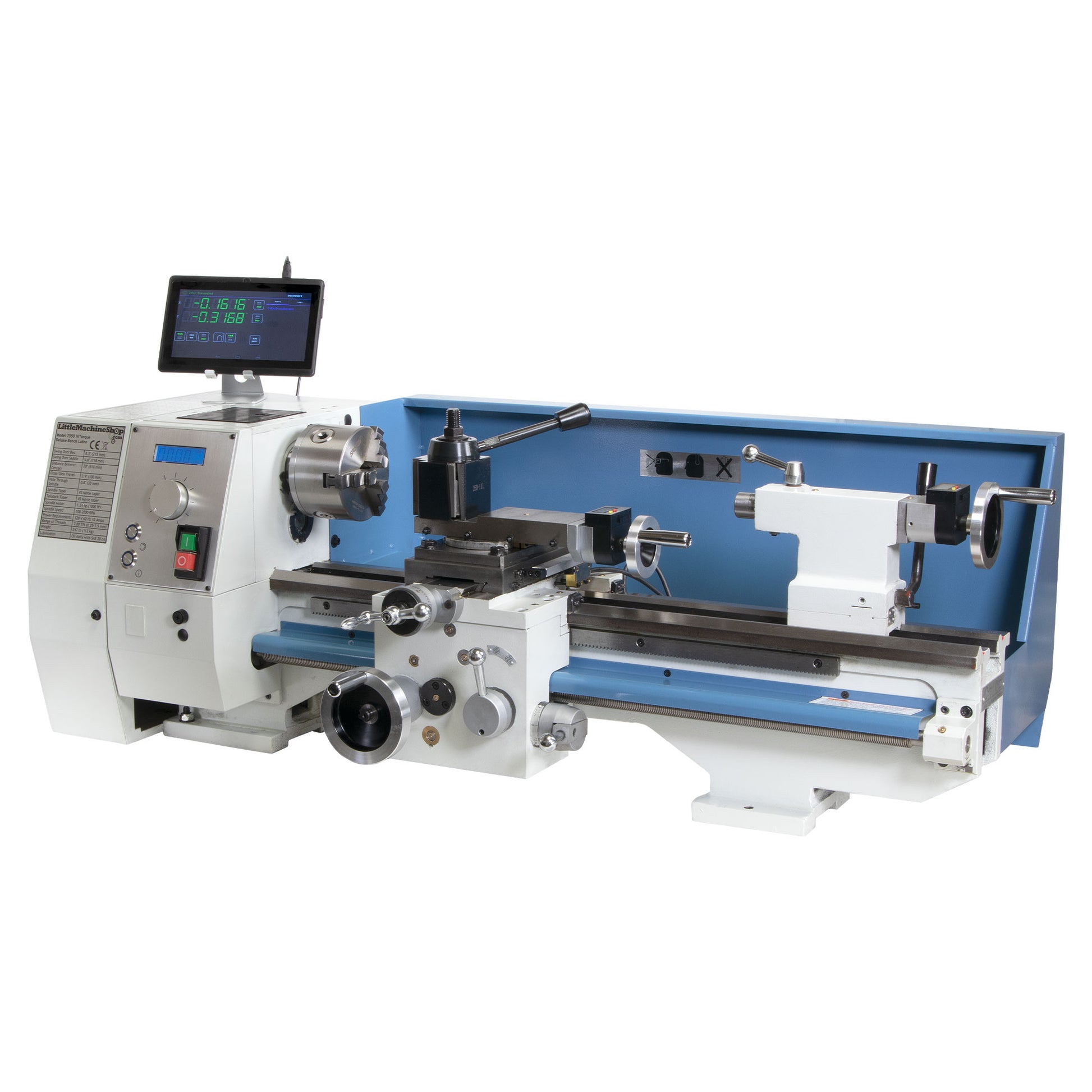

  • DRO and digital dials, inch and metric threading
  • 1000 Watt (1.34 HP) brushless DC drive
  • Power longitudinal feed and power cross feed
  • Reversible lead screw for right and left hand threads
  • 0.8" (20 mm) Spindle through hole

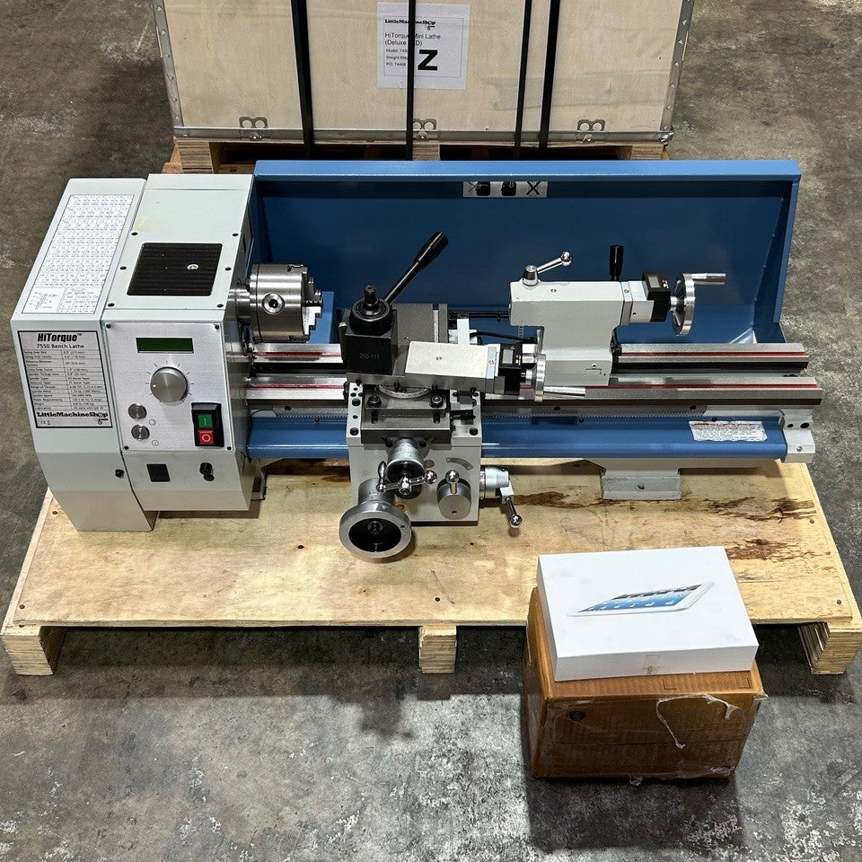

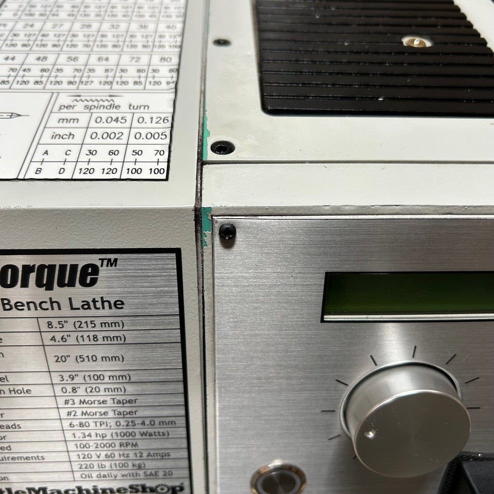

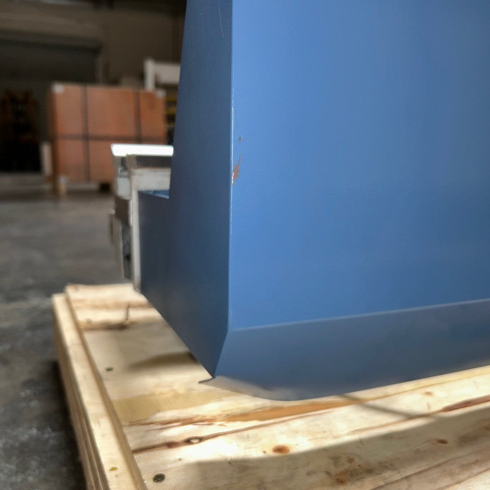

This machine was damaged in shipment, but repaired and ready for use. May be some extremely minor cosmetic damage, but nothing functional. (see photos).
The Deluxe model includes digital readouts (DRO) on the compound rest, cross slide, carriage, and tailstock (cross slide and carriage DROs feed data via magnetic scales to a Bluetooth equipped tablet display). All DROs read equally accurately in inches and mm.
The Deluxe model also includes an AXA quick change tool post set with five tool holders; anodized aluminum hand wheels with black anodizing in the centers; chrome knobs and levers; and a heavy duty splash guard that covers the full bed length. In addition, the compound rest is modified to better accommodate the quick change tool post.
The 1000 Watt brushless spindle drive motor provides tremendous low-end torque. And you can vary the speed from 100 rpm to 2000 rpm continuously in both directions. There are no gears to shift. The updated control panel allows you to stop and then restart the lathe at a pre-selected speed.
A reversible 2 mm pitch lead screw provide extended threading capability. With our lathe machinery, you can create every American Standard Unified class 2A inch screw thread from 8 to 80 threads per inch, and you can create every American Standard Metric class 6h thread from 0.2 to 8 mm pitch with the change gears that are included. All the gears on this lathe are metal.
  • 1000 Watt output spindle motor
  • DRO on compound, cross feed, carriage, and tailstock
  • All DROs read equally accurately in inches and mm.
  • AXA quick change tool post set
  • Genuine NSK ball bearings
  • Induction hardened ways
  • Anodized aluminum hand wheels with black anodizing in centers
  • Chrome knobs and levers
  • Power cross feed
  • E-stop safety power switch
  • Extended threading capability - inch and metric threads
  • Cam lock tailstock
