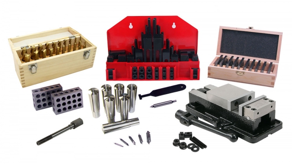

  • 3" Precision Milling Vise (Heavy) and 10 Pairs of 3" long thin parallels
  • Precision 1-2-3 Blocks and 20 piece End Mill Set - 2 and 4 Flute (10 each)
  • 58- piece Clamping Kit - 3/8"-16, 7/16" T-Slots, Five Center Drills
  • Seven piece 3MT Collet Set, 3MT x 3/8"-16 Drawbar
  • Combination Edge and Center Finder and a T-Slot Cleaner
Part Number: 3490  (Discontinued)
Weight: 40.9 lb
$465.95 Value Price
Purchased individually $615.40
Tooling package with all the essentials for a 3MT Mini Mill.
Milling Vise: 3" Kurt-style milling vice. Top, gib, jaws, bottom of vise bed and all plate mounting surfaces are ground. The angle tight positive lock style jaws are interchangeable with industry standard machine vises, are hardened and ground, and can be mounted on either end of the fixed and movable jaw supports for a wide range of clamping distances.
Overall length is 10.85" and the height is 3.05". Jaws are 3.15" wide, 1.04" deep, open 3", and are perpendicular to the ways within 0.002" in 4". The ways are parallel to the base within 0.0006" in 4" without the swivel.
Thin Parallels: Set of ten pairs, 1/8" thick x 3" long, in fitted case. Made of high-grade alloy steel hardened to 52-58 RC, parallel within 0.0002" on top and bottom. Parallel heights: 1/2", 5/8", 3/4", 7/8", 1", 1-1/8", 1-1/4", 1-3/8", 1-1/2", and 1-5/8" (pairs matched within 0.0004").
End Mills: 20-piece set included 2 flute and 4 flute center cutting TiN coated HSS end mills sizes 3/16"-3/4" by 16ths.
3MT Collets: Set of seven high-grade tool hardened steel round collets, sizes 1/8", 3/16", 1/4", 3/8", 1/2", 5/8", and 3/4".
Drawbar: 3MT x 3/8"-16 Mini Mill Drawbar, custom made for LittleMachineShop.com
1-2-3 Blocks: Ground and hardened on all sides to 50-60 RC, sizes 1" x 2" x 3". Parallel within 0.0002", flat within 0.0002", and square within 0.00021". Set has two matched blocks, 23 holes of which 5 are threaded 3/8"-16 NC.
Center Drills: Five sizes combined drills and countersinks made of high speed steel. Sizes 1, 2, 3, 4, and 5 with 60 degree counter sinks.
T-slot cleaners are designed for Bridgeport mills. It takes a few seconds on a grinder to reduce the size of the "T" to fit the slots on the mini mill.The components of this package have a retail value over $348.00, so this package saves you over $48.
