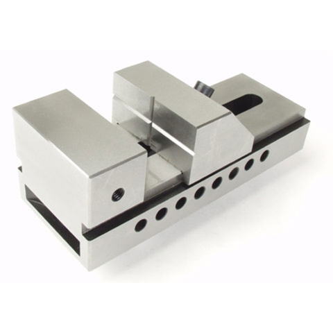

  • Hardened and Precision Ground
  • Square and Parallel within 0.0002"
  • Ground "V" Way
This high precision toolmakers screwless vise has a one-piece body. The body and jaws are hardened to Rc 58-62. All sides are flat, square and parallel to 0.0002". There are horizontal and vertical vees on the inside face of the movable jaw to hold round objects.
The jaws are 1.38" deep and open to 3.78" capacity.
The vise is 7.28" long, 2.76" tall and 2.875" wide.
Chris' Tips
You can use your clamping kit to secure this vise using the slots in the ends, but we recommend that you make a couple of clamping blocks to secure the vise across the table.
