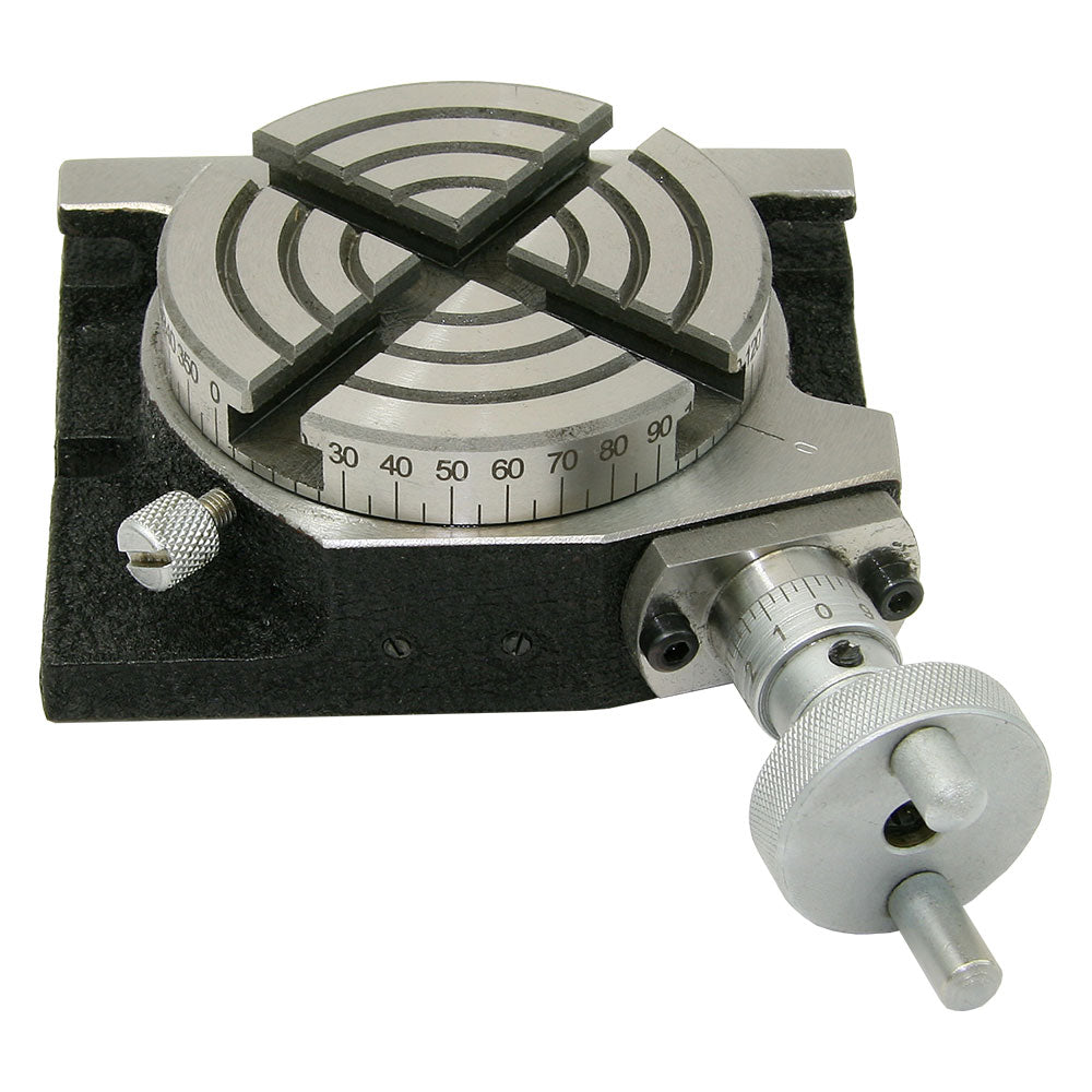

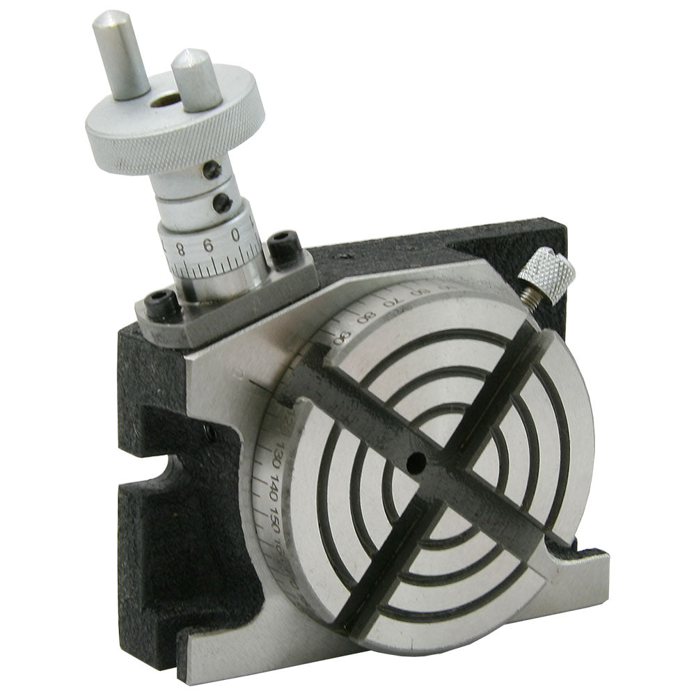

  • Horizontal or vertical use
  • 3" diameter table rotates 360°
  • 1:36 ratio or 10° per handwheel revolution
  • Scale reads to 15 minutes
  • Low profile of 45.0 mm (1.77")
Affordably priced rotary table suitable for bolt patterns, arched slots, cutting out flywheels and other medium precision jobs. The small size of the table is good for small milling machines. The table has a low profile of 45mm (1.77") in the horizontal position.
This precision ground graded cast iron table is graduated for a full 360°. The handwheel utilizes a 1:36 ratio resulting in 10° per handwheel revolution.
Table comes with two clamping studs, two 45mm clamping bars and two t-nuts.
