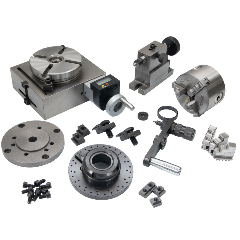

- Complete Rotary table and indexing solution
- Includes 4" rotary table, diving plate, tailstock, and 3" 3-jaw chuck
- Lock down clamps and t-slot nuts also included
- Tailstock is adjustable in height
- 2 Morse taper center hole
This kit provides a complete rotary table and indexing solution.
This horizontal / vertical rotary table is for indexing, circular cutting, angle setting, boring, and spot facing operations. The cast iron table is precision machined and has a 2 Morse taper center hole. A micro collar graduated to one minute with a fifteen second accuracy vernier scale is provided. The rotary table has lock down clamps.
The tailstock is adjustable in height.
The dividing plate set consists of one plate with two sets of holes. One circle has 15 holes and the other has 28 holes. This lets you divide a circle into 1/3 degree increments, among many other combinations.
The 3 inch 3-Jaw self-centering lathe chuck includes a chuck key, inside and outside jaws, and mounting bolts.
The lathe chuck adapter lets you mount a 3" 3- or 4-jaw lathe chuck on a rotary table with a 2 Morse taper center hole. There is an alignment boss that projects into the tapered hole for quick alignment. It is clamped to the rotary table with T-slot nuts that are included.
The precision rotary table works with this tail stock, this dividing plate set and this clamping kit.
