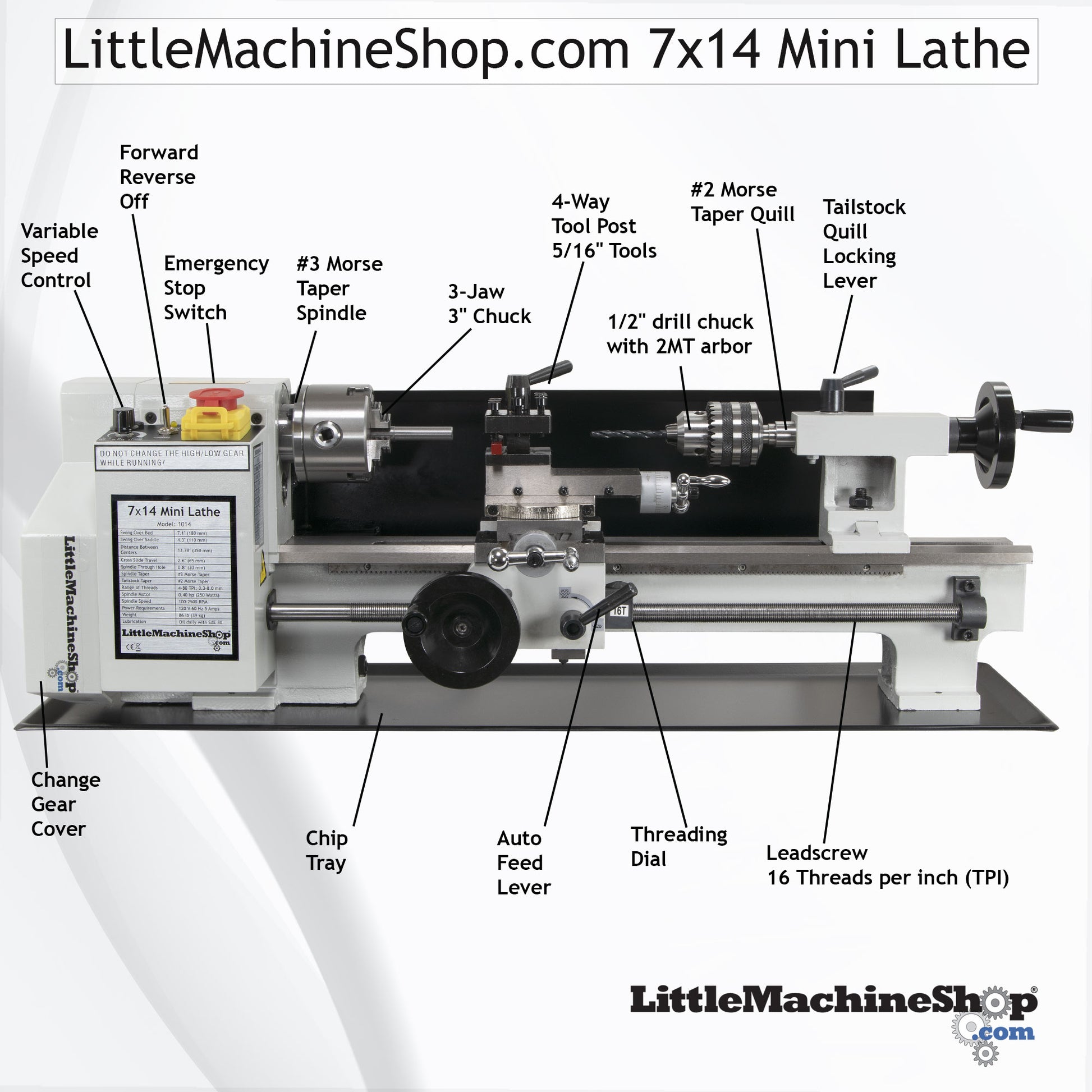

  • Full featured miniature lathe at an incredible price

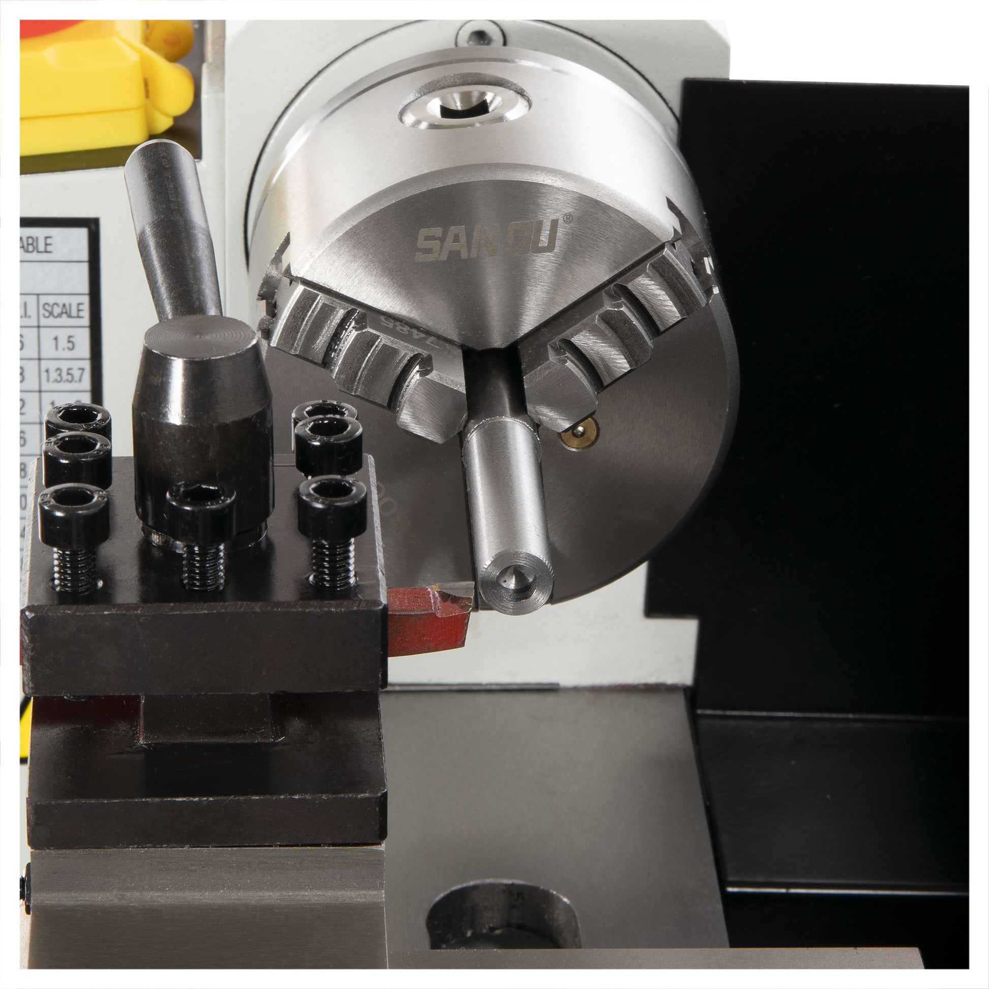

  • Includes 3" 3-jaw chuck, 2 sets of jaws, and chuck key
  • Variable speed with two speed ranges for low speed torque

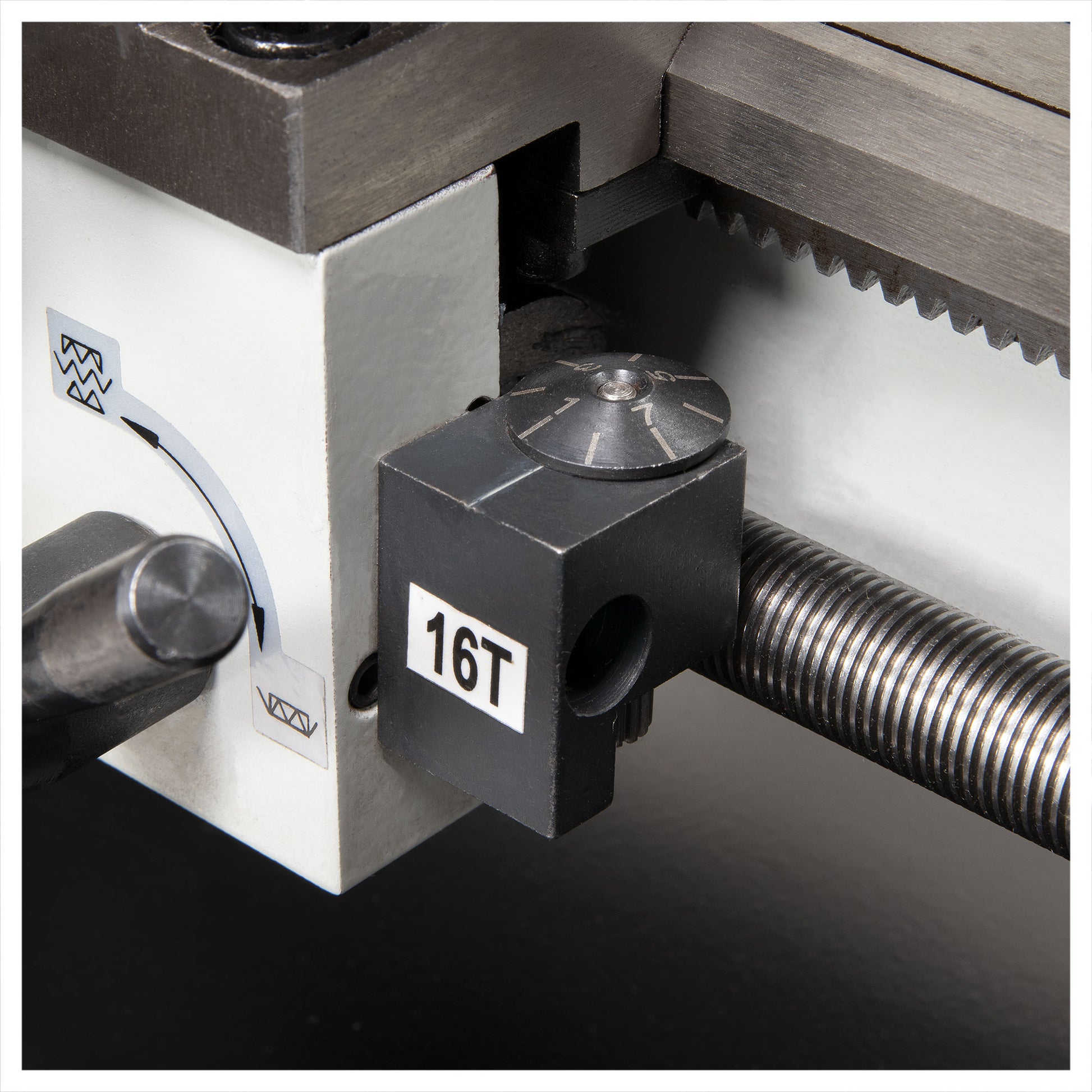

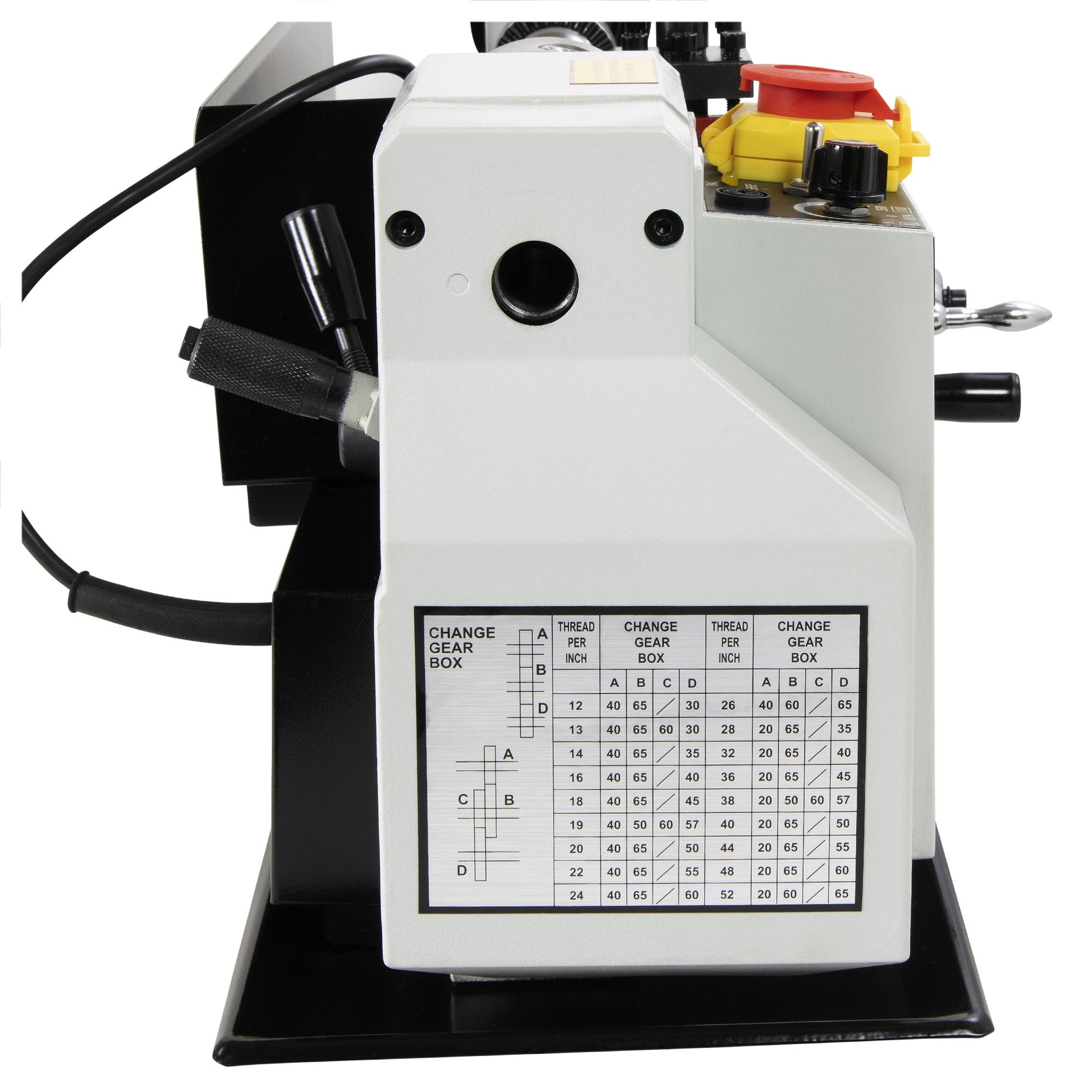

  • Threading Dial
  • 2MT dead center, change gear set, 1/2" drill chuck

The LittleMachineShop.com exclusive version of this machine features:
  • Full 14" bed length with a 2MT tailstock for longer work pieces.
  • 250-Watt spindle motor with 2 Speed ranges for low speed torque
  • Threading dial
  • Reversible lead screw for right- and left-hand threads
  • The cross feed and compound rest dials are graduated in 0.001" and 0.025 mm.
  • The lathe is equipped with a 4-way indexing tool post set for 5/16" (8 mm) tools
  •  Chip tray and backsplash.
  •  User's Manual

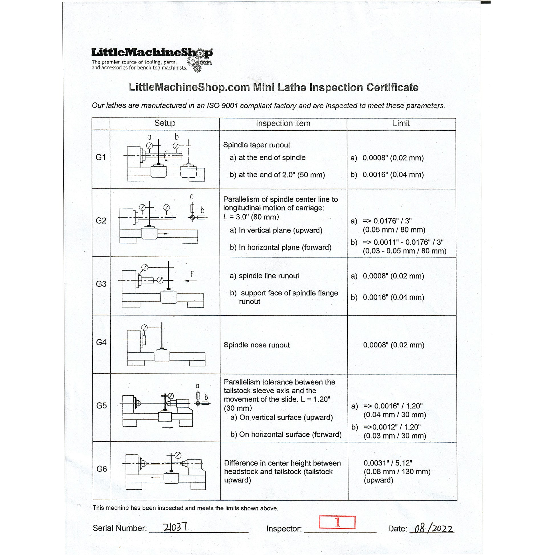

  •  Made and inspected in an ISO 9001 compliant factory

  • SANOU 3" (80 mm) 3-jaw chuck with two sets of jaws and chuck key.

With this lathe, you can create every American Standard Unified class 2A inch screw thread from 4 to 100 threads per inch, and you can create every American Standard Metric class 6h thread from 0.25 to 8 mm pitch with the extra 21 tooth change gear that is included.
But you can actually make more thread pitches than that, and there are more change gear combinations than those shown in the user's guide. To see what you can really do, see the Change Gear Calculator.

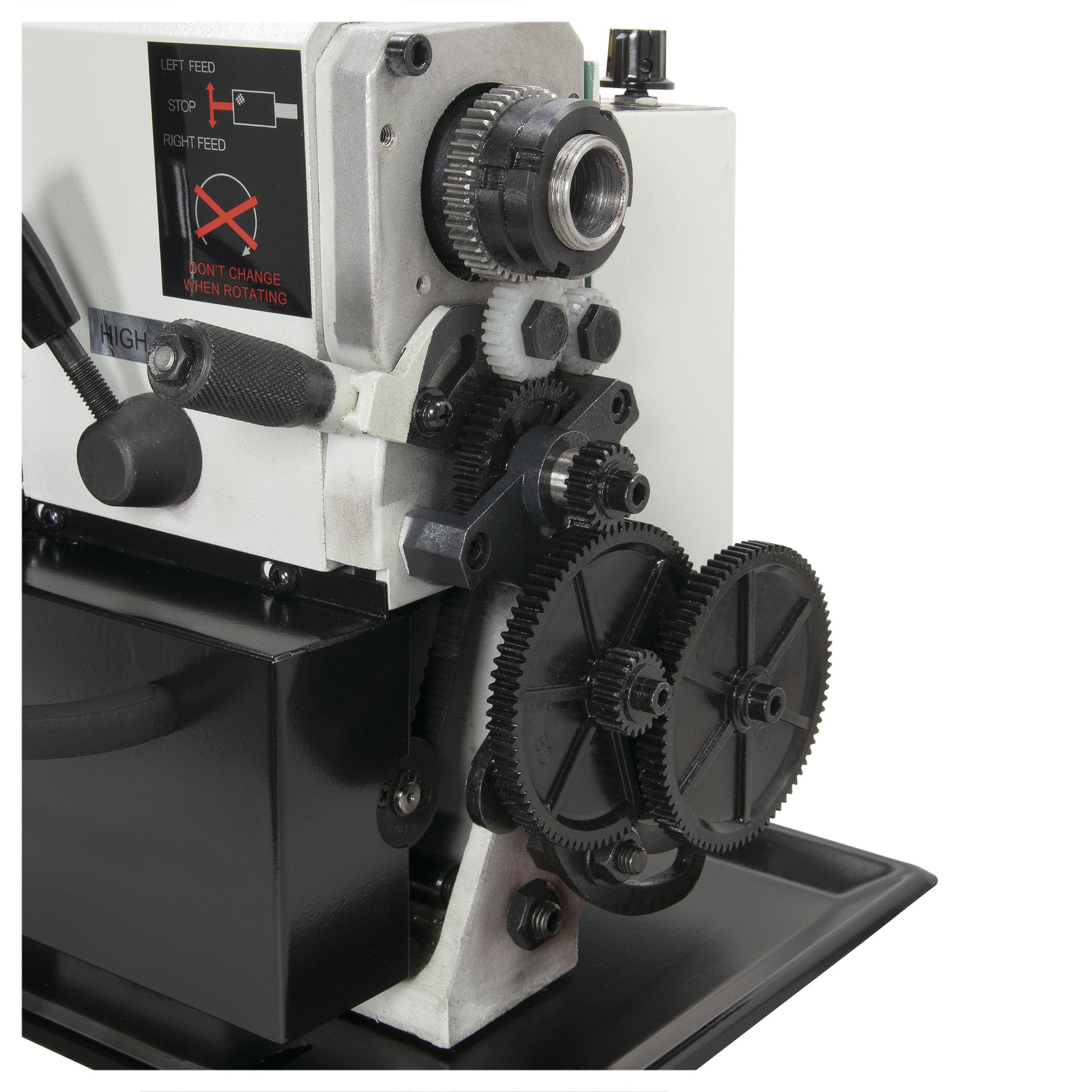

Why HiTorque mini lathes have plastic change gears.
First, a couple of notes:
  • The use of plastic gears in HiTorque machines is limited to mini lathe Change Gears. HiTorque mills and lathes have no Drive Gears as they utilize a brushless DC drive with a belt directly from the motor to the spindle. In short, there are no gears at all in the spindle drive.
  • When you read about plastic gears breaking, most cases involve the two-speed gears inside the headstock of mini mills. As noted, this does not apply to any HiTorque mini mill as we have no gears in the spindle drive.
  • The use of plastic change gears does not apply to the HiTorque bench lathes. Our larger HiTorque bench lathes, which are designed for larger work pieces, greater power, and more torque, have all metal gears as appropriate for their size.
With those qualifiers out of the way, here are some of the important points in favor of using plastic Change Gears in HiTorque mini lathes:
  • Plastic gears are quieter than metal gears. Metal change gears raise the sound level to an objectional level.
  • Plastic gears are more economical and help reduce machine cost and keep gear replacement cost to a minimum.
  • Our plastic gears are made from a thermoplastic Polyoxymethylene (POM) which are very durable.
  • In the rare cases where a plastic gear does fail, it is often due to using the lathe for jobs beyond its design parameters. In such a case, the broken gear worked as an inexpensive mechanical fuse, saving the machine from damage.
If you prefer metal change gears, we sell a Metal Change Gear Set. Note: Please check the compatibility tab on the product page to ensure that you are getting the correct gear set for your machine.
For more information on plastic gears visit our detailed discussion Plastic Gears, Good or Bad?.

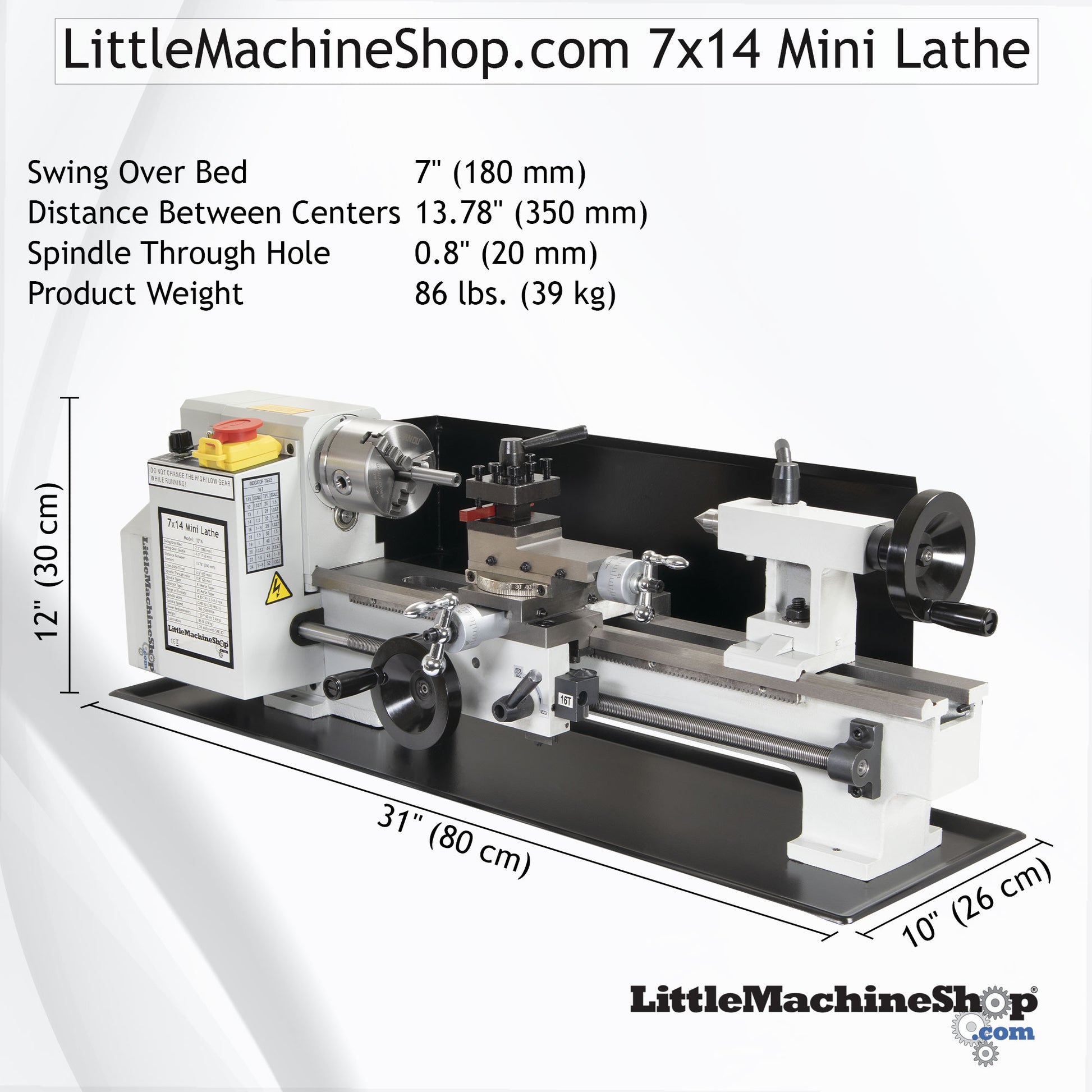

Swing Over Bed: 7.087" (180 mm)
Swing Over Saddle: 4.331" (110 mm)
Distance Between Centers: 13.780" (350 mm)
Cross Slide Travel: 2.559" (65 mm)
Spindle Through Hole: 0.787" (20 mm)
Spindle Taper: #3 Morse taper
Tailstock Taper: #2 Morse taper
Range of Threads: 12-52 TPI
Range of Threads (Metric): 0.3-8.0 mm pitch
Spindle Motor Output: 0.34 hp (250 Watts)
Spindle Speed: 100 to 2500 RPM
Power Requirements: 120 V 60 HZ 5 Amps
Crated Weight: 120 lbs (54 kg)
Machine Weight: 86 lbs (39 kg)
Overall Dimensions (W x D x H): 31.496" x 10.236" x 11.811" (800 mm x 260 mm x 300 mm)
Crate Dimensions (W x D x H): 35.827" x 14.961" x 17.717" (910 mm x 380 mm x 450 mm)
