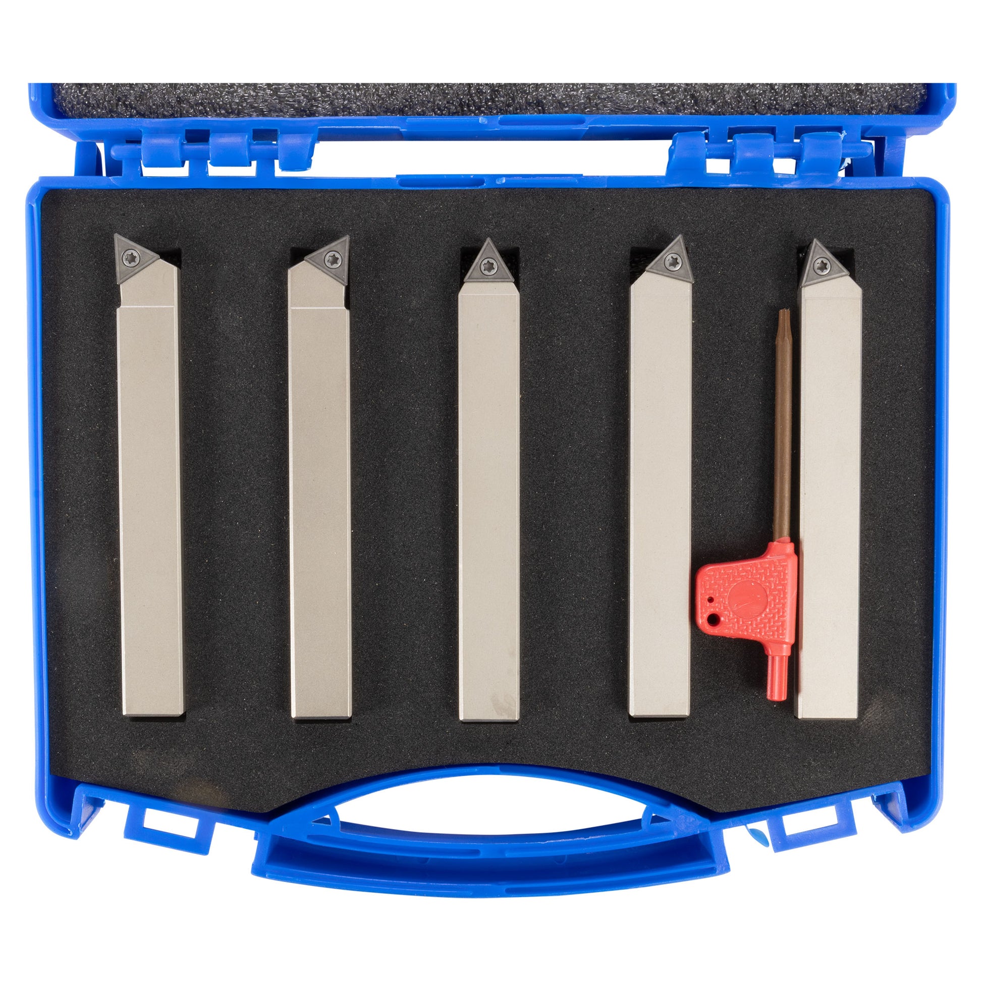

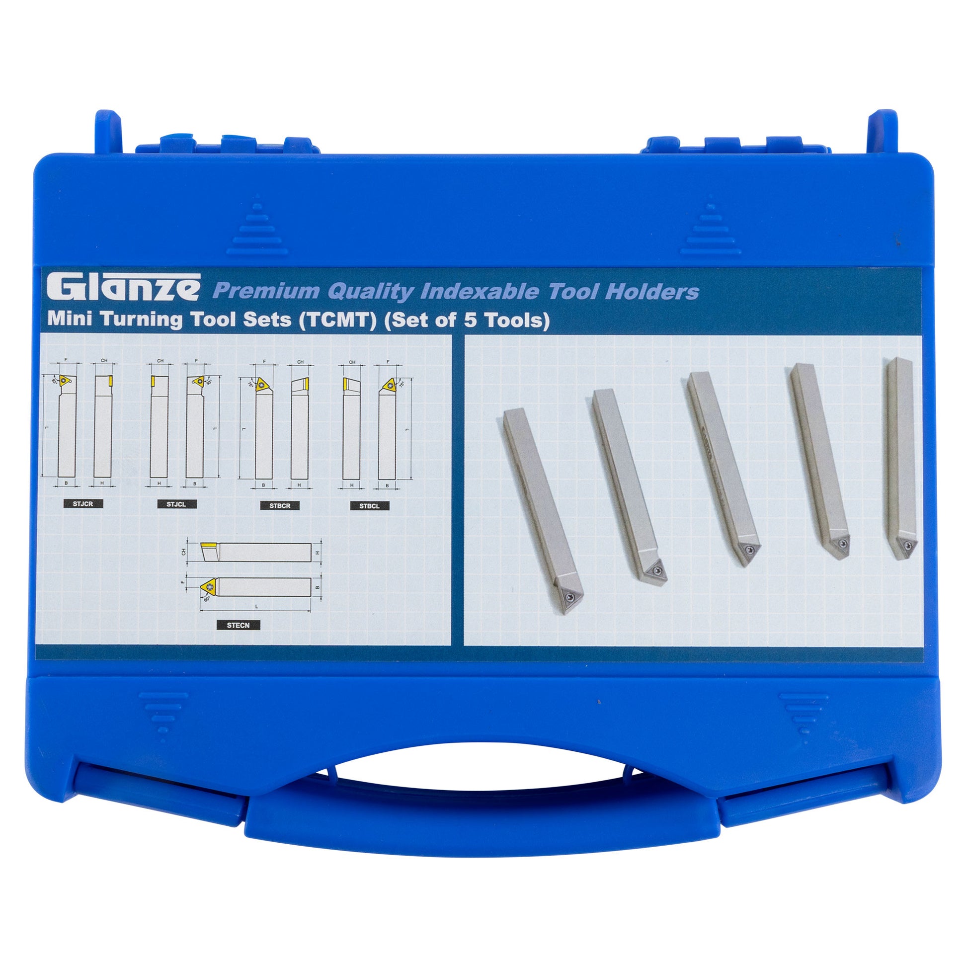

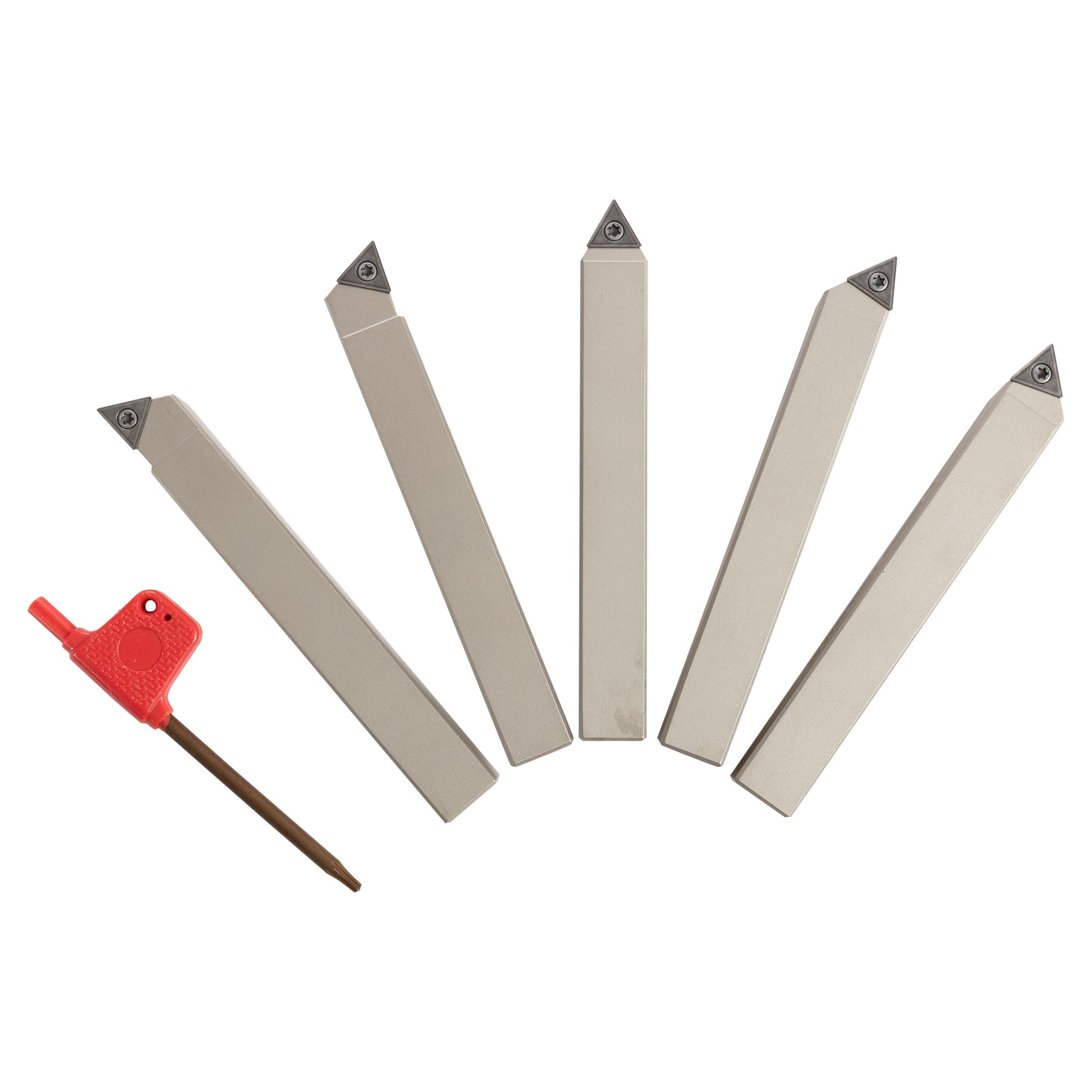

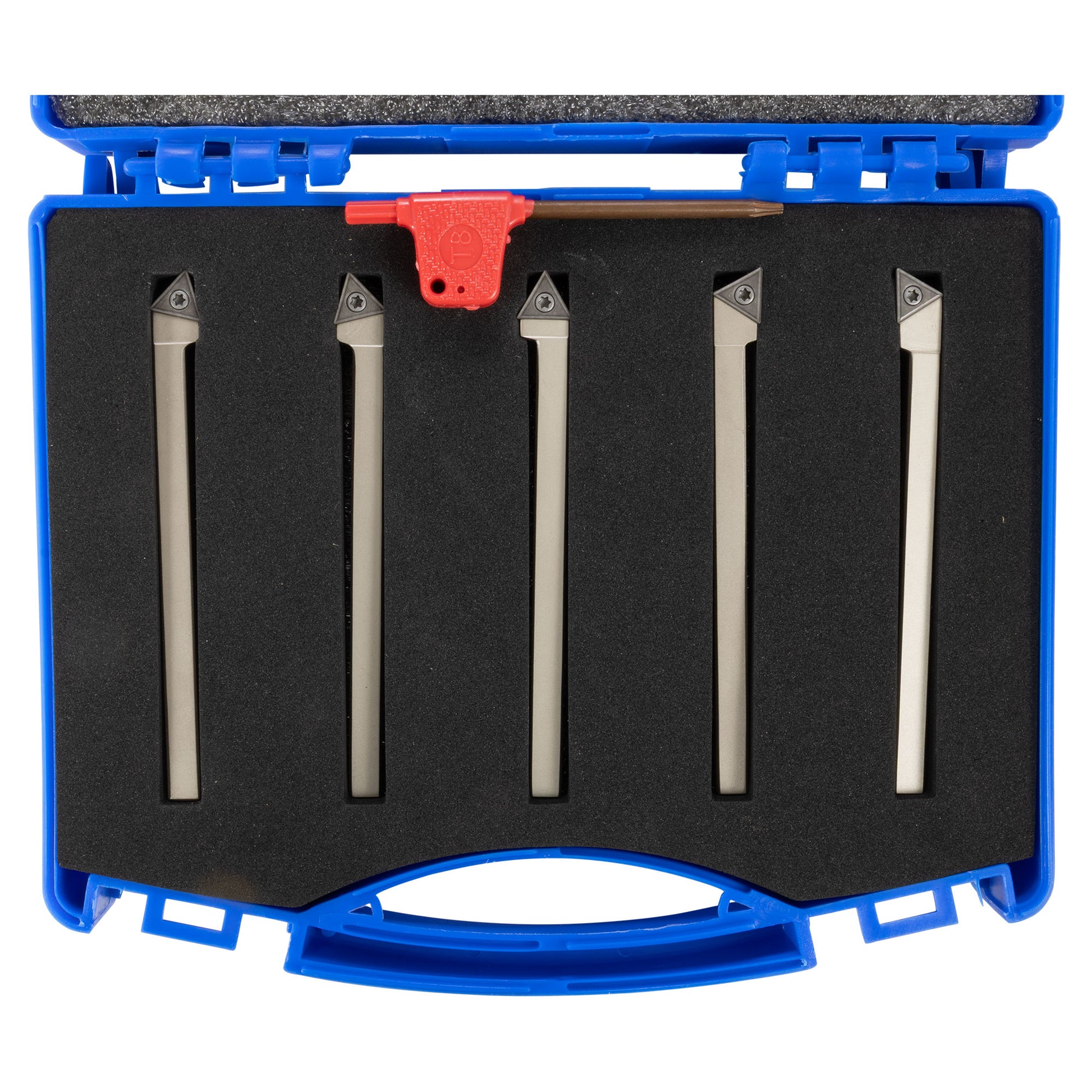

  • 5 piece turning tool set
  • 1/2" square shank
  • Includes 5 TCMT carbide inserts with TiN coating
  • Set suitable for external turning and end turning
  • Set comes in plastic case

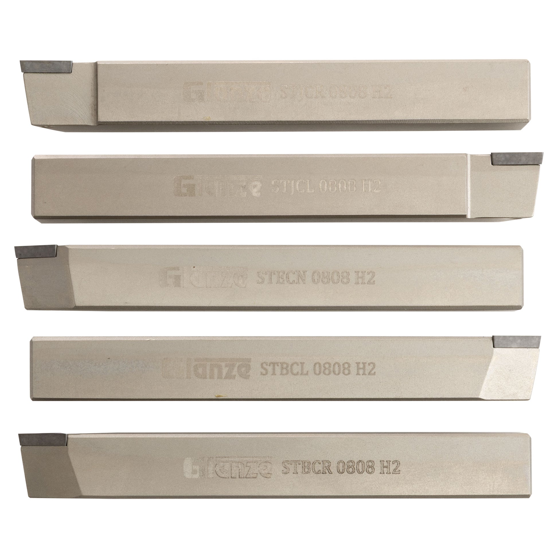

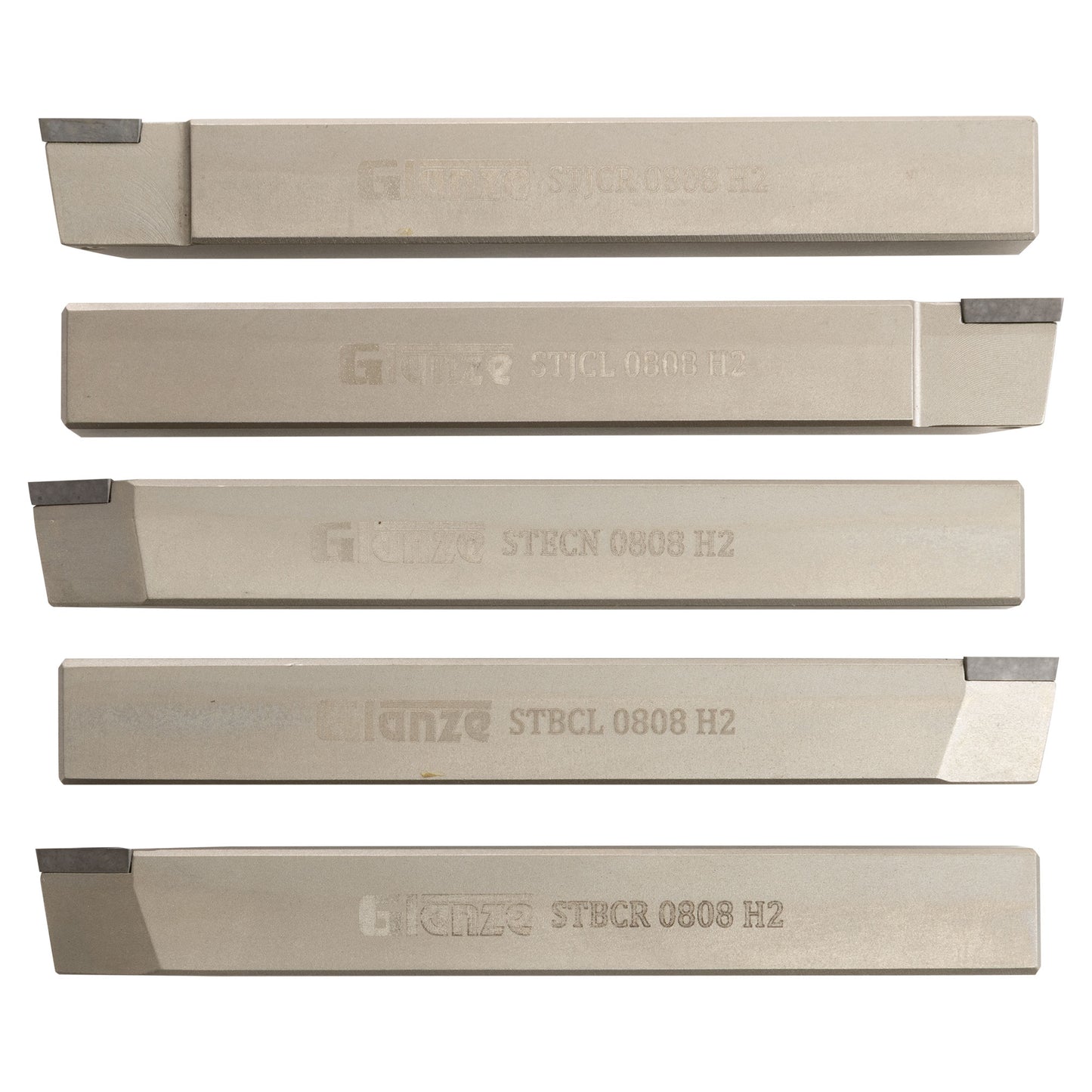

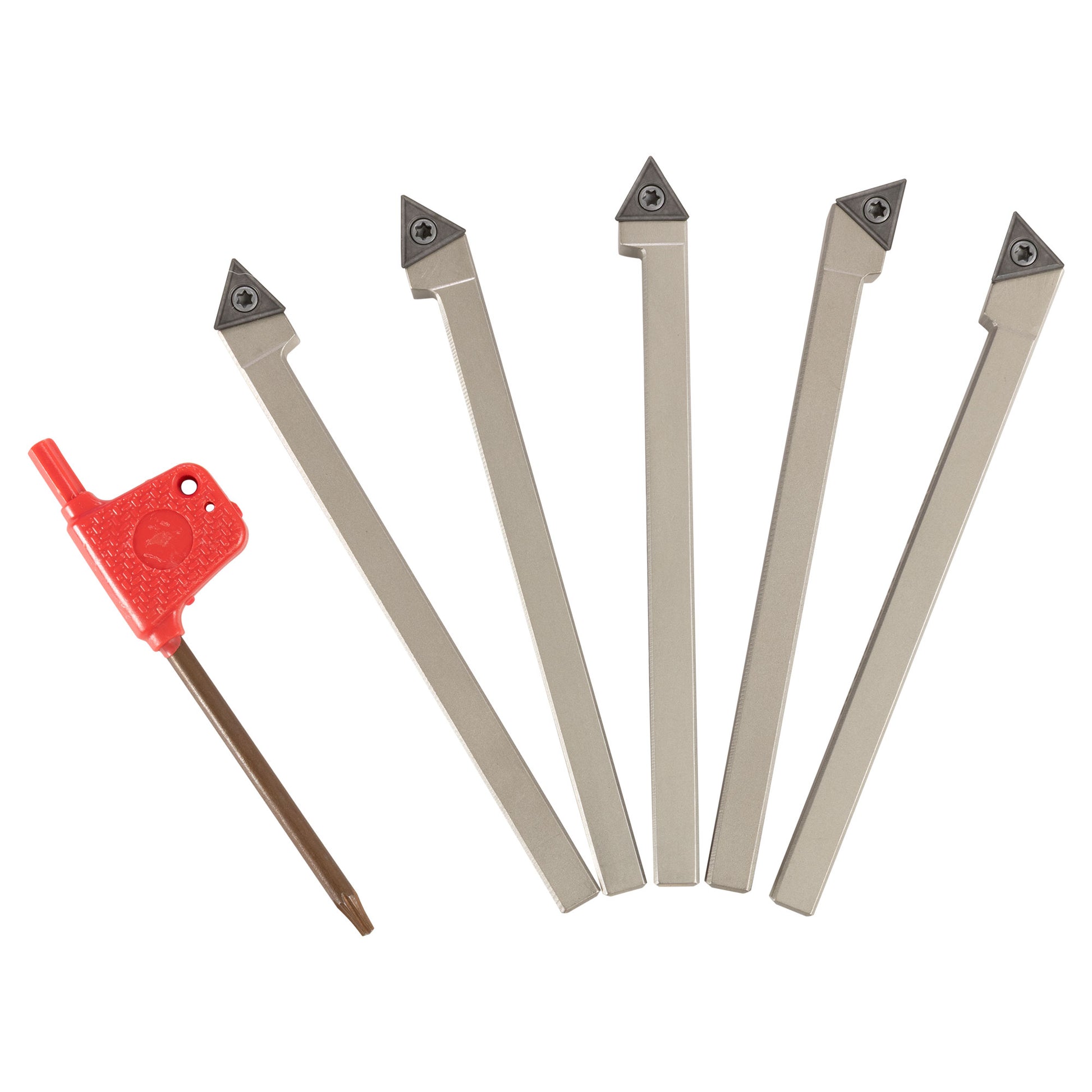

1/2" 5 Piece Indexable Turning Tool Set. Set comes with 5 turning tool holders, fitted with replaceable tungsten carbide tips (TCMT 21.5) for superior surface finish and long tool life. Tools have silver finish.
The set allows for a variety of operations, left and right hand turning, facing, and chamfering at a variety of angles.

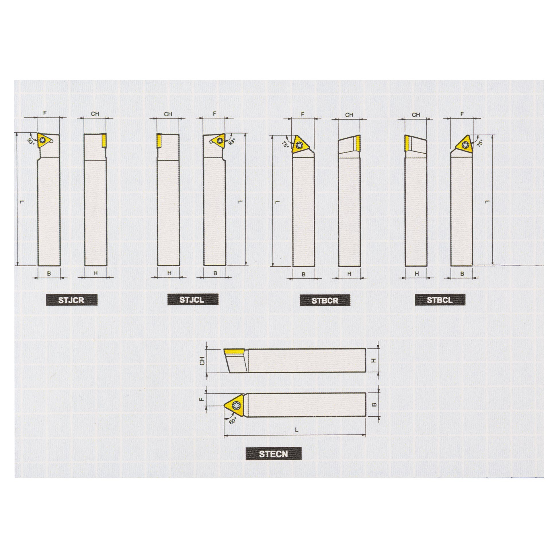

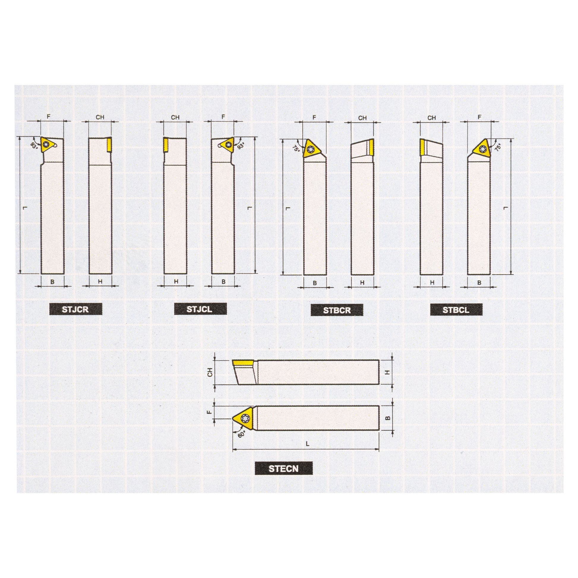

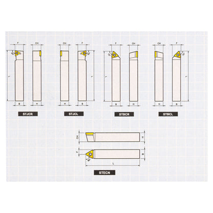

  • STJCR – For turning outside diameter and shoulder face at 90⁰ from RH side with 93⁰ approach angle for turning and 27⁰ approach angle for facing and corner relieves required for grinding.
  • STJCL – For turning outside diameter and shoulder face at 90⁰ from LH side with 93⁰ approach angle for turning and 27⁰ approach angle for facing and corner relieves required for grinding.
  • STECN – For turning 60⁰ “V” tool for recess, grooves, and 60⁰ chamfer on both RH/LH sides
  • STBCR – For turning 75⁰ through diameter from RH side with 75⁰ approach angle and for 45⁰ chamfer from LH side.
  • STBCL - For turning 75⁰ through diameter from LH side with 75⁰ approach angle and for 45⁰ chamfer from RH side.
Turning tools come in a plastic case and come with the necessary Torx key. Replacement screw size is M2.5 X T8.
