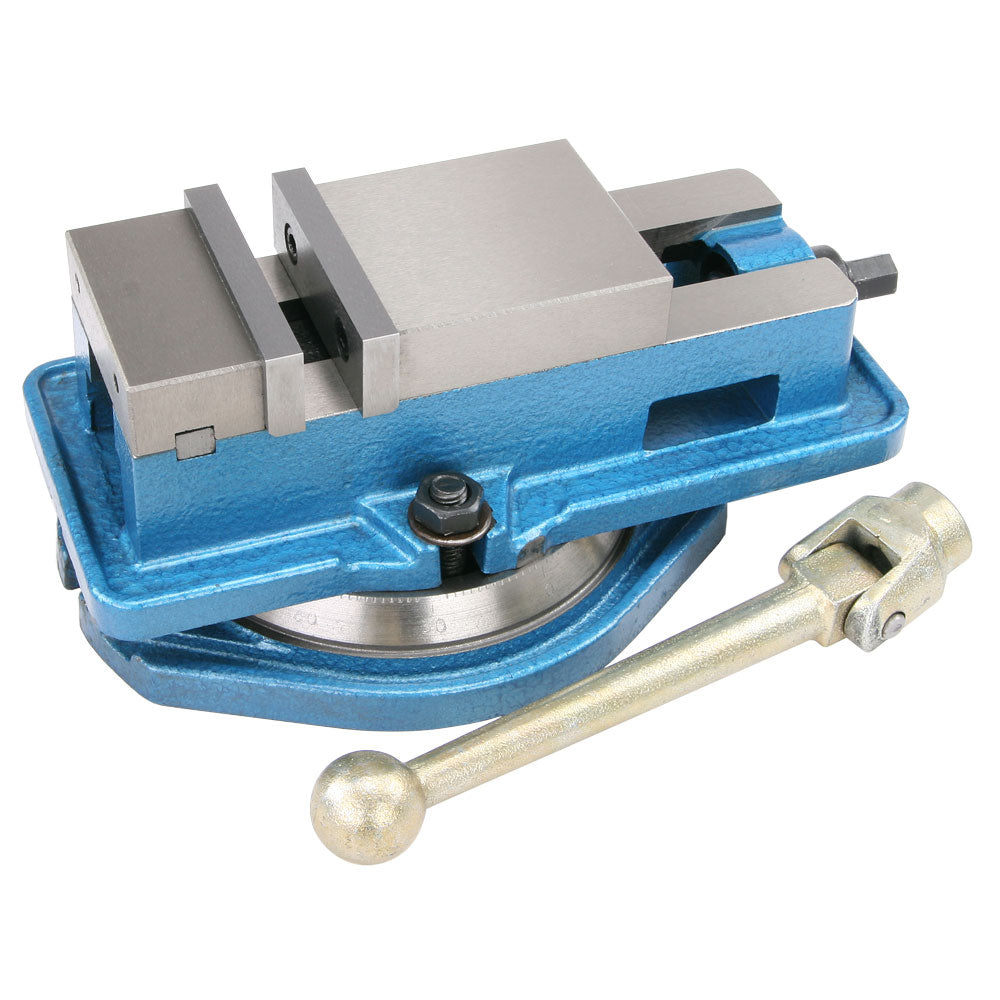

  • Ground and hardened jaws
  • Detachable swivel base with 360-degree rotation
Precision 3" Kurt-style milling vise with swivel base. The top, bottom of vise bed, gib, swivel base, and all plate mounting surfaces are hardened and ground.
The jaws of this precision milling vise are hardened and ground.
  • Jaw width 3.15" (80 mm)
  • Jaw depth 0.93" (23.5 mm)
The detachable swivel base allows 360 degree rotation of the vise.
Make sure to read WHAT MAKES A GOOD VISE before choosing.
For a comparison of our Precision Milling Vises click HERE
Jaw width: 3.150" (80 mm)
Jaw depth: 0.925" (23.5 mm)
Maximum jaw opening: 2.835" (72 mm)
Swivel base: YES
Weight: 18.9 lbs (9 kg)
Height with base: 3.937" (100 mm)
Height w/o base: 2.913" (74 mm)
Length: 10.236" (260 mm)
Width with base: 7.283" (185 mm)
Width w/o base: 5.315" (135 mm)
Mounting bolt centers: 6.496" (165 mm)
Mounting bolt centers w/o base: 4.134" (105 mm)
Hold-down mechanism: YES
