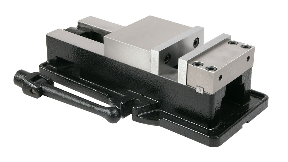

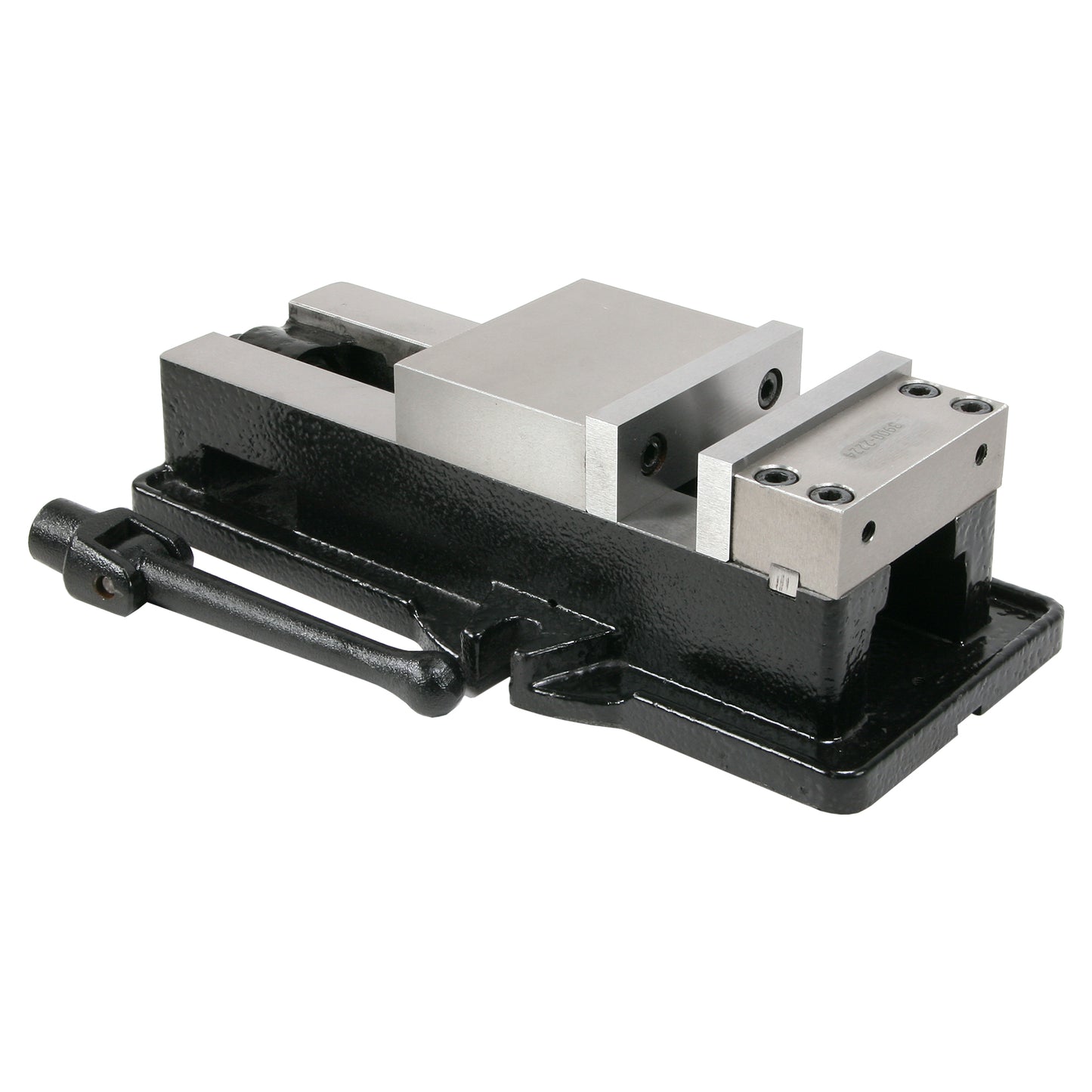

4" High quality Kurt-style milling vise with large anvil area. Top, gib, jaws, bottom of vise bed and all plate mounting surfaces are hardened and precision ground. The angle tight positive locking style and wide jaw opening allows for holding a large array of workpieces securely and generates 30% more downward locking force.
The jaws are made to American standard dimensions (interchangeable with Kurt and supporting numerous soft jaw and jaw replacement options) and provide a flat and parallel gripping surface that ensures accurate and consistent clamping.
  • The jaws are 4" wide, 1.27" deep and open 5.5".
  • The jaws are perpendicular to the ways within 0.002" in 4".
The jaws can be mounted on either end of the fixed and movable jaw providing a wide range of clamping distances. The fixed jaw is bolted from the top for enhanced rigidity.
Heavy swivel base vise for precision milling. Without the swivel base, the ways of the precision milling vise are parallel to the base of the vise within 0.0006" in 4".

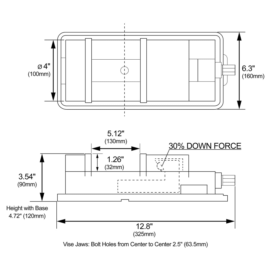

Jaw Width: 3.937" (100 mm)
Jaw Depth: 1.260" (32 mm)
Maximum Jaw Opening: 5.512" (140 mm)
Weight: 24.6 lbs (11 kg)
Height w/o Base: 3.543" (90 mm)
Length: 12.795" (325 mm)
Width w/o Base: 6.299" (160 mm)
Mounting Bolt Centers w/o Base: 5.5" (139.700 mm)
Hold-Down Mechanism: YES
Ways Parallel to Bottom of Vise Within: 0.0006" in 4" (0.015 mm in 100 mm)
Jaws Perpendicular to Ways Within: 0.0012" in 4" (0.030 mm in 100 mm)
