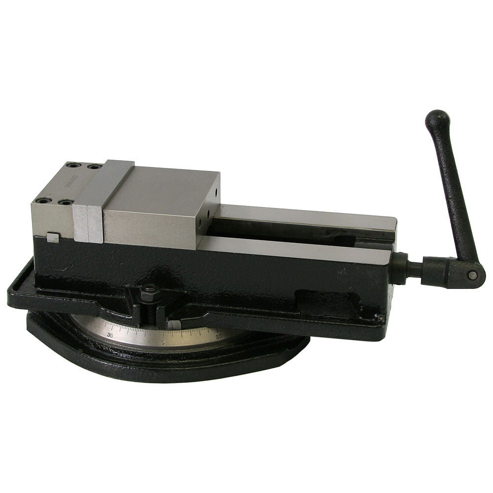

  • Top, bottom of vise bed, gib, jaws, swivel base, and all plate mounting surfaces are hardened and ground
  • Fixed jaw is bolted for enhanced rigidity
  • 30% Downward Locking Force

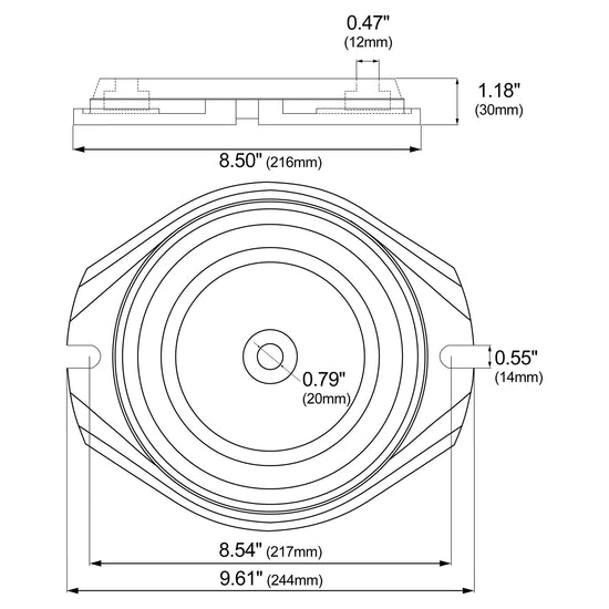

  • Detachable swivel base features easy to read divisions
4" High quality Kurt-style milling vise with large anvil area. Top, gib, jaws, bottom of vise bed and all plate mounting surfaces are hardened and precision ground. The angle tight positive locking style and wide jaw opening allows for holding a large array of workpieces securely and generates 30% more downward locking force.
The jaws are made to American standard dimensions (interchangeable with Kurt) and provide a flat and parallel gripping surface that ensures accurate and consistent clamping.

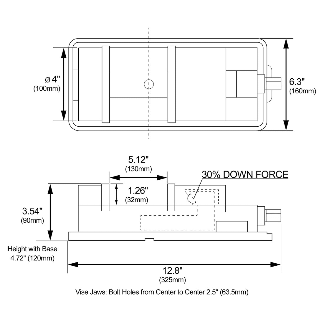

  • The jaws are 4" wide, 1.27" deep and open 5.5".
  • The jaws are perpendicular to the ways within 0.002" in 4".
The jaws can be mounted on either end of the fixed and movable jaw providing a wide range of clamping distances. The fixed jaw is bolted from the top for enhanced rigidity.
Heavy swivel base vise for precision milling. With the base, the vise is 9.7" wide, 13.4" long, and 4.75" high.
Without the swivel base, the ways of the precision milling vise are parallel to the base of the vise within 0.0006" in 4".  With the swivel base installed, the ways of the vise are parallel to the base of the vise within 0.0008" in 4".

Weight: 35 lbs (16 kg)
Height with Out Base: 3.46" (87.884 mm)
Length: 13.4" (340.360 mm)
Hold-Down Mechanism: YES
Ways Parallel to Bottom of Vise Within: 0.0006" in 4" (0.015 mm in 100 mm)
Ways Parallel to Bottom of Swivel Base Within: 0.0008" in 4" (0.020 mm in 100 mm)
Jaws Perpendicular to Ways Within: 0.0020" in 4" (0.050 mm in 100 mm)
