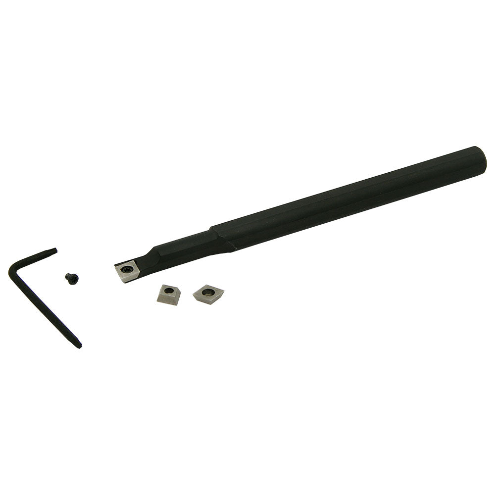

  • 3/8" diameter, 5" long boring bar
  • 3 CEMW-21.5.5 high speed steel inserts
  • 1 extra Torx screw
  • 1 wrench

Overall Length: 5.0" (127.000 mm)
Minimum Bore: .330
Lead Angle: 5°
Insert Relief: 20°
IC: .250" (6.350 mm)
Insert Thickness: .093" (2.362 mm)
Insert Hole: .110" (2.794 mm)
Insert Top Opening: .146" (3.708 mm)
Insert Radius: .008" (0.203 mm)
Screws: CO-2205 S
Wrench: T-7
