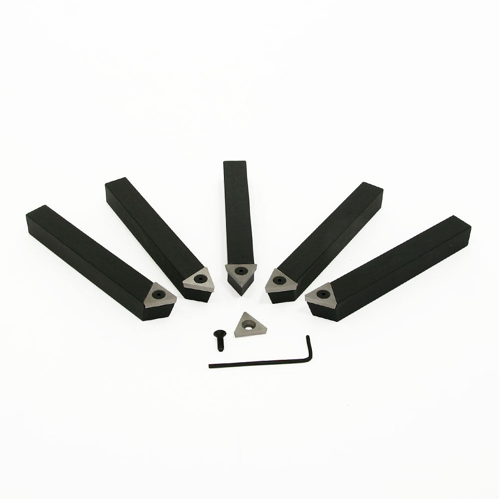

- 5 metal turning tools 1/2" shank, 4" overall length
- Tool styles are AR, AL, BR, BL, & E
- 6 turning inserts, TPMB-322
- 6 screws
- 1 - 1/16" Allen wrench
This Arthur R. Warner Co. precision tool holder kits use high speed steel or carbide inserts. These are production quality tool holders that are made in the USA. LEARN MORE
The kit contains the following:
5 1/2" indexable turning tool bars and shank 4 inches overall length
6 Turning Inserts: T-15 High Speed Steel TPMB-322 (TD6P)
6 4-40FH screws and one 1/16" hex wrench.
The TPMB322 insert:
Relief : 11 degree
IC: 0.375 inch
Thickness: .125 inch
Hole: 0.150 inch Top opening: 0.250 inch
Radius: 0.031 inch
Each tool holder is a different style. There is one each of the following:
Style AR right hand tool
Style BR right hand tool with a 15° lead angle
Style E Neutral threading tool with 60° included angle
Style BL left hand tool with a 15° lead angle
Style AL left hand tool
