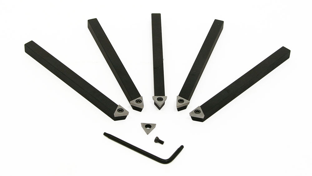

- 5 piece turning tool set
- 1/4" square shank 3.5" overall length
- 6 screws included
- T-7 wrench
- TPMW1.81.51 HSS inserts
This Arthur R. Warner Co. precision tool holder kits use high speed steel or carbide inserts. These are production quality tool holders that are made in the USA. LEARN MORE
The kit contains the following:
5 bars 1/4 inch shank 3.50 inches overall length
6 T-15 HSS TPMW1.81.51 Inserts
Relief : 11 degree, IC: 0.218 inch, Thickness: 0.093 inch, Hole: 0.110 inch Top opening: 0.146 inch at 60 degrees, Radius: 0.015 inch
Screws: (6) CO-2205
Wrench: T-7
