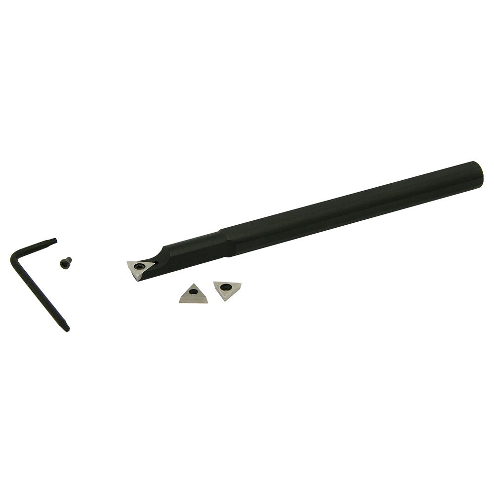

- 3/8" diameter, 5" long boring bar with TPMW-1.81.5.5 insert
- 2 extra TPMW-1.81.5.5 high speed steel inserts
- 1 extra Torx screw
- 1 wrench

Overall Length: 5.0" (127.000 mm)
Minimum Bore: .520" (13.208 mm)
Lead Angle: 0°
Back Rake: 3°
Insert Relief: 11°
Ic: .218" (5.537 mm)
Insert Thickness: .093" (2.362 mm)
Insert Hole: .100" (2.540 mm)
Insert Top Opening: .130" (3.302 mm)
Insert Radius: .008" (0.203 mm)
Screws: CO-2205 S
Wrench: T-7
