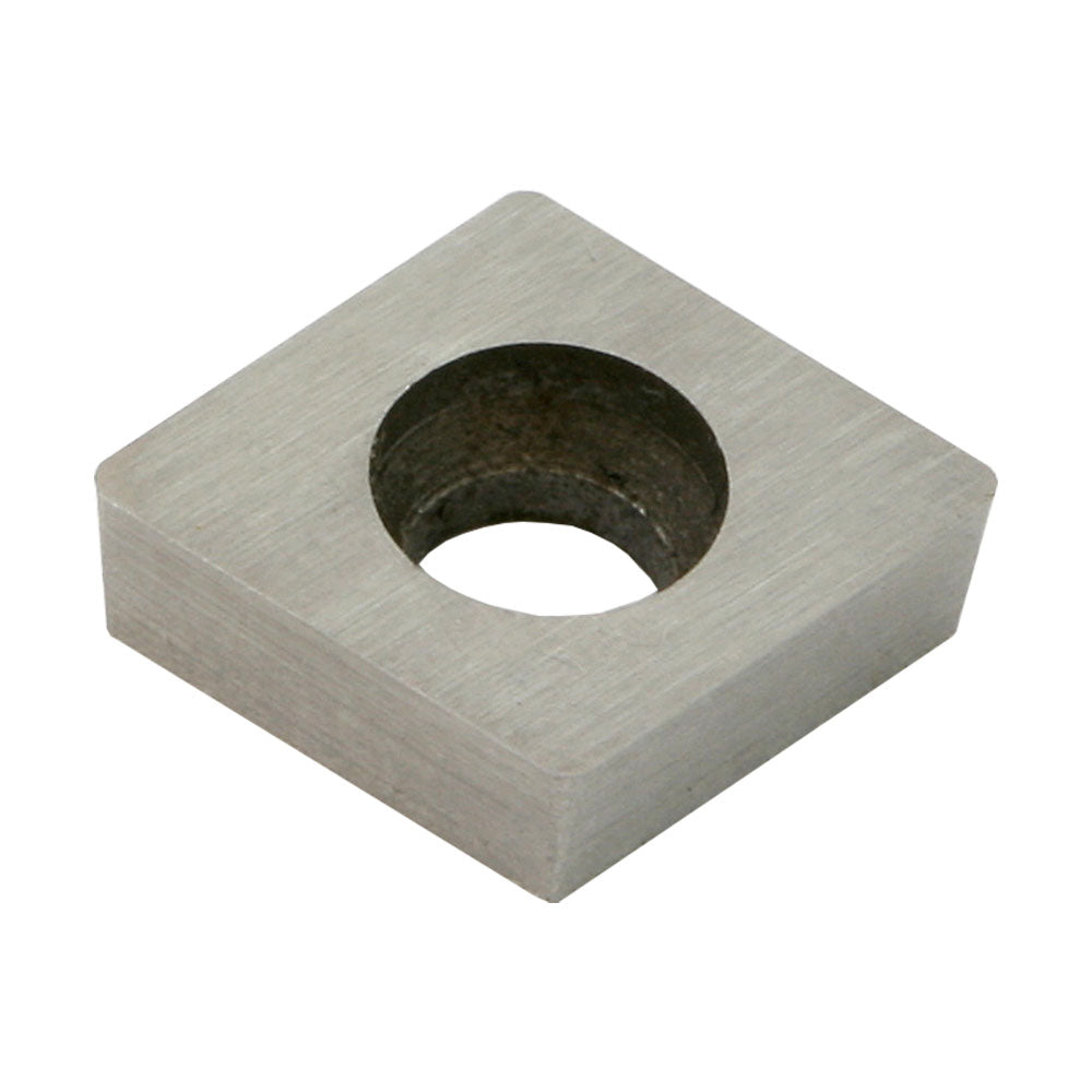

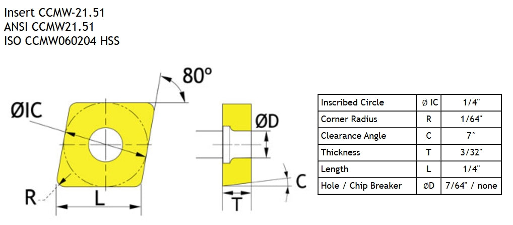

- T-15 high speed steel
- 80° diamond, 7° relief
- 40°-60° single countersink, no chip breaker
- 0.0156" (1/64") corner radius
- ANSI: CCMW21.51, ISO: CCMW060204 HSS
CCMW-21.51 insert made from T-15 high speed steel, combine the advantages of high-speed steel cutting tools with the convenience of indexable tooling.
Insert is a 80° diamond with a 7° relief. The center hole is a 40°-60° single countersink, and there is no chip breaker.
It has an inscribed circle (IC) of 0.25" (1/4"), a thickness of 0.094" (3/32"), and a corner (nose) radius of 0.0156" (1/64").
The insert is designated CCMW21.51 (ANSI) or CCMW060204 HSS (ISO).
This high-quality insert is made in America by the Arthur R Warner company.
