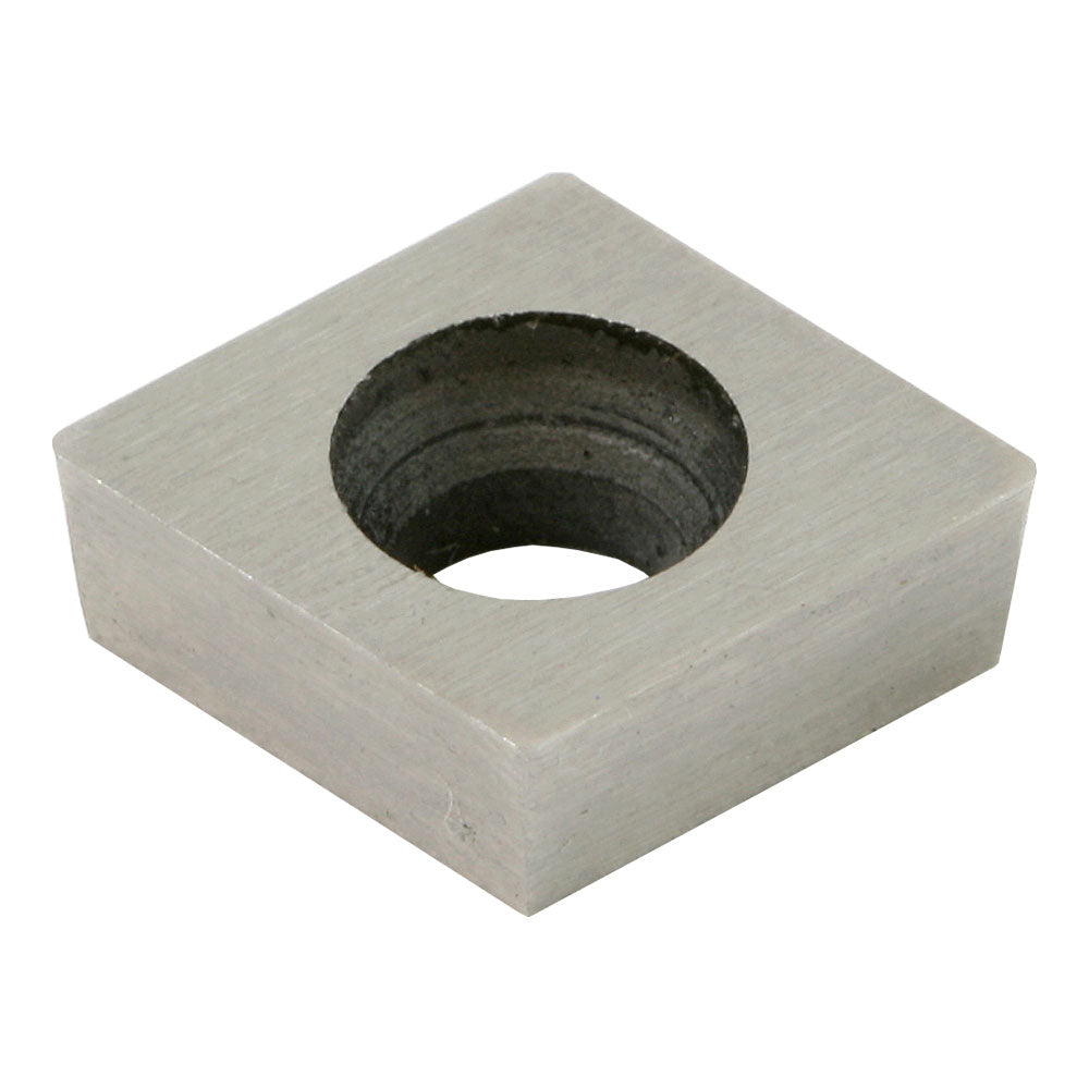

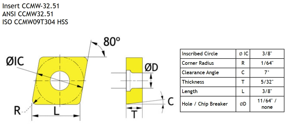

- T-15 high speed steel
- 80° diamond, 7° relief
- 40°-60° single countersink, no chip breaker
- 0.0156" (1/64") corner radius
- ANSI: CCMW32.51, ISO: CCMW09T304 HSS
CCMW-32.51 insert made from T-15 high speed steel, combine the advantages of high speed steel cutting tools with the convenience of indexable tooling.
Insert is a 80° diamond with a 7° relief. The center hole is a 40°-60° single countersink, and there is no chip breaker.
It has an inscribed circle (IC) of 0.375" (3/8"), a thickness of 0.156" (5/32"), and a corner (nose) radius of 0.0156" (1/64").
The insert is designated CCMW32.51 (ANSI) or CCMW09T304 HSS (ISO).
