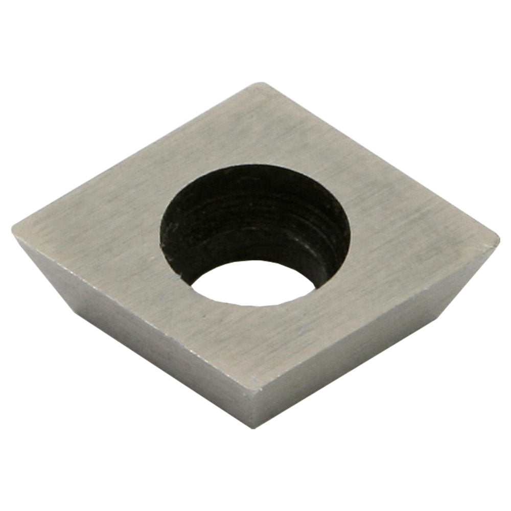

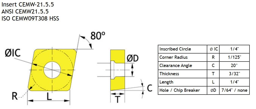

- T-15 high speed steel
- 80° diamond, 20° relief
- 40°-60° single countersink, no chip breaker
- 0.008" (1/125") corner radius
- ANSI: CEMW21.5.5, ISO: CEMW09T308 HSS
CEMW-2-1.5.5 insert made from T-15 high speed steel, combine the advantages of high speed steel cutting tools with the convenience of indexable tooling.
Insert is a 80° diamond with a 20° relief. The center hole is a 40°-60° single countersink, and there is no chip breaker.
It has an inscribed circle (IC) of 0.25" (1/4"), a thickness of 0.094" (3/32"), and a corner (nose) radius of 0.008" (1/125").
The insert is designated CEMW21.5.5 (ANSI) or CEMW09T308 HSS (ISO).
