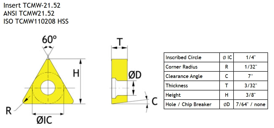

- T-15 high speed steel
- 60° triangle, 7° relief
- 40°-60° single countersink, no chip breaker
- 0.0313" (1/32") corner radius
- ANSI: TCMW21.52, ISO: TCMW110208 HSS

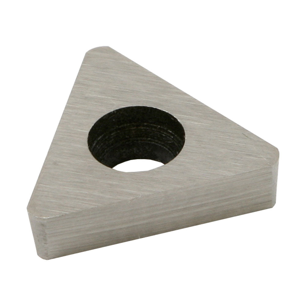

TCMW-21.52 insert made from T-15 high speed steel, combine the advantages of high speed steel cutting tools with the convenience of indexable tooling.
Insert is a 60° triangle with a 7° relief. The center hole is a 40°-60° single countersink, and there is no chip breaker.
It has an inscribed circle (IC) of 0.25" (1/4"), a thickness of 0.094" (3/32"), and a corner (nose) radius of 0.0313" (1/32").
The insert is designated TCMW21.52 (ANSI) or TCMW110208 HSS (ISO).
This high-quality insert is made in America by the Arthur R Warner company.
