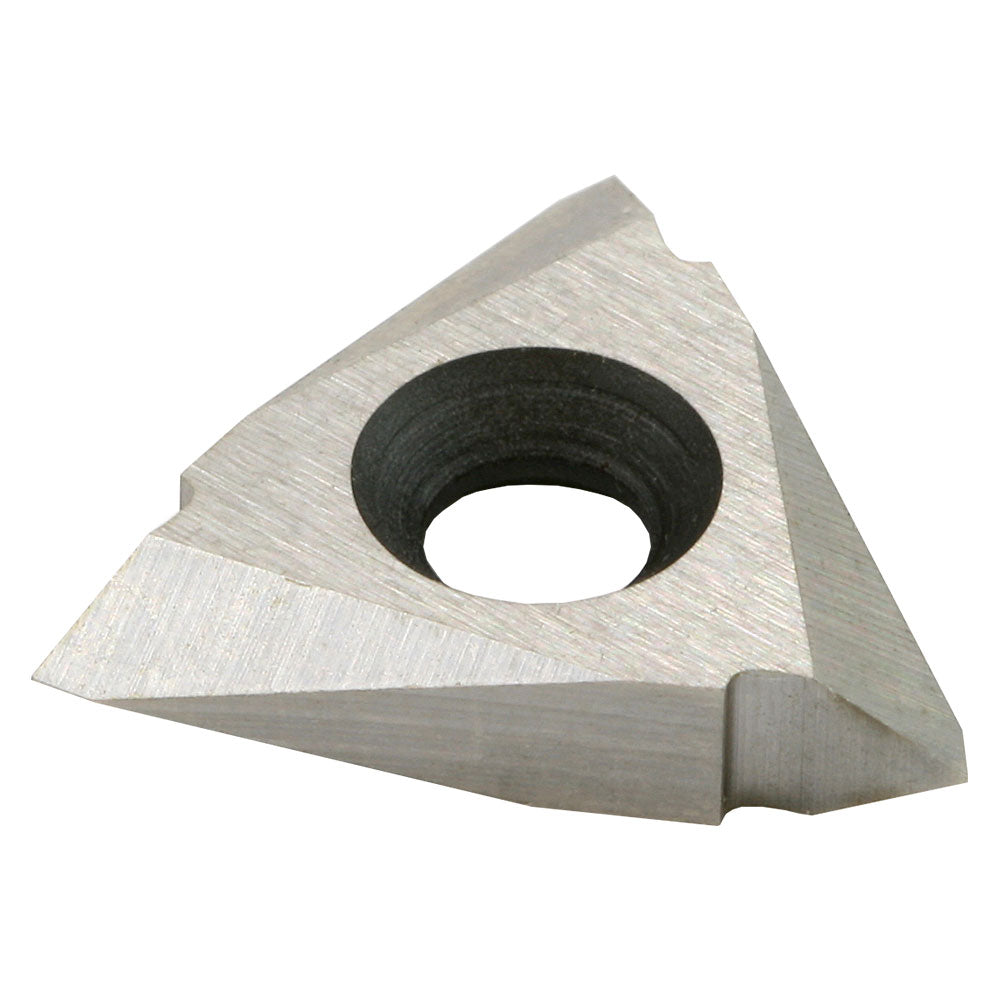

- T-15 High Speed Steel
- Triangle 60° Thread Angle, 11° Relief Angle
- 0.150" hole with 82° Double Countersink
- 10° Back Rake Angle
- 0.375" (3/8") IC, 0.125" (1/8") Thickness
These TNMC-32-NV inserts are made from T-15 high speed steel. Combine the advantages of high-speed steel cutting tools with the convenience of indexable tooling.
The insert has a 60 degree thread angle with an 11 degree relief angle, and a 10 degree back rake angle. The center hole is 0.150" with an 82 degree double countersink.
The inside circumference (IC) is 3/8" (0.375") and the thickness is 1/8" (0.125").
There is no chip breaker on this insert.
