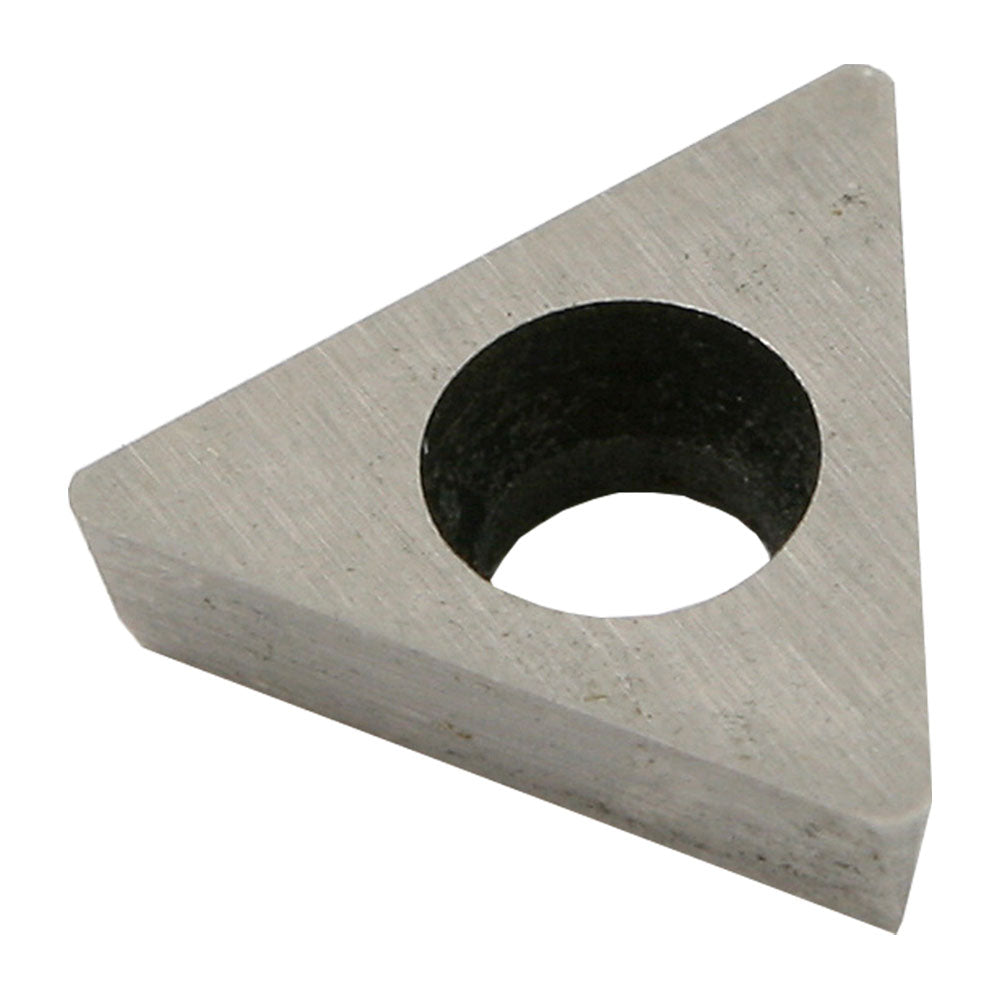

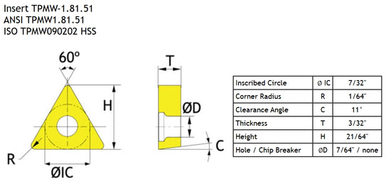

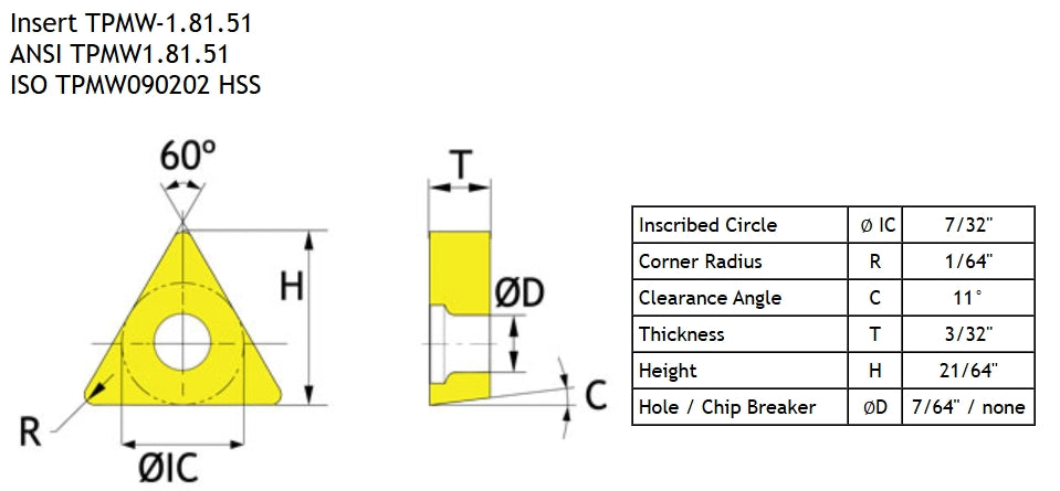

- T-15 high speed steel
- 60° triangle, 11° relief
- 40°-60° single countersink, no chip breaker
- 0.0156" (1/64") corner radius
- ANSI: TPMW1.81.51, ISO: TPMW090202 HSS
TPMW-1.81.51 insert made from T-15 high speed steel, combine the advantages of high-speed steel cutting tools with the convenience of indexable tooling.
Insert is a 60° triangle with a 11° relief. The center hole is a 40°-60° single countersink, and there is no chip breaker.
It has an inscribed circle (IC) of 0.21875" (7/32"), a thickness of 0.094" (3/32"), and a corner (nose) radius of 0.0156" (1/64").
The insert is designated TPMW1.81.51 (ANSI) or TPMW090202 HSS (ISO).
