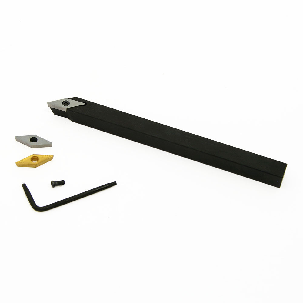

- 3/8" square, 6" long profiling tool
- Includes 2 HSS (VCMW-221) inserts
- Includes 1 carbide (VCMT-221) insert
- 2 MS-1153 screws
- 1 T-7 torx wrench
This Arthur R. Warner Co. precision profiling tool uses high speed steel or carbide inserts. Combine the advantages of high speed steel cutting tools with the convenience of indexable tooling.
This profiling tool is great for CNC applications, and can be used for most of your turning needs.
Contents:
1 Right Hand bar 3/8 inch shank 6.0 inches overall length, side angle: 3 degree
2 Inserts T-15 High Speed Steel VCMW-221
Relief : 7 degree, IC: 0.250 inch, Thickness: 0.125 inch, Hole: 0.110 inch, Top opening: 0.146 inch, Radius: 0.015 inch
1 Insert Carbide VCMT-221
Relief : 7 degree, IC: 0.250 inch, Thickness: 0.125 inch, Hole: 0.110 inch Top opening: 0.146 inch, Radius: 0.015 inch
Screws: (2) MS-1153
Wrench: T-7
