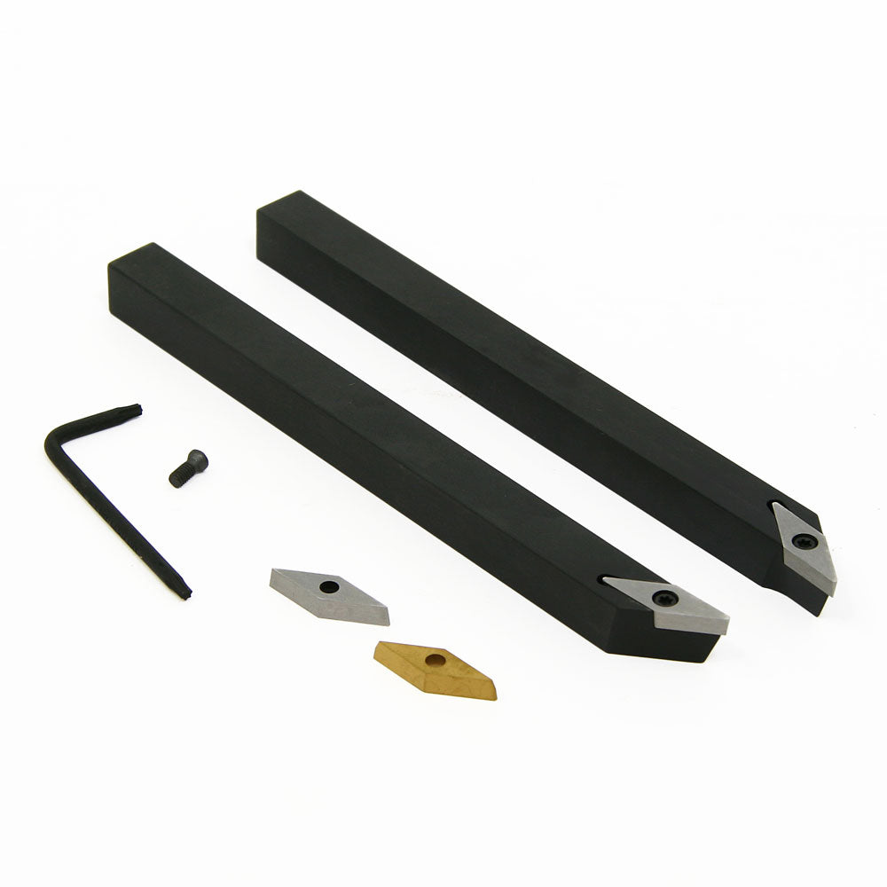

- 3/8" Square shank Right Hand profiling tool, 6" overall length
- 3/8" Square shank Left Hand profiling tool, 6" overall length
- Includes 3 HSS (VCMW-221) inserts
- Includes 1 carbide (VCMT-221) insert
- 1 extra MS-1153 Torx screw, 1 T-7 wrench
This Arthur R. Warner Co. precision tool holder kits use high speed steel or carbide inserts. These are production quality tool holders that are made in the USA. LEARN MORE
This profiling tool is great for CNC applications, and can be used for most of your turning needs.
Contents:
1 Right Hand bar 3/8 inch shank, 6 inch overall length, Side angle: 3 degrees
1 Left Hand bar 3/8 inch shank, 6 inch overall length, Side angle: 3 degrees
3 Inserts T-15 High Speed Steel VCMW221, Relief : 7 degrees, IC: 0.250 inch, Thickness: 0.125 inch, Hole: 0.110 inch, Top opening: 0.146 inch, Radius: 0.015 inch
1 Insert Carbide VCMT221, Relief : 7 degree, IC: 0.250 inch, Thickness: 0.125 inch, Hole: 0.110 inch, Top opening: 0.146 inch, Radius: 0.015 inch
Screws: (3) MS-1153
Wrench: T-7
