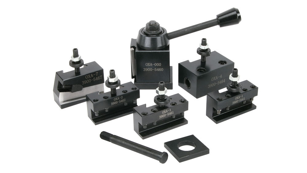

  • Fits Grizzly G0768 lathe
  • 0XA, or series 000 size (60% of AXA size)
  • Includes five tool holders
  • All steel construction
  • Includes mounting stud and spacer for G0768 lathe
This true wedge type 0XA quick change tool post set has maximum rigidity and provides chatter free performance. This is the same Premium QCTP set that comes stock on our HiTorque Mini Lathes. All working parts are hardened and ground steel. It is completely sealed for maintenance-free operation. LEARN MORE
This set includes the tool post and the following tool holders: (It will hold turning tools with shanks from 1/4" to 1/2".)
2 - #1 Turning & Facing
1 - #2 Boring, Turning & Facing
1 - #4 Heavy Duty Boring will hold both 3/8 and 1/2 boring bars
1 - #7 Universal Parting Blade @ 4-degree (for 1/2" cut-off blade)
It is the perfect size for bench lathes. The tool holders have been designed specifically to work on lathes that have limited distance from the top of the compound to the center of the lathe.
This tool post mounts on a spacer with a threaded adapter stud, which is included.
The 0XA quick change tool post and the associated tool holders were developed by Tormach and LittleMachineShop.com in cooperation. They were optimized to work with all versions of mini lathes, including 7x10, 7x12, 7x14 and 7x16 mini lathes.
This QCTP is a bolt-on accessory for the mini lathe. To mount this QCTP on other small lathes, you may have to make a bushing or re-work the center stud so that you can mount it to a smaller threaded hole. See the comparison chart of the quick-change tool post sets we carry.
The two 0XA tool posts (3112 and 3048) are the same except for the cut-off tool holder.
The 3112 has a cut-off tool holder that mounts the blade horizontally. Thus, it can be used on lathes that have only 5/8” from the top of the compound to the centerline of the lathe, like the 7x mini lathes.
The 3048 has a cut-off tool holder that mounts the blade at a 4-degree angle. It needs ¾” from the top of the compound to the centerline because of the angled cut off blade.
