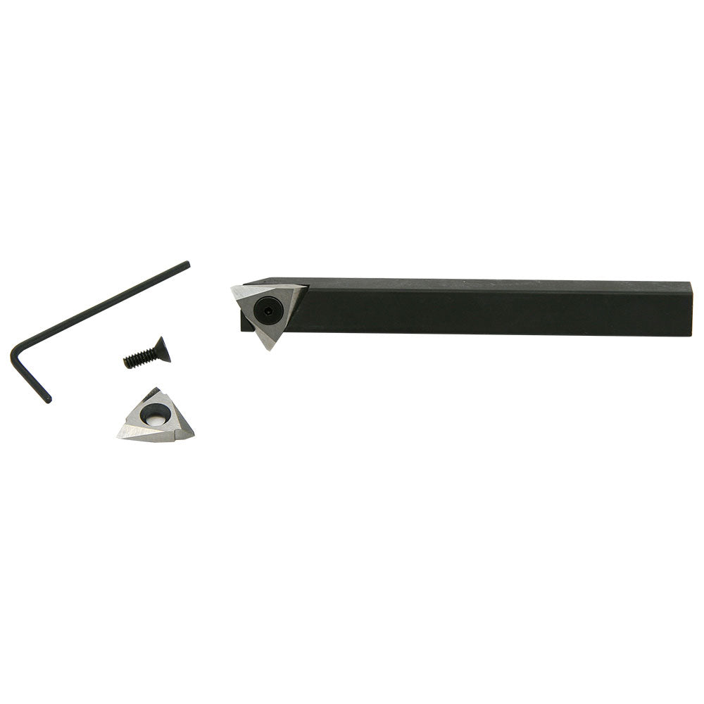

- For external threading, 8 through 36 TPI
- 3/8" shank, 3/8" IC Inserts, 5" long
- 2 HSS inserts included: TNMC-32-NV and TPMC-32-NV
- 1 extra 4-40 flat head cap screw
- 1 - 1/16" Allen wrench
This Arthur R. Warner Co. precision tool holder kits use high speed steel or carbide inserts. These are production quality tool holders that are made in the USA. LEARN MORE
This Arthur R. Warner Co. precision threading tool will turn external threads. The tool can turn from 8 through 36 pitch, 60 degree threads.
The Arthur R. Warner Co. is a family-owned American manufacturer of high speed steel products with specialization in cutting, shaping, pre-grinding, heat treating, and finish grinding of premium grades of flat high speed steel. Their quality is excellent and LittleMachineShop.com is proud to carry their products.
This tool ships with two kinds of inserts. The TPMC-32-NV insert is better in stainless and the TNMC-32-NV is better in alloy steels. You can use either for internal and external threading.
The difference is the relief angle. TPMC inserts have an 11 degree relief angle. TNMC inserts have a 0 degree relief angle.
