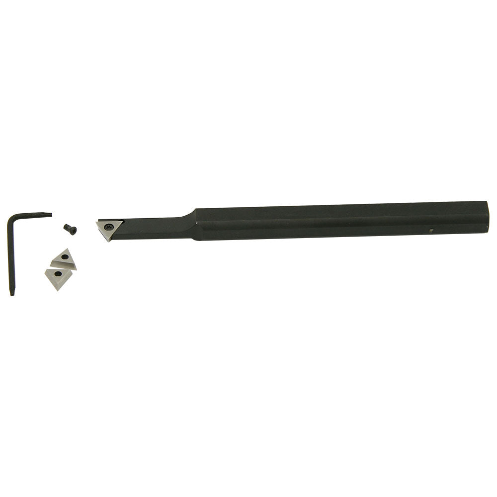

- For internal threading
- Includes three T-15 high speed steel TPMW-221 inserts
- Includes two MS-1153 screws and one T-7 wrench
This Arthur R. Warner Co. precision tool holder kits use high speed steel or carbide inserts. These are production quality tool holders that are made in the USA. LEARN MORE
This Arthur R. Warner Co. boring bar for single-point cutting internal threads has 0.5" shank and is 6" long.
Approximately 0.55" minimum hole size.
Uses TPMW-221 and TPMW-222 inserts.
The maximum thread depth is 0.100".
The Arthur R. Warner Co. is a family-owned American manufacturer of high speed steel products with specialization in cutting, shaping, pre-grinding, heat treating, and finish grinding of premium grades of flat high speed steel. Their quality is excellent and LittleMachineShop.com is proud to carry their products.
This tool ships with two kinds of inserts. The TPMC-32-NV insert is better in stainless and the TNMC-32-NV is better in alloy steels. You can use either for internal and external threading.
The difference is the relief angle. TPMC inserts have an 11 degree relief angle. TNMC inserts have a 0 degree relief angle.
