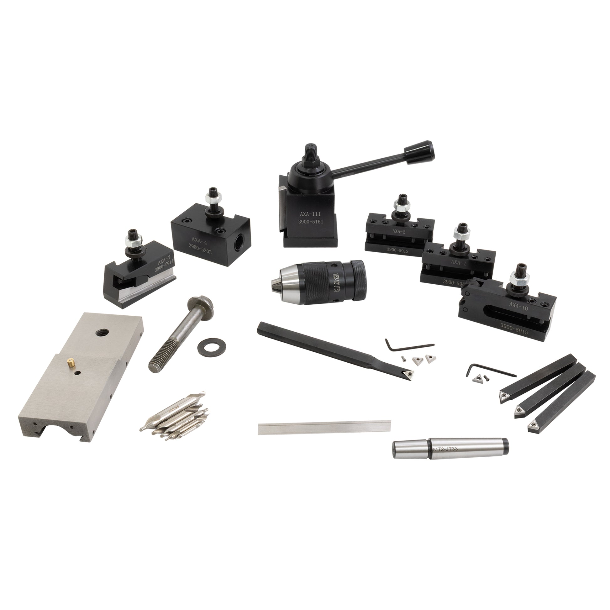

  • AXA QCTP set with post mount for SC50 lathes
  • 1/2" professional grade drill chuck
  • 2MT standard to 33JT drill chuck arbor
  • 1/2" indexable boring bar - CCMT inserts
  • 3/8" indexable TCMT carbine inserts
  • Premium P1 cut-off blade, 5 center drills
DESIGNED SPECIFICALLY TO UPGRADE HITORQUE BENCH LATHES (7600) WITH A 9" SWING TO AN AXA TOOLPOST. Current SC50 compound rest top must be swapped with the top that is included with this kit in order to mount the AXA post.
The mounting assembly includes the compound rest top (6573), oiler (1655), mounting stud (6721), and washer (6724).
This tooling package contains all the tooling you need to be productive with your lathe on the first day you own it. It works with the LittleMachineShop.com HiTorque 9x20 bench lathes as well as other SC50 lathes.
Includes an AXA (Series 100) quick change tool post set (2280). This set includes the tool post and the following tool holders:
  • 2 - #1 Turning and Facing
  • 1 - #2 Boring, Turning and Facing
  • 1 - #4 Heavy Duty Boring will hold both 5/8 and 3/4 boring bars
  • 1 - #7 Universal Parting Blade (for 1/2-inch cut-off blade - horizontal)
The quick-change tool post is made from hardened steel. No tools are required to change tools. Additional tool holders are available.
The turning tool holders accept tools up to 1/2" shank. The turning and boring tool holder accepts boring bars with up to 1/2" round shanks. The cut-off tool holder holds 1/2" tall parting blades.
This set also includes:
  • 1/2" keyless drill chuck (1660) is mounted on a 2MT arbor for the mini lathe. The rated capacity is 1/32" to 1/2". No chuck key is required with this self-tightening design. The Jacobs keyless chuck is made from hardened tool steel to ensure accuracy and extended life. Runout of this chuck is 0.005" (0.13 mm) or less. A #33 Jacobs taper arbor accompanies the chuck (2955).
  • Indexable turning tools (4132) are made by Arthur R. Warner Co. in the USA. These precision tool holder kits use carbide inserts and include three styles of tools, AR right hand, E Neutral (threading tool - 60-degree angle), and AL left hand. Kit includes three tool holders, three TCMT-21.51 inserts, one extra TCMT-21.52 carbide insert, one extra Torx screw, and one wrench.
  • 1/2" Indexable Boring Bar, 1 HSS Triangle Insert, 6" long. The minimum bore diameter for this is 0.760". The boring bar takes TPMT-222 or TPMW-222 inserts (1721). The boring bar is made by Arthur R. Warner Co. in the USA.
  • The premium P1 parting blade is 1/16" x 1/2" x 4-1/2" and made from M2 HSS by Arthur R. Warner Co. in the USA. These T-shape parting blades provide great side clearance (1728).
  • Center Drills: Five sizes combined drills and countersinks made of ground high speed M42 cobalt steel for good wear resistance. Sizes 1, 2, 3, 4, and 5 with 60-degree counter sinks (4859).
