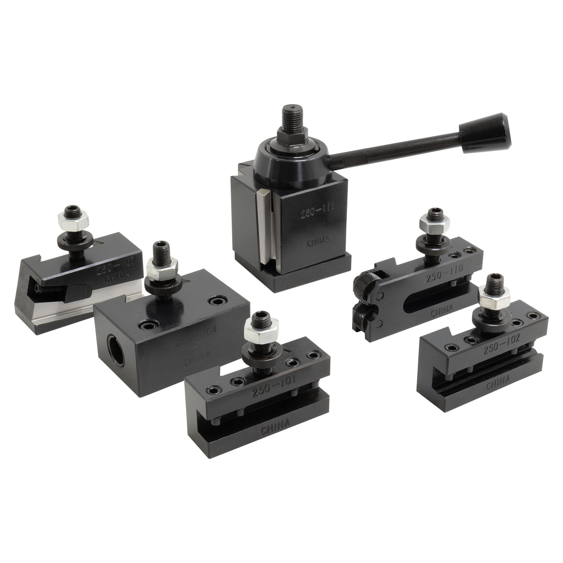

  • Quick change tool post set for lathes with up to 12" swing
  • AXA, or series 100 size
  • Tool holders interchange with Aloris, Dorian, and Phase II
  • All steel construction
  • Includes five tool holders

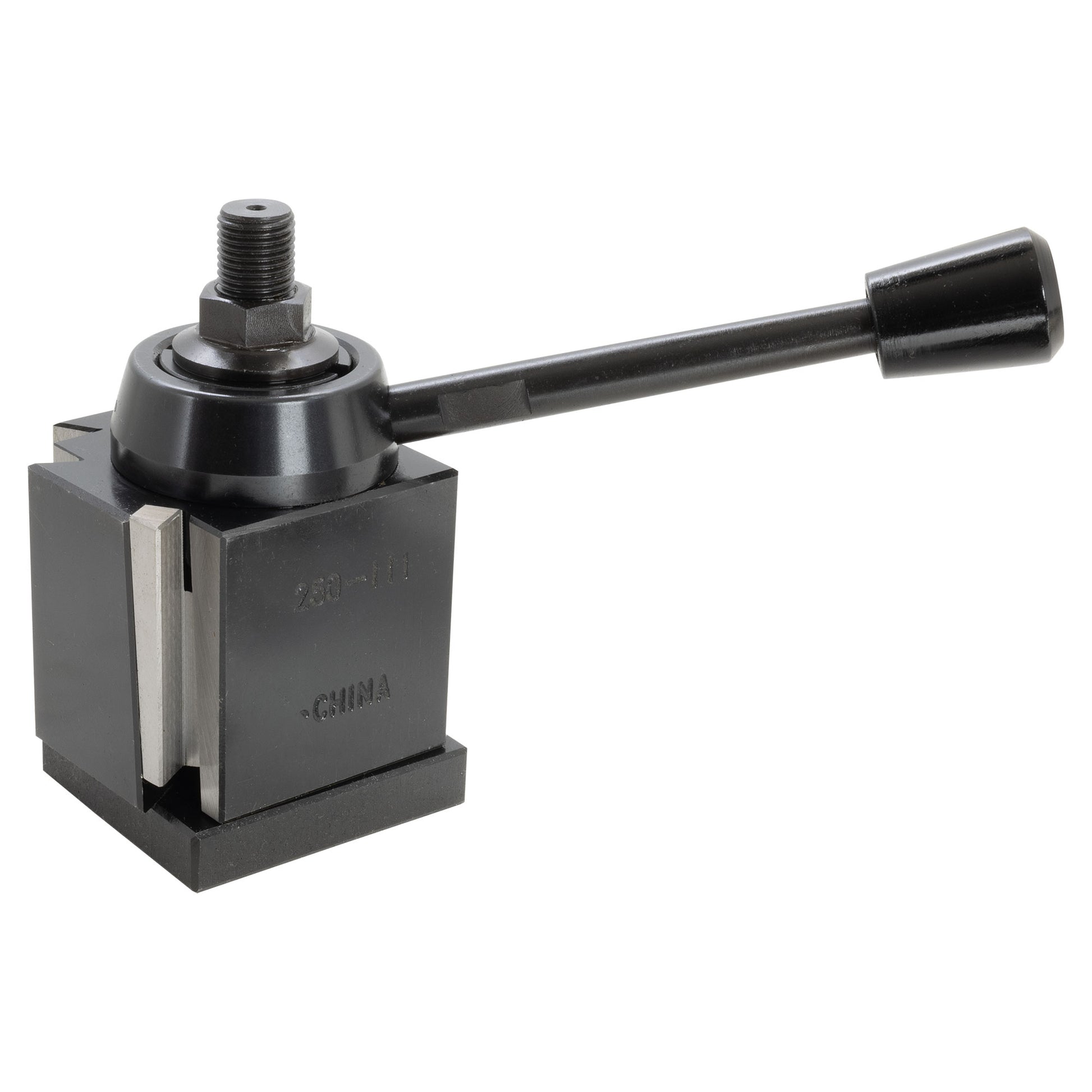

AXA, or series 100, wedge type quick change tool post set is designed for lathes with up to 12" swing.
All working parts are hardened and ground. This lathe tool post set is completely sealed for maintenance-free operation.
This lathe tool post set includes the tool post and the following tool holders:

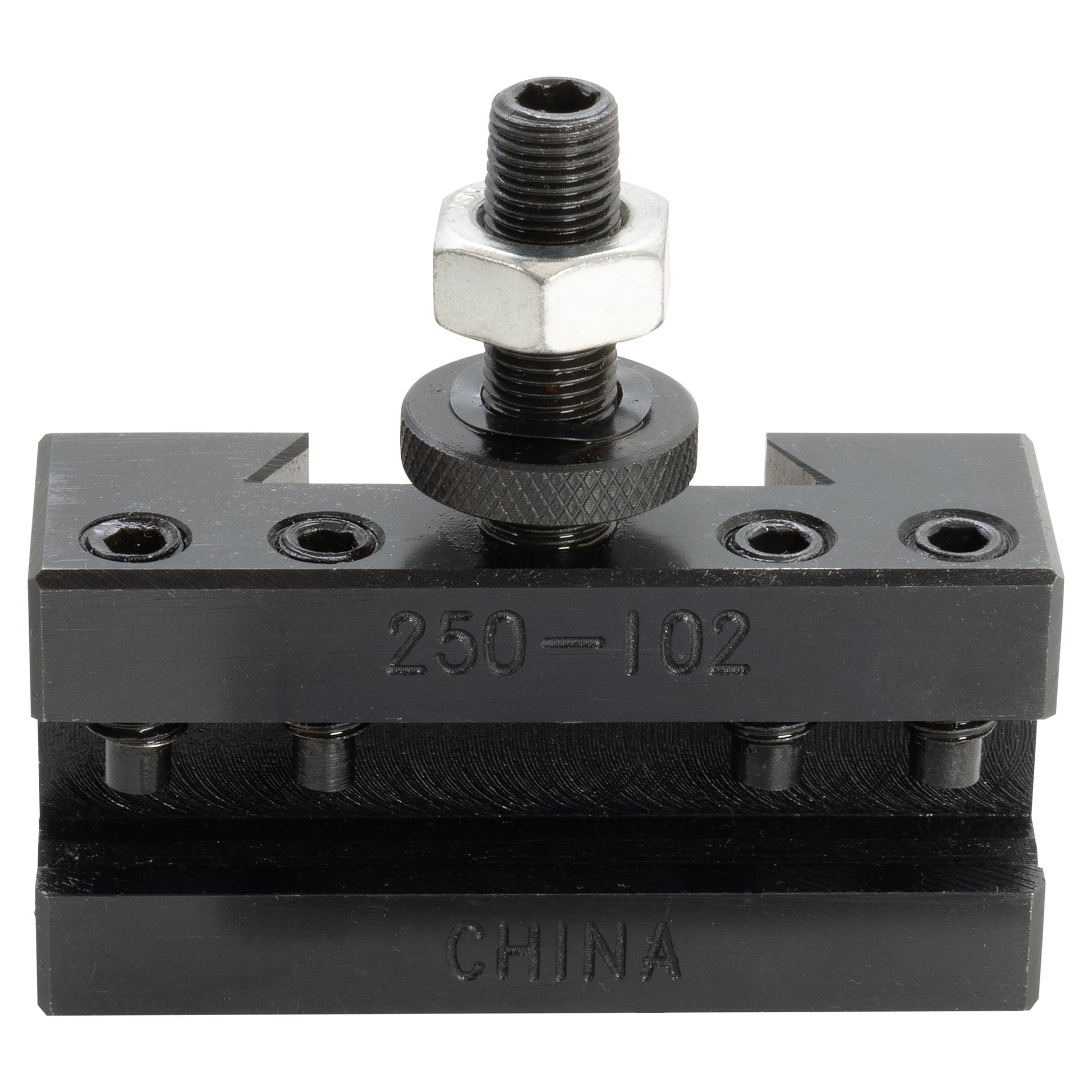

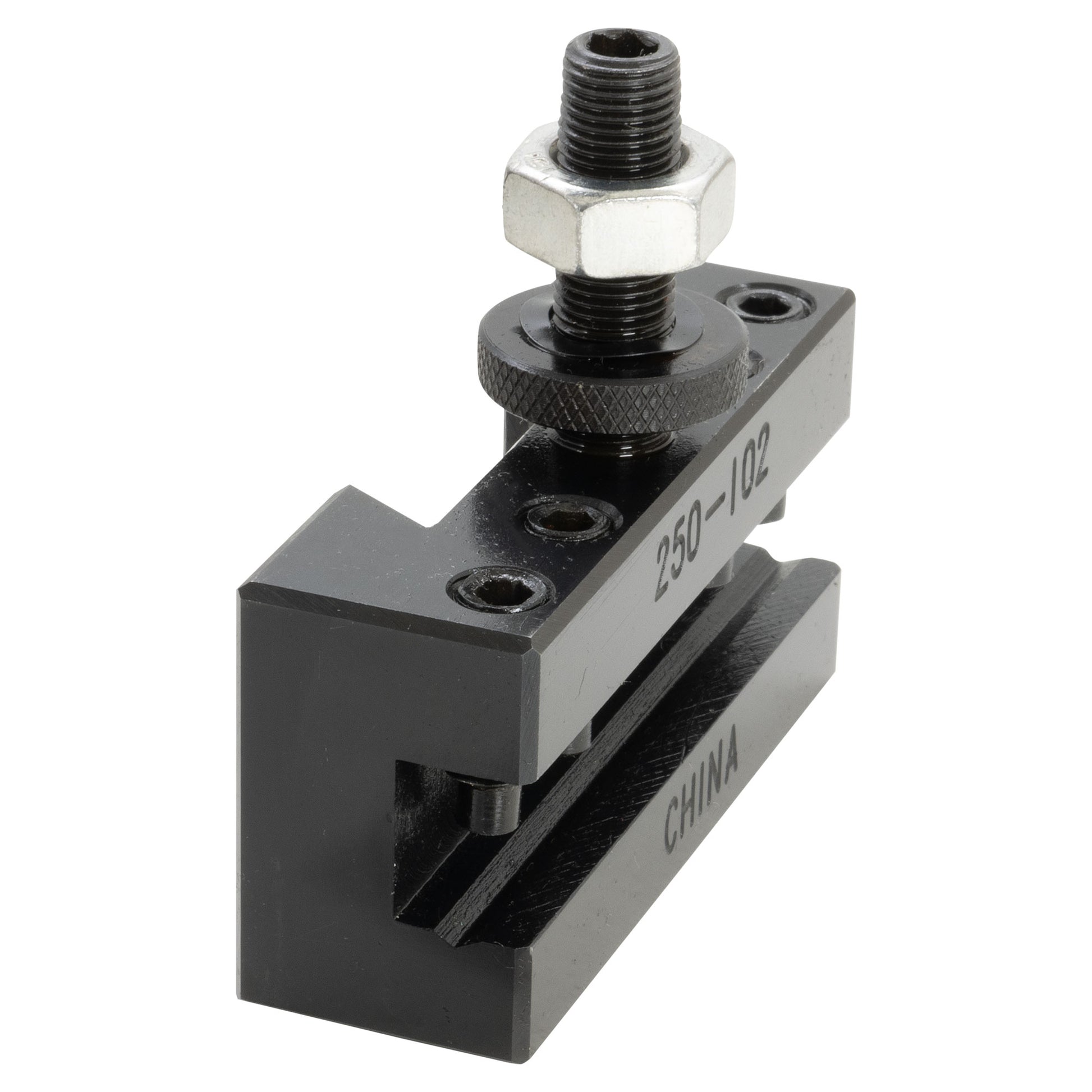

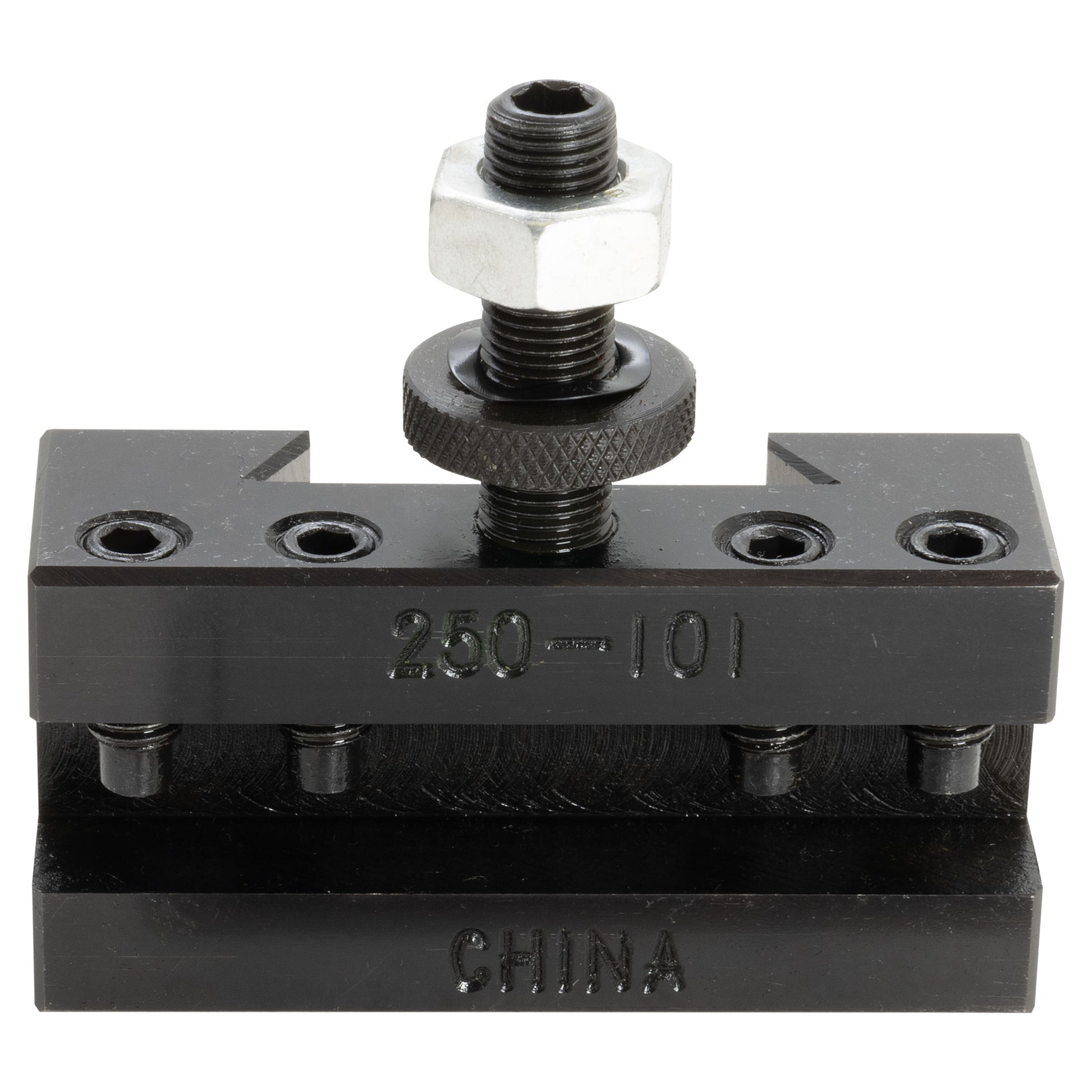

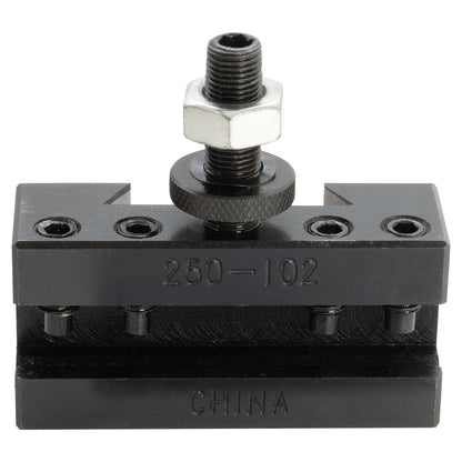

No. 1 - Turning & Facing Tool Holder
No. 2 - Boring, Turning & Facing Tool Holder

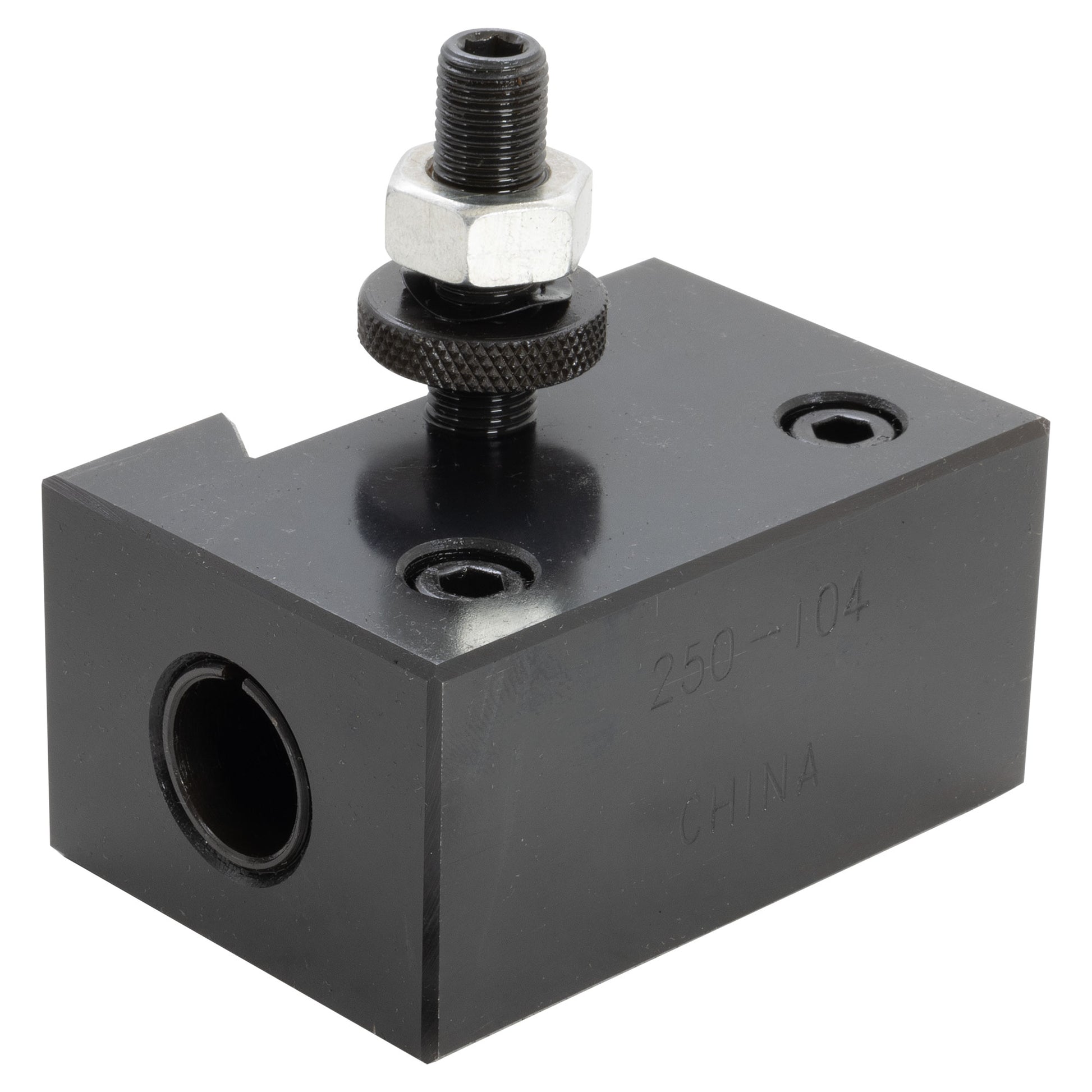

No. 4 - Heavy Duty Boring Tool Holder, will hold 5/8" or 3/4" round shanks.

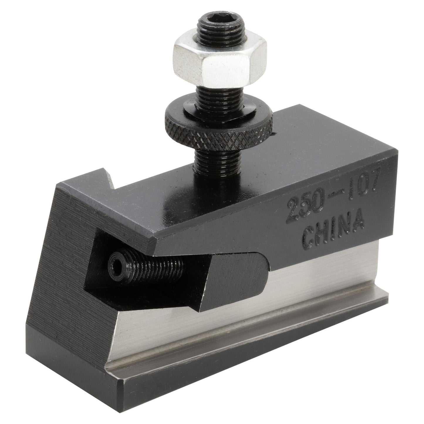

No. 7 - Universal Parting Blade Holder

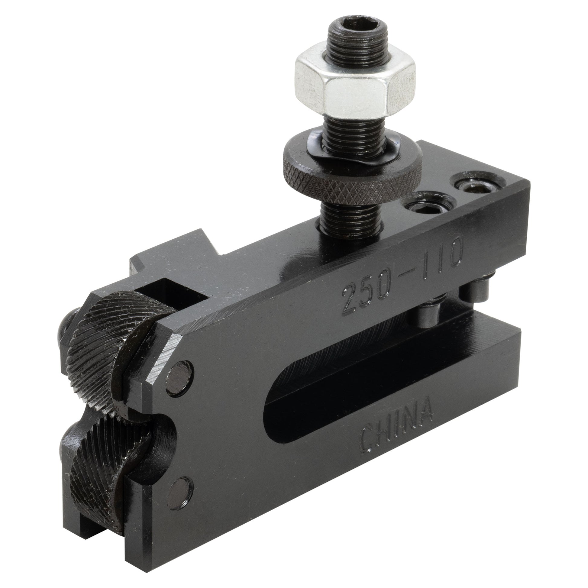

No.10 - Knurling, Facing & Turning.
This set includes a 9/16"-18 threaded stud and a piece of steel from which you can make a T-slot nut to fit your lathe. The tool holders interchange with Aloris, Dorian, and Phase II.
