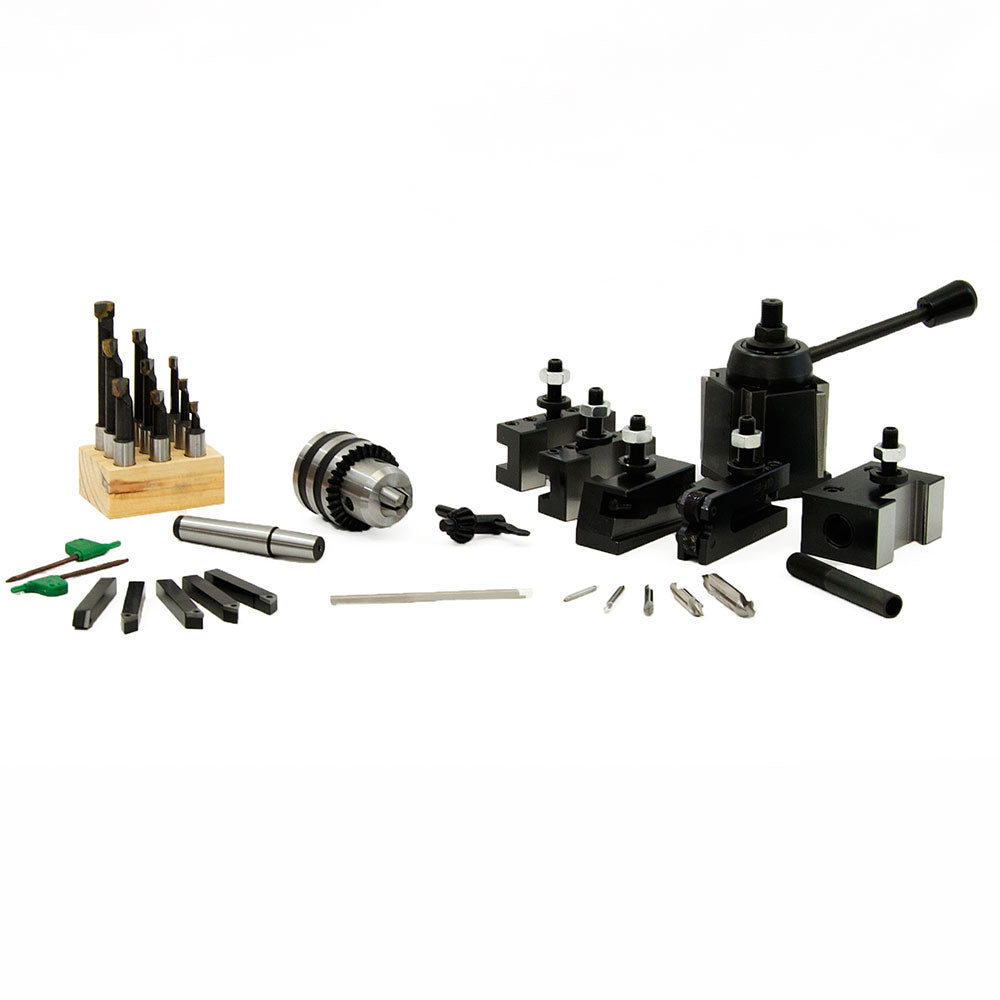

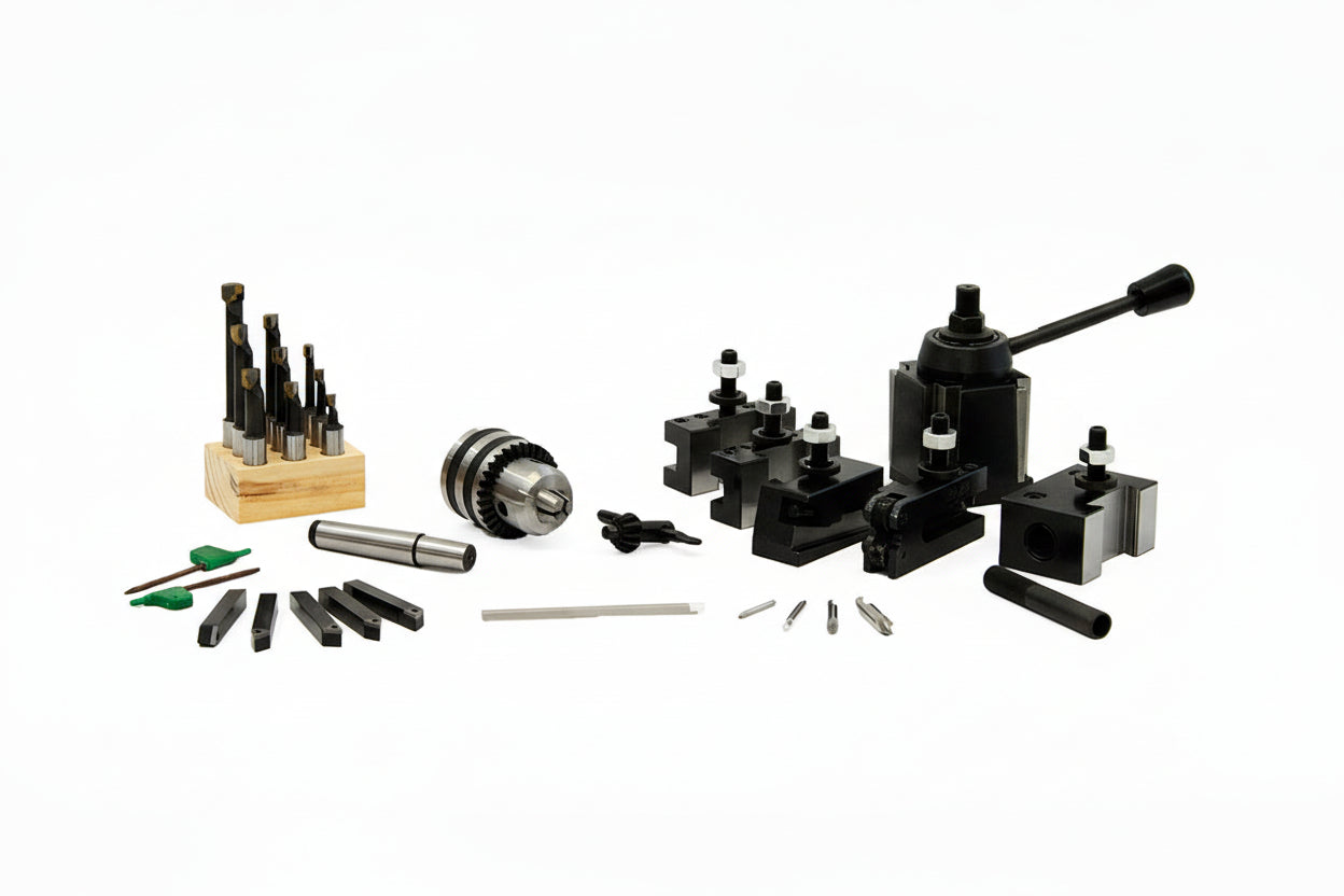

  • AXA (Series 100) QCTP Set with post mount for 9x20 Lathes
  • 3/8" Indexable TCMT Inserts, P1X Cut-Off Blade
  • 1/2" Drill Chuck, 2MT Standard to 33JT Drill Chuck Arbor
  • 9-piece carbide Boring Bar Set - 1/2" shank
  • 5 Center Drills (sizes 1-5)
This package contains all the tooling you need to be productive with your 9x20 lathe on the first day you own it.
***NOTE*** This kit includes a tool post mount that is internally threaded M8 to thread over the standard tool post mounting stud on a 9x19 or 9x20 lathe. It may require some work in order to make a T-slot nut, to mount this QCTP on your lathe.
Includes an AXA (Series 100) quick change tool post set (2280). This set includes the tool post and the following tool holders:
  • 2 - #1 Turning and Facing
  • 1 - #2 Boring, Turning and Facing
  • 1 - #4 Heavy Duty Boring will hold both 5/8 and 3/4 boring bars
  • 1 - #7 Universal Parting Blade (for 1/2-inch cut-off blade - horizontal)
The quick-change tool post is made from hardened steel. No tools are required to change tools. Additional tool holders are available.
The turning tool holders accept tools up to 1/2" shank. The turning and boring tool holder accepts boring bars with up to 1/2" round shanks. The cut-off tool holder holds 1/2" tall parting blades.
The 1/2" capacity drill chuck (1212) is mounted on a standard 2 Morse taper arbor (2955) . The rated capacity of the drill chuck is 1 mm (0.039") to 13 mm (0.512").
The set of indexable turning tools (1669) includes 5 tools (TAR, TAL, TBR, TBL, TE), inserts, a wrench, and extra screws. It comes in a wooden case. The carbide inserts are TCMT21.51.
The 9-piece carbide tipped boring bar set (1247) includes three different length boring bars each for minimum bores of 5/16", 3/8", and 7/16". The bore depth ranges from 3/4" to 2-1/4". Heat treated, alloy steel shanks.
The P1X parting blade (1552) is 5/64" x 1/2" x 4-1/2" and made from M2 HSS. These T-shape parting blades provide great side clearance.
This lathe tooling package includes 4 different sizes of combined drills and countersinks - Center Drills (2990). The HSS center drill set includes sizes 1, 2, 3, and 4. These are 60° center drills; the sizes that are most used by bench top machinists.
To complete the kit, a threaded stud (3712) designed to mount a quick change tool post to Grizzly, Harbor Freight, and Jet 9x20 lathes.
