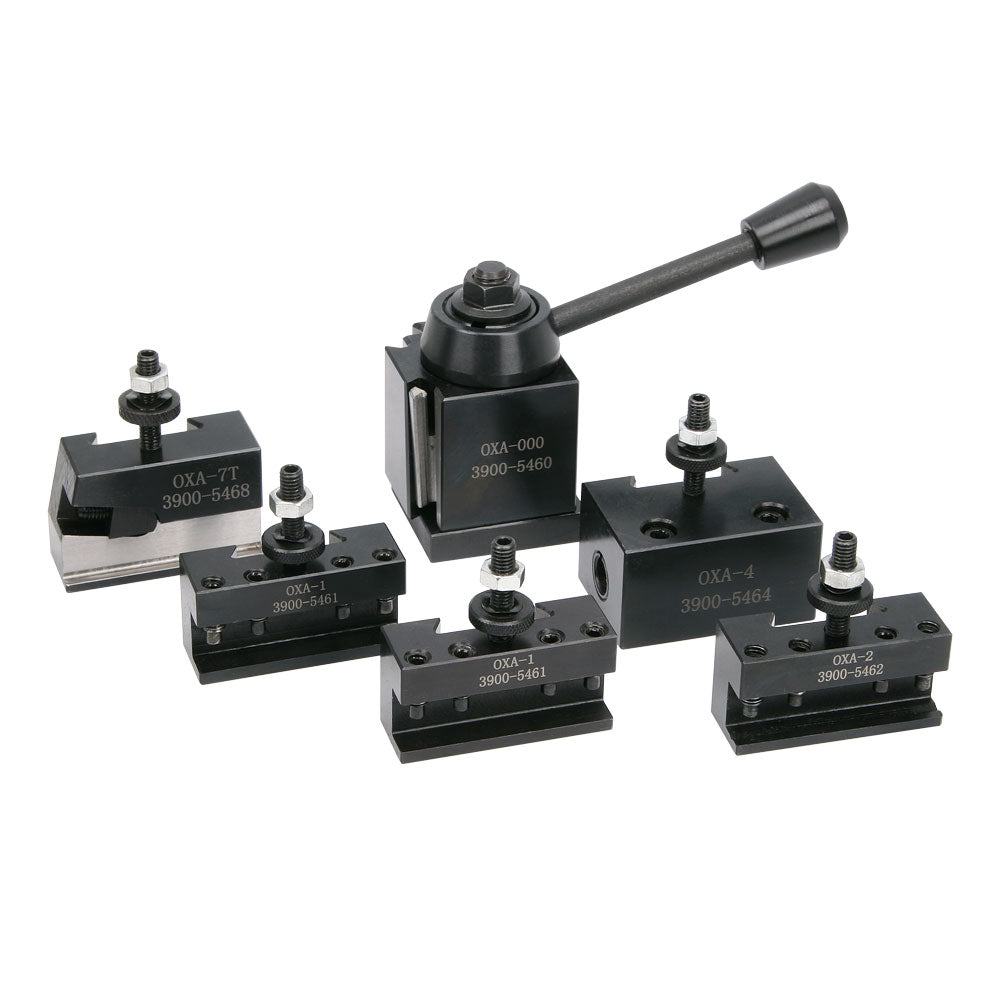

0XA or Series 000
The 0XA is the smallest of the three sizes. The body of the tool post is 1.75" square and 2.5" tall. This tool post is a good fit for lathes up to 8" swing. We carry two standard sets in this size.
PN 3112 has a cut-off tool holder that holds the cut-off blade horizontal. This allows the set to work with lathes with only 0.63" vertical distance from the top of the compound to the centerline of the lathe. This quick change tool post set bolts on to 7x10, 7x12, 7x14, and 7x16 mini lathes with no additional hardware.
PN 3048 has a cut-off tool holder that holds the cut-off blade at the standard 4° angle. This set requires 0.75" vertical distance from the top of the compound to the centerline of the lathe.
The only difference between the PN 3112 set and PN 3048 set is the cut-off tool holder; the tool posts are identical. The PN 3112 set includes the PN 3117 cut-off tool holder. The PN 3048 set includes the PN 3774 cut-off tool holder.
Our 0XA quick change too post sets that are configured for specific lathes include either the PN 3112 or the PN 3048. Besides the quick change tool post sets, these products include special mounting hardware.

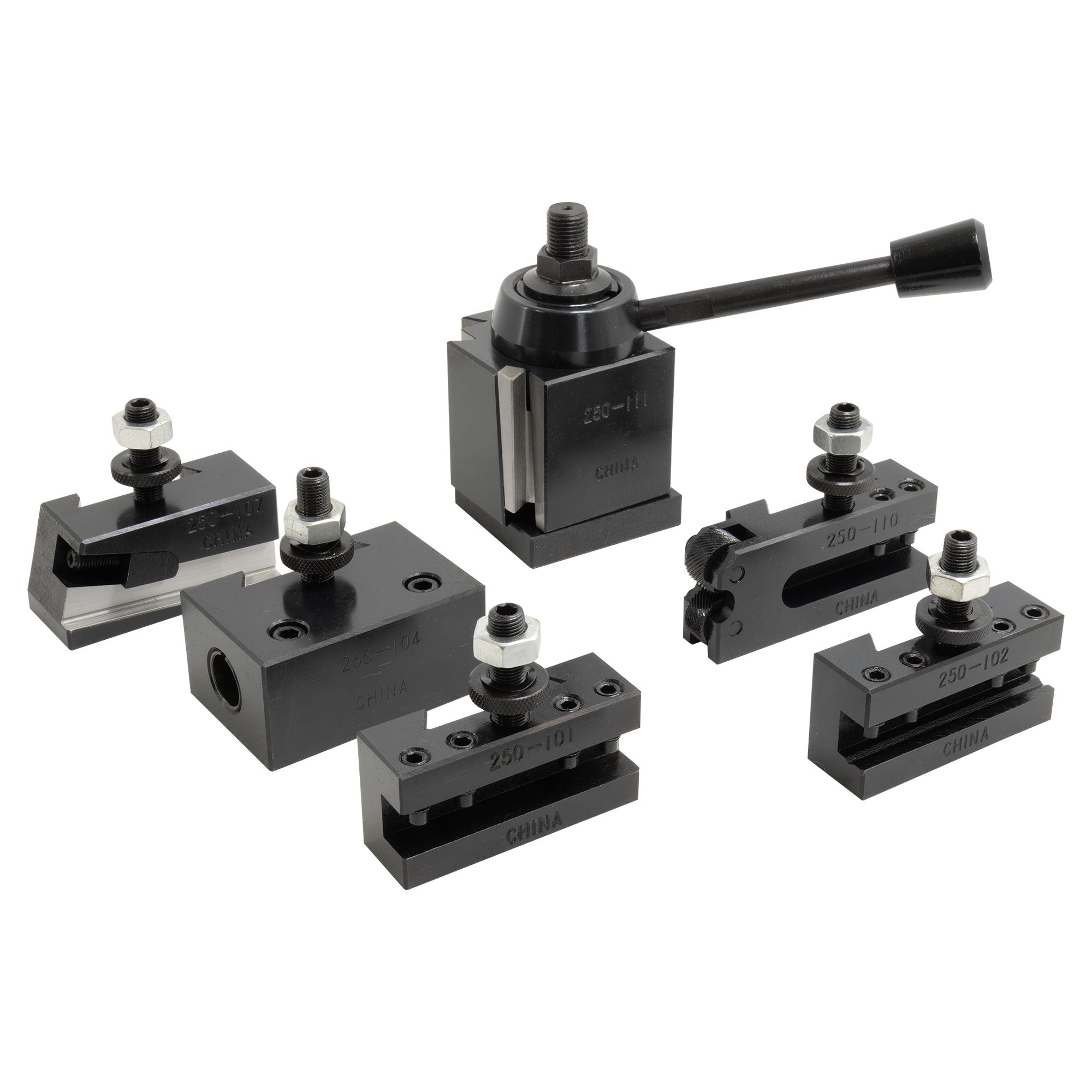

AXA or Series 100
The AXA quick change tool post is designed for lathes with swing from 7" to 12". We carry both the sets (PN 2280) and individual tool holders.
