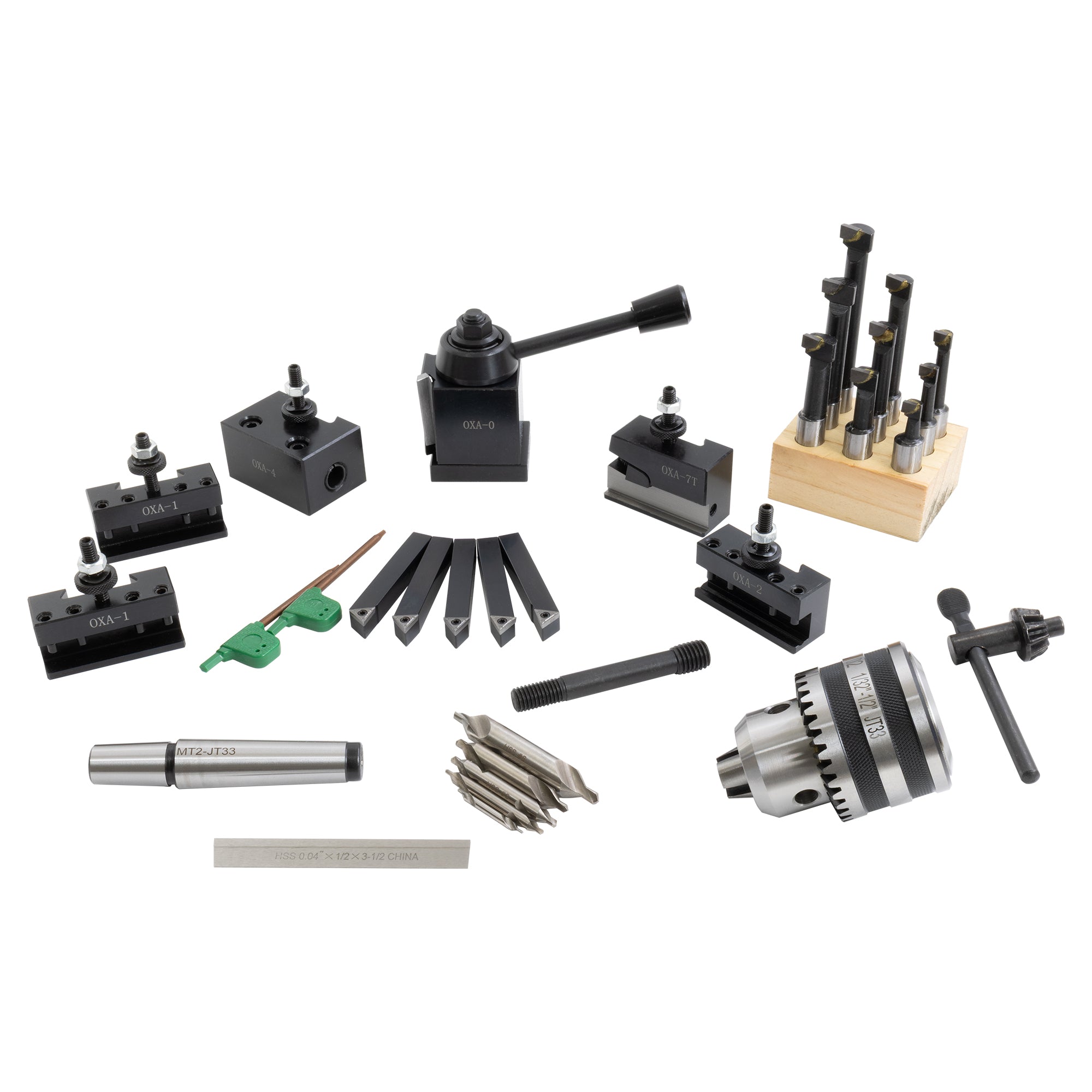

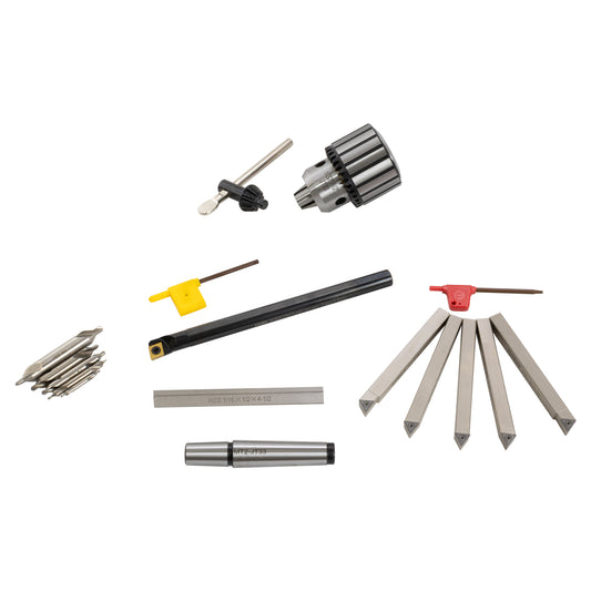

Tooling Packages
We suggest you choose one of the following tooling packages. We design our tooling packages to include everything you need to get started with a new machine. Tooling packages offer tremendous savings over buying individual items, and you know that every part of the tooling package will work with your new machine.

Bench Lathe Tooling Package, Premium + AXA QCTP
Vendor:Regular price $649.95Regular priceUnit price / perSale price $649.95 -
Mini Lathe Tooling Package, Premium
Vendor:Regular price $219.95Regular priceUnit price / perSale price $219.95 -
